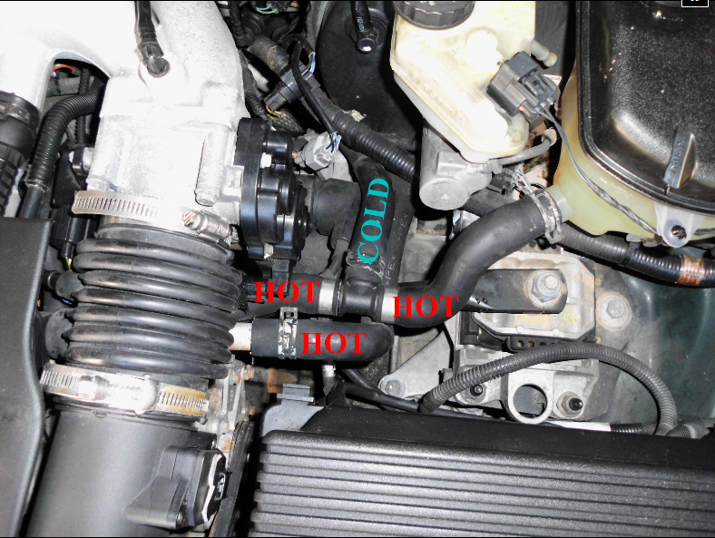

Jeramia: That last response re: a weak water pump was from Thermo, who is far more an expert than I.
In addition to a weak water pump, another possibility is a partial blockage in the heater core. This doesn't happen often, but can occur when green antifreeze (ethylene glycol) was mixed with orange antifreeze (Dexcool). The blend can form a gel.
To check for a partial blockage in your heater core, take a look at the hoses running to and from the heater core. Here's a picture, courtesy of PanamaJag, who, by the way, cleared a clog from his heater core in this thread:
https://www.jaguarforums.com/forum/x...s-cold-127794/
The line labeled HOT and close to the battery supplies the heater core. The line labeled COLD is the return from the heater core. Warm up the engine, keep it running, set the temperature in the passenger compartment to LO, and turn off blower. Carefully touch the hoses to & from the heater core. If both are hot and about the same temperature, then coolant is flowing through the heater core. If the return line is noticeably cooler then the supply line, then little to no coolant is flowing thru these lines, either due to a weak water pump or a plugged heater core.
PanamaJag disconnected these hoses and flushed a ~pound of junk out of his heater using a water hose. See the end of his thread for details.
