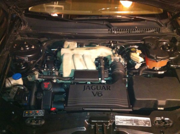

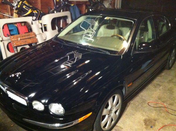

I was curious if I could get the opinions of some informed Jag owners on this vehicle I am looking in to. Here is the listing:
For sale 2005 Jaguar X-Type 3.0L V-6 AWD
I am selling my 2005 X-type it is in excellent condition with great exterior and interior.
Mechanically and physically the car is in mint condition, I am a car guy and have always kept this car in top spec.
Specs:
Transmission: 5 speed Automatic w/OD
Brakes: 4 Wheel DISC w/ ABS
Mileage:107k
Black Exterior with Chrome Trim
Tan Leather interior
Heated Seats
AM/FM/CD Player
Power Drives Seat
Power Sunroof (not moonroof, it opens fully)
All Wheel Drive (handles great in snow or wet)
3.0L V-6 (not the smaller 2.5)
Engine Immobilizer
Headlights-Automatic
Air Conditioning-Auto Climate Control
Auto-Dimming Rearview Mirror
Cruise Control
Keyless Entry
Power Mirrors
Power Locks
Seat-Power Driver
Seat-Power Passenger
Rear Armrest/cupholders
Steering Wheel-Adjustable
Steering Wheel-Audio Controls
Steering Wheel-Leather
Power Steering
Remote Trunk Release
Power Windows (Front 1-touch Up&Down)
Front and Rear Fog Lamps
Mirror(s)-Heated
Rear Window Defogger
Air Bag-Frontal-Driver
Air Bag-Frontal-Passenger
Air Bag-Side Body-Front
Air Bag-Side Head-Front
Air Bag-Side Head-Rear
As far as parts it has had the following:
New Heater core
New Drive Shaft
Transfer case replaced this cost $3000 and was done less than 2 weeks ago.
New front calipers
New rotors and pads all 4 wheels
New intake vacuum hosing (the stock hosing had a defect so i replaced all of them).
New Brake booster
New brake Master cylinder
Chrome mesh grill replacement (not the cheap kind I ordered specifically for this model)
All oil changes done with Castrol full synthetic as recommended by Jaguar
All regular maintenance completed on schedule including coolant flush, oil filters, air filters etc..
It has a crack in the front windshield that will need to be replaced at some point. I have driven with the crack for some time now as it doesn't impede the drivers view at all.
The left rear rim is missing the center for the hubcap, they can be found here for $20:
I also have a full size spare rim and full size spare tire which I will include with the car. The rim got bent on a pothole so I replaced it. It's still in good condition and you could have it repaired (about $50 locally) and use it as a full size spare instead of the donut (also included in trunk /w jack etc.). This was my plan i just never got around to it.
Other than that the car is in excellent condition it drives great, handles brilliantly in the dry or snow and it looks amazing.
Pics taken with cell phone, I can provide better hi-res photos if interested.
This is hands down the cleanest X-type you will find, its in better shape and has had more maintenance, care and new parts than cars with a third of the mileage.
Hate to sell her but I have a company car now and have no need for it.
Happy to answer any serious questions or inquiries, feel free to email me. Serious buyers are encouraged to come see the car in person, as the pictures really don't do it justice.
He is asking 7K.
To me it seems like a good deal as he has already replaced the Transfer case and some other parts and it seems well maintained.
Is there any other major(costly 3k+) components that are known issues with this model?
If anyone has any advice on things to look for or questions to ask I would love to hear them.
Thanks!

I would not pay more then 6k for the following:
(This car might have been driven hard)
I am selling my 2005 X-type it is in excellent condition with great exterior and interior. Has several maint issues.
Mechanically and physically the car is in mint condition, I am a car guy and have always kept this car in top spec. Not in MINT condition, parts replaced and windshield cracked!
Mileage:107k
New Heater core
New Drive Shaft
New front calipers
New Brake booster
Suspension Bushings might need replacing?
Shocks need replacing?
Timing chain?
Might want to have an Inspection prior to purchase!

Clark, while the X-Type is a nice car, I have to ask how you plan on driving it. I bet you are wondering why I ask this. As the post above said, the transfer case has been replaced. It is the weak link of this car. If you are looking to beef up the motor to get some more power out of it or you plan on driving it spiritedly (ie, routinely letting the car shift at above 4,000 RPM), you are going to find this is going to be an expensive car to own. If you are looking for one that will cruise at 70-75 mph in comfort and have a look that is not found in other cars, then this is the car for you.
Please keep in mind that this guy doesn't know the car all that well. A few things stick out at me. The first, he talks about driver's window being 1 touch up/down. Atleast on my 03, all 4 windows are 1 touch up/down. This was standard on the X-Type. Secondly, all the options that he lists are for a basic X-Type. he doens't mention NAV or other niceties that were options for the X-Type. The only "upgrade" I can see is that the car got the 3.0L motor over the 2.5L motor.
Now, the statement that makes me wonder the most is the one about " All oil changes done with Castrol full synthetic as recommended by Jaguar". I wold like to see where that is written. We have had numerous discussions about whether synthetic oil should even be used in these cars as all of the documention with Jaguar headers has specifically stated that use of conventional oil is recommended. Now, using full synthetic doesn't hurt these cars.
The price he is asking is a little high. Take a look on KBB and other pricing sites and see what a basic X-TYpe is going for in your area. I know near me, that price is too high. he is trying to recoup some of his money from the transfer case.
Am I saying not to buy the car, by no means. I have enjoyed the 5 years that I have owned my X-Type and see many years of trouble free use from it. But I also point out some of the not-so obvious errors that are in the posting.
