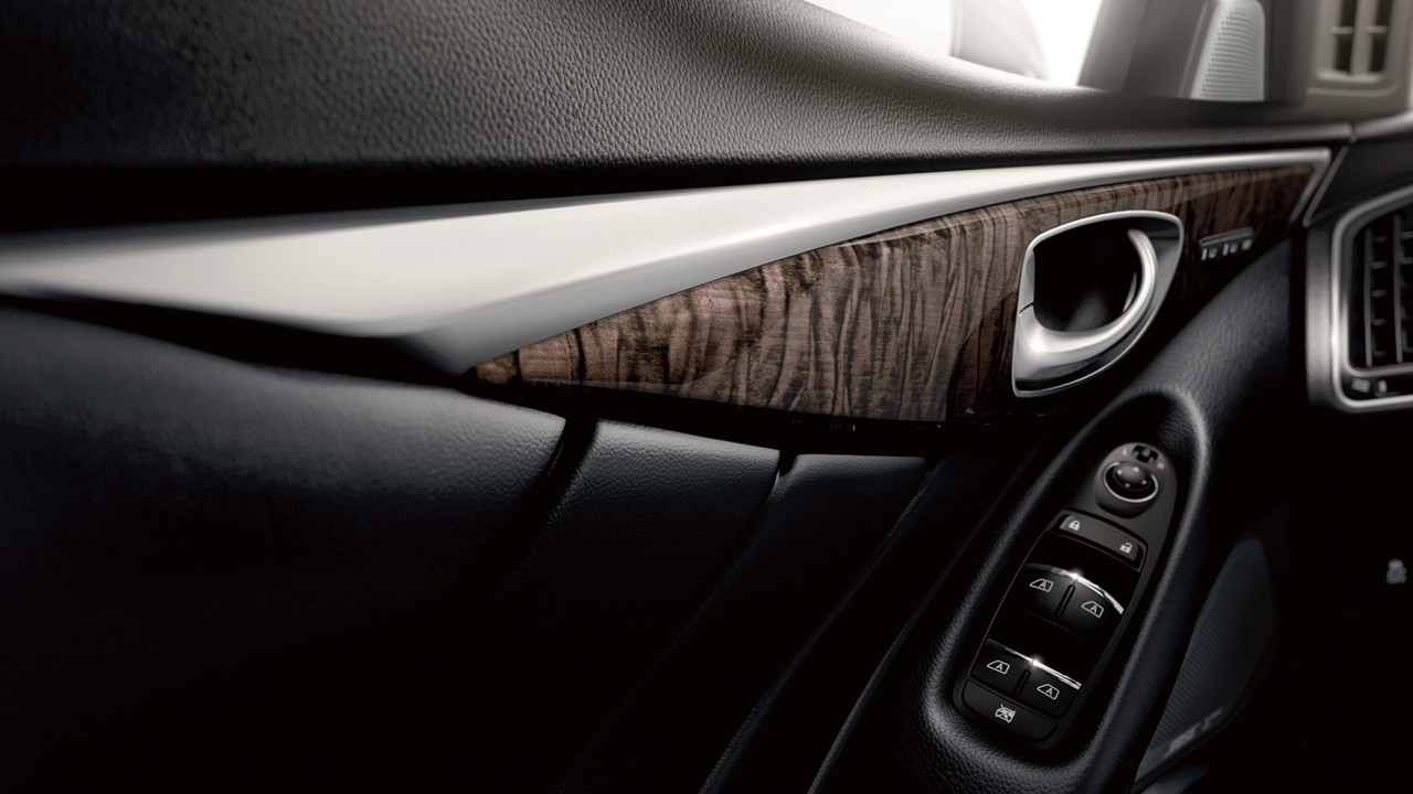

Hi new guy here.. That maybe my only real complaint with the car is the Very Poorly thought out windows and memory arrangement.. I find the two tier design confusing and un-nessary. There is no need for the memory presets to be so close at hand, right by the door pull. waiting to be hit.. And having the actual window switches up top and a reach away is dumb. Heres an Infiniti not plugging the car but the ergonomics much better. IMO
