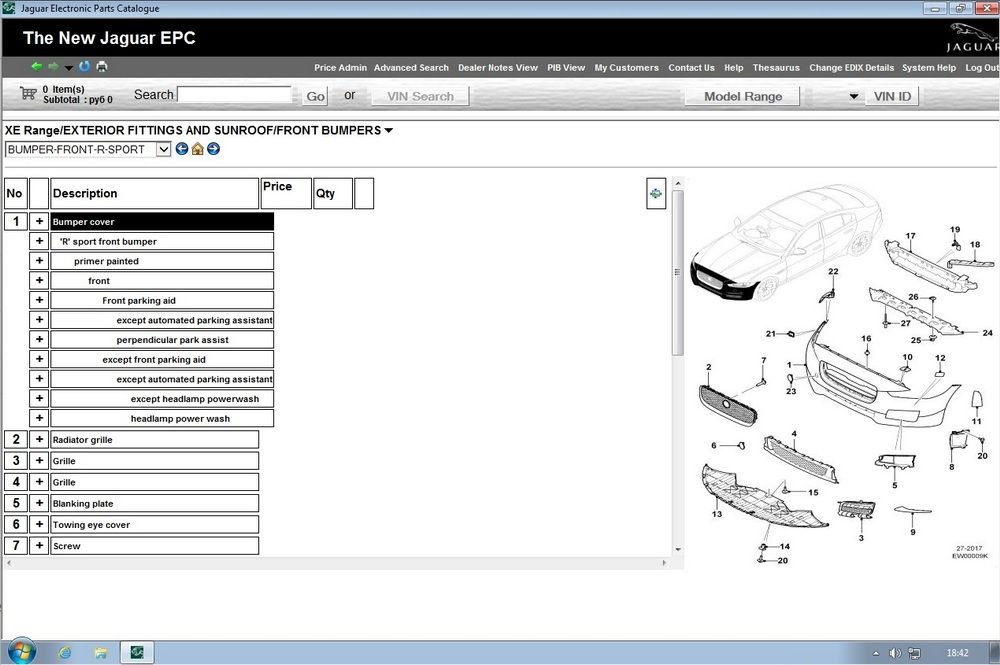

Ho una Jaguar xe del 2017 r sport con cui purtroppo ho fatto un brutto incidente, devo cambiare la musata anteriore non riesco a trovarla del mio modello, ho trovato una musata del 2019 modello successivo, qualcuno mi sa aiutare a capire se si puņ montare sul mio modello?
I have a 2017 Jaguar XE R Sport with which unfortunately I had a bad accident, I have to change the front end I can't find one for my model, I found a 2019 model, can someone help me understand if it can be mounted on the my model?

The later 2019 Model Year should fit your 2017 Model Year BUT there are different front bumpers for with/without Front Parking Aid and with/without Headlamp Power Wash.
Be sure to find one with exactly the same specification as your 2017.
