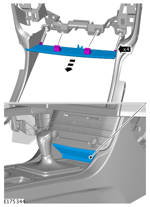

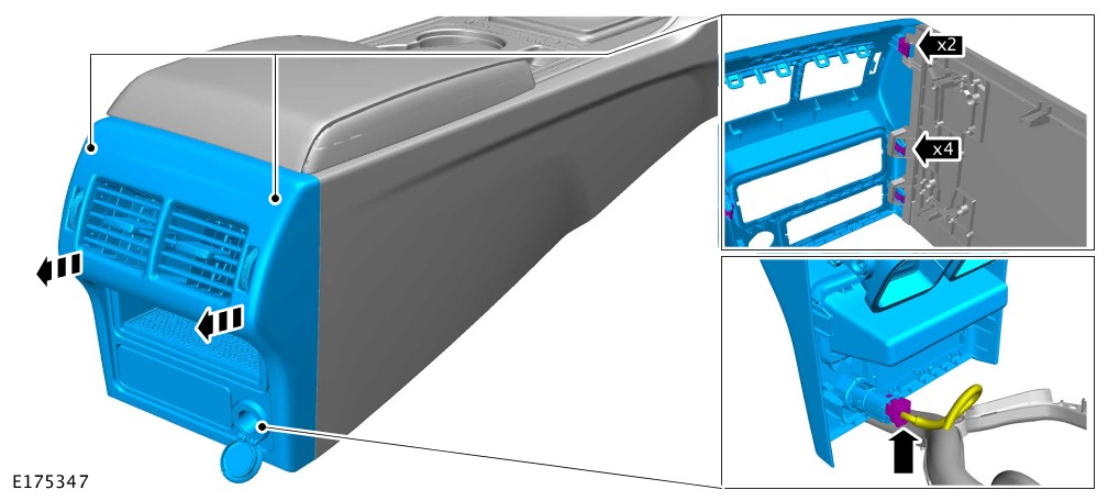

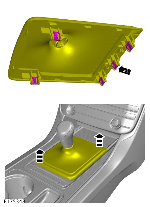

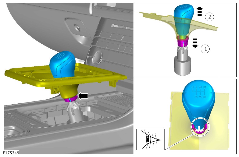

I purchased a manual for the XE. It includes models from 2015-2020. Manual trans is pictured.

I will be getting a wireless phone charger (and interior trim tools) for Christmas. I will try and do a DIY with pictures based on my experience. The unit looks real good and has what I would call an adapter cable. The installation instructions are non-existent, but I had purchased the workshop manual for the XE so I am hopeful.
