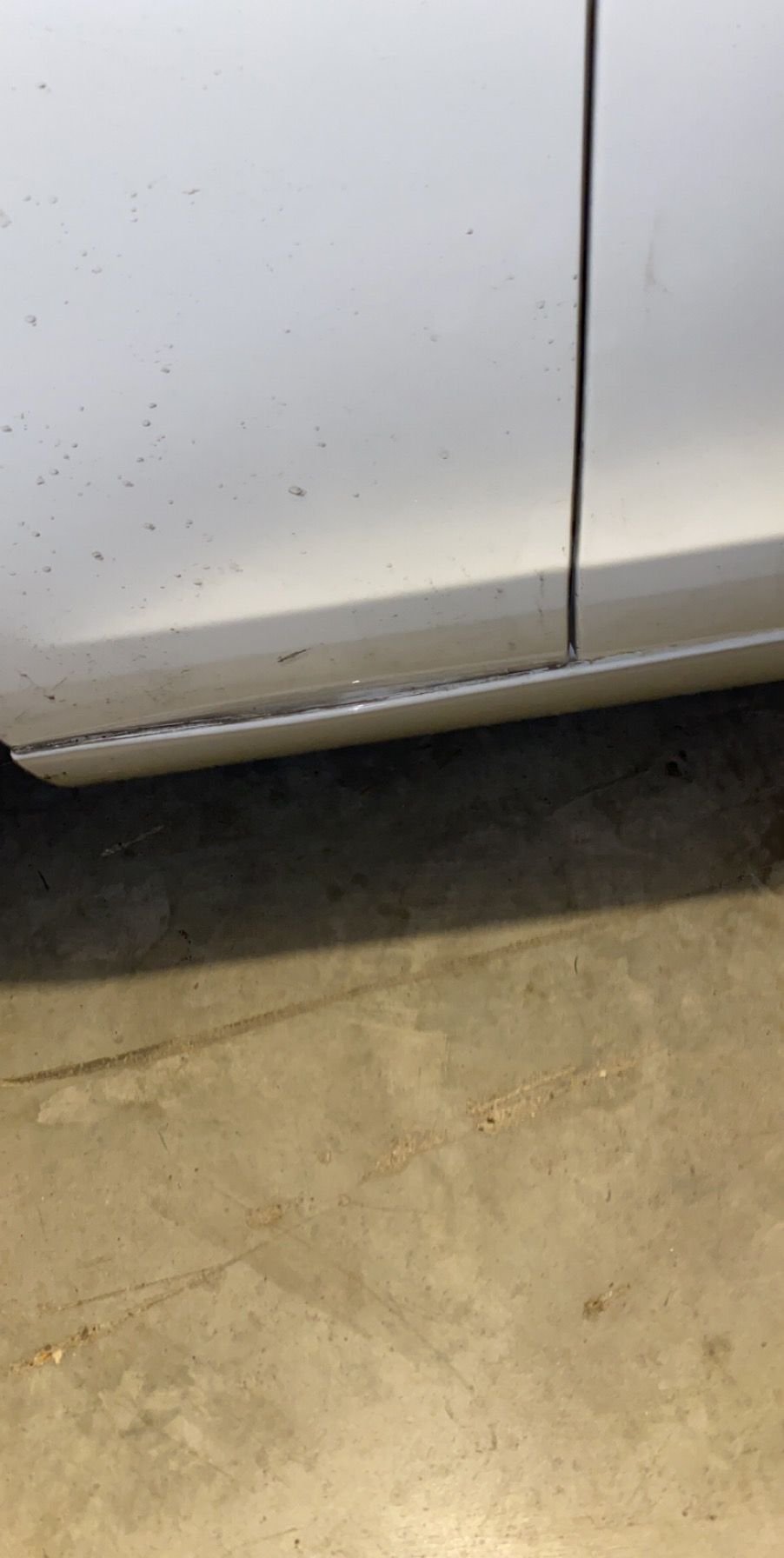

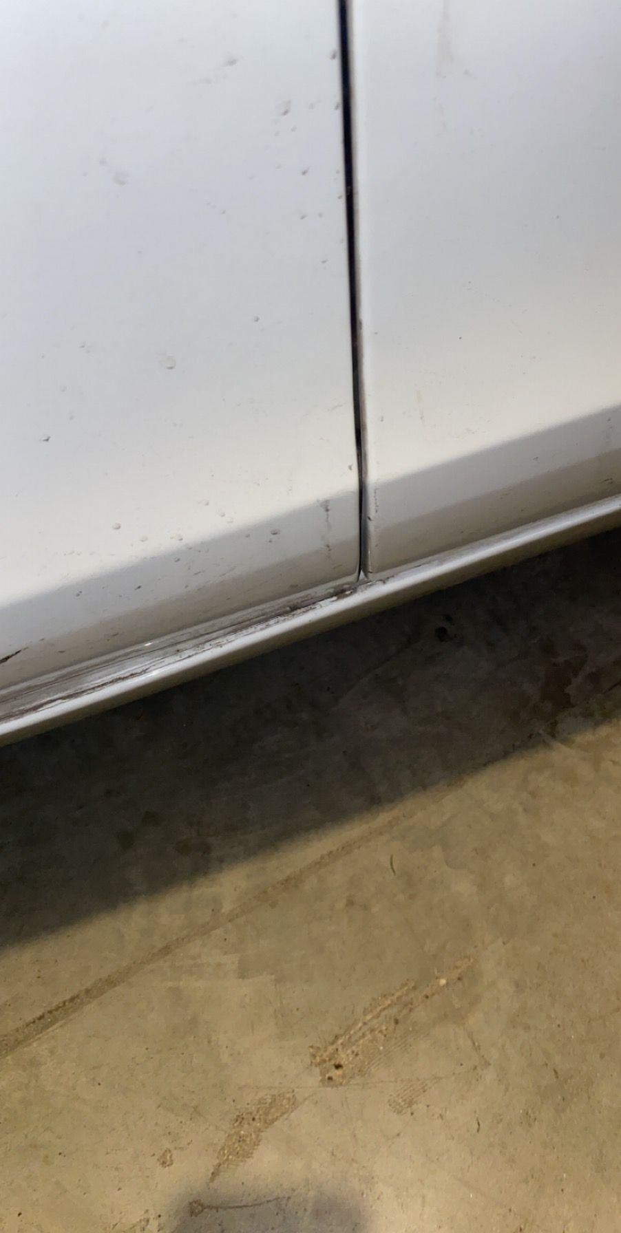

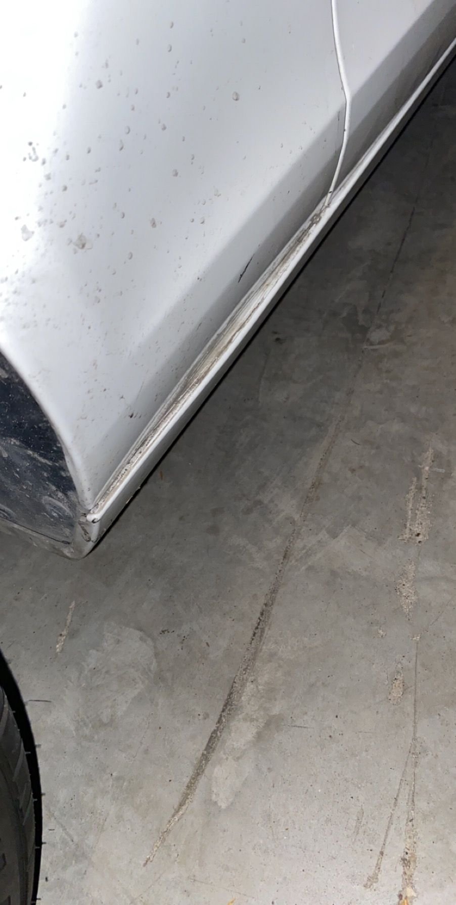

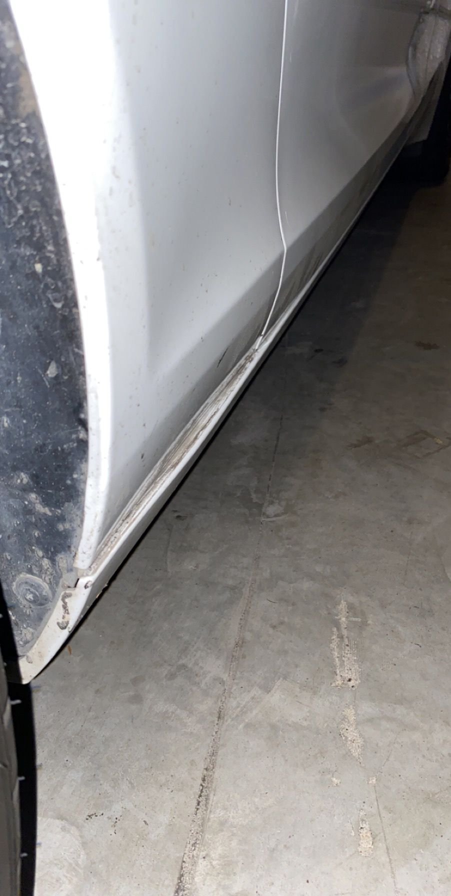

Earlier I noticed this small gap on the under part of the body moulding/side skirt area of my driver side. I have a 2016 Jaguar XF Prestige 35t and wanted to see if anyone was familiar with how to get it even again. Tried without success to push/pop it back into place. Any tips help, pics included!

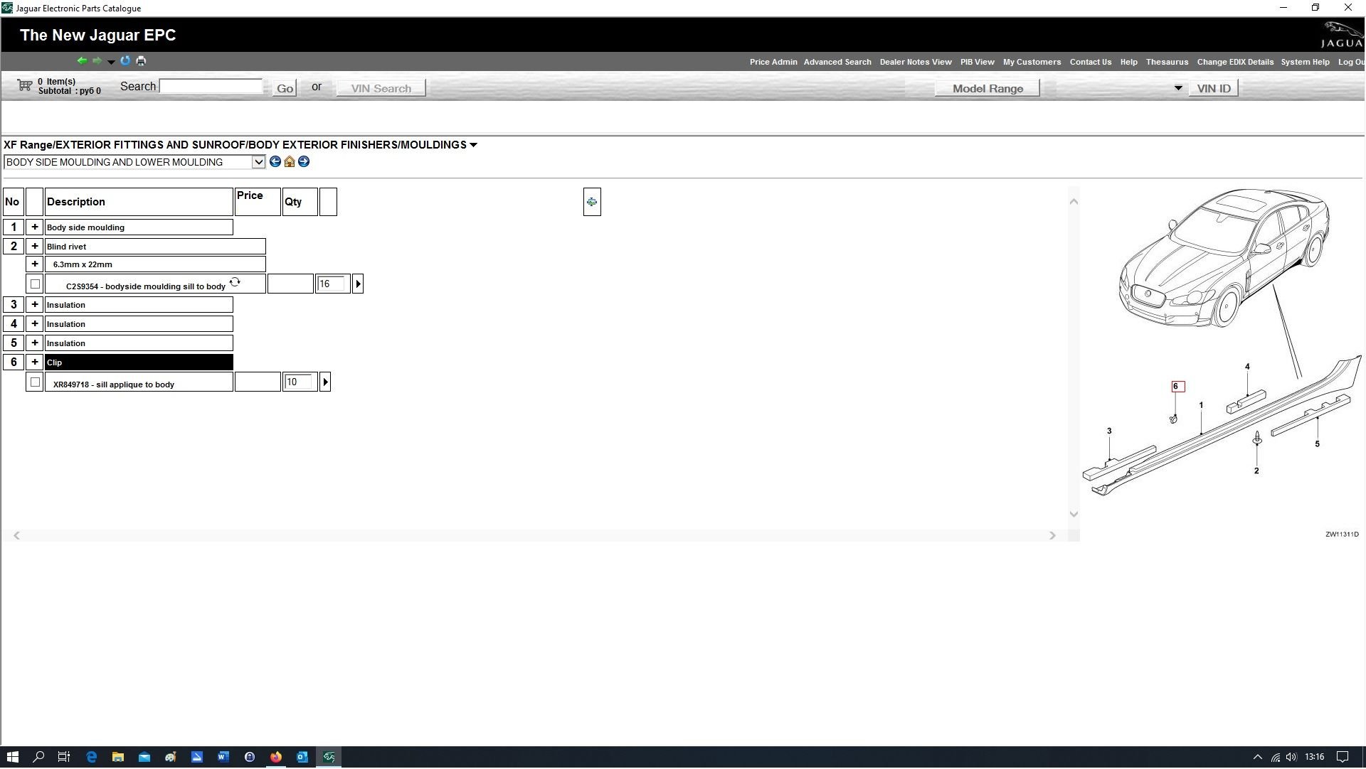

The Parts Catalogue shows it is secured with a combination of blind rivets and clips.
From the quantities listed, there's 8 rivets and 5 clips on each side. Looks like some of the rivets could have failed.
