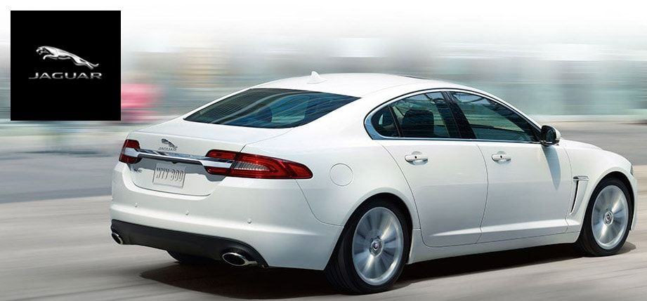

I didn't noticed your Jag is a 2015 model. There are 2 models from 2015
Which one is your XF?
If your XF looked like on the first picture, this is an XF 250 Repost your original post to this forum and the members there will help you: https://www.jaguarforums.com/forum/xf-xfr-x250-44/
If your XF is the same as pictured below, then it is an XF 260. Try to reboot the system by disconnecting the negative/ground cable of the battery. Wait for 5 minutes and reconnect the negative/ground cable. Make sure both + and - cables are bolted tight. Now, press the lock and unlock botton on the fey fob. Do this twice. Does the car respond to the command? How old is the car's battery? Current voltage? Press the horn, is it loud or you hear just a click or one horn only ( XF have dual horns)?
