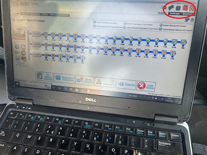

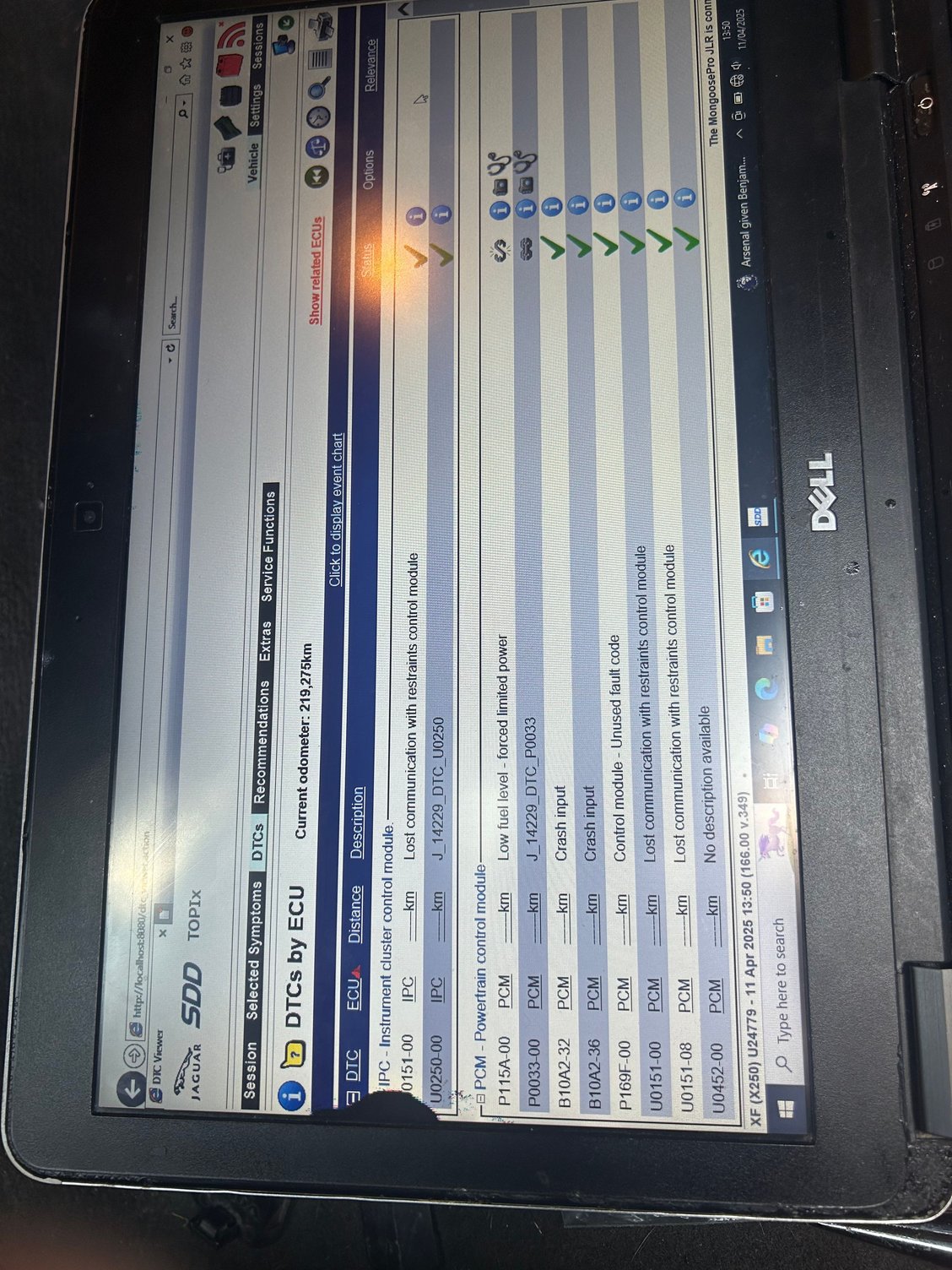

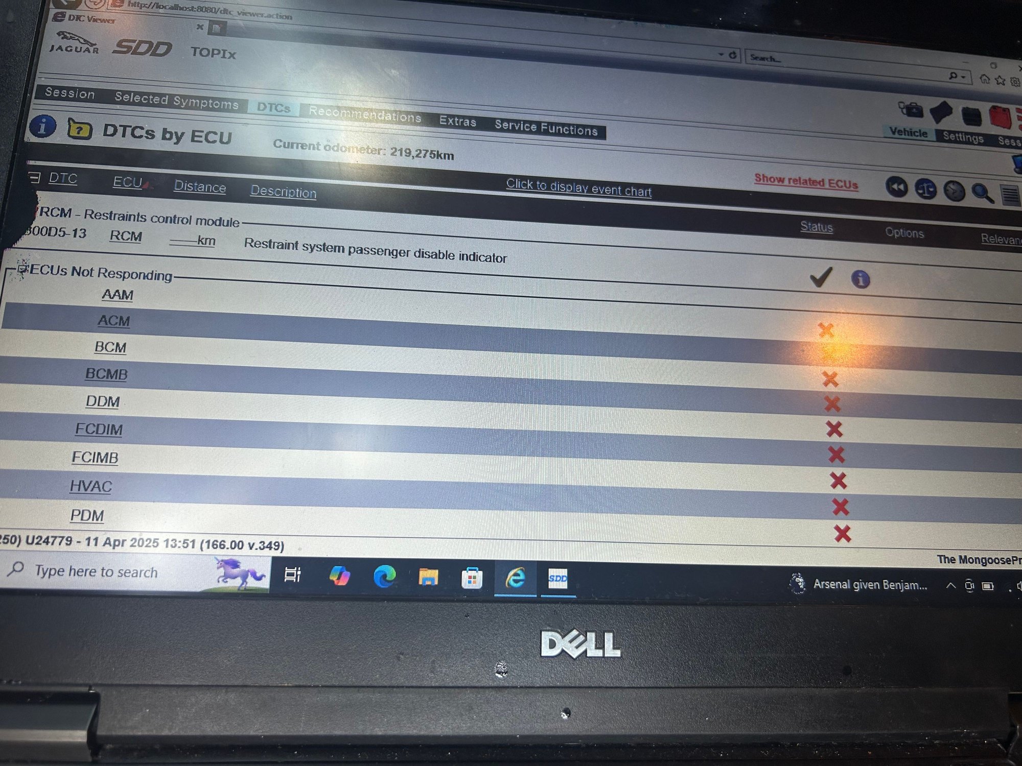

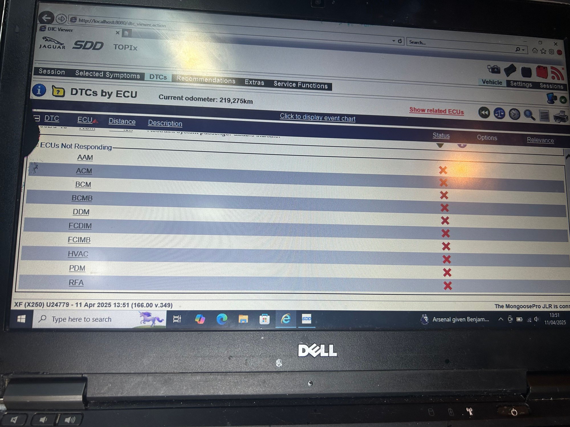

Hi I’m back again I’ve managed to green tick some faults but just having trouble with some of these ECU’s not responding everything works as it should which is a bit confusing
any help would be appreciated I did try and upload a video of the car running with no fault lights or anything on the dash.

Do not operate SDD with that battery symbol red!! That indicates too low a voltage. Get the proper DC power supply (NOT a battery charger!) on the car whenever your using SDD.
That may not be causing your current problem but you need to fix that.

Yeah, it was all green before I turned the power supplier off and I remember to take the picture I did try and post the video of the car running so it wouldn’t let me there’s no warning lights on the dash

Shut down sdd, turn off ignition and let car sit for 10-15 mins, than come back connect sdd and start a new session and scan the jaguar, the red Xed modules should be green.
