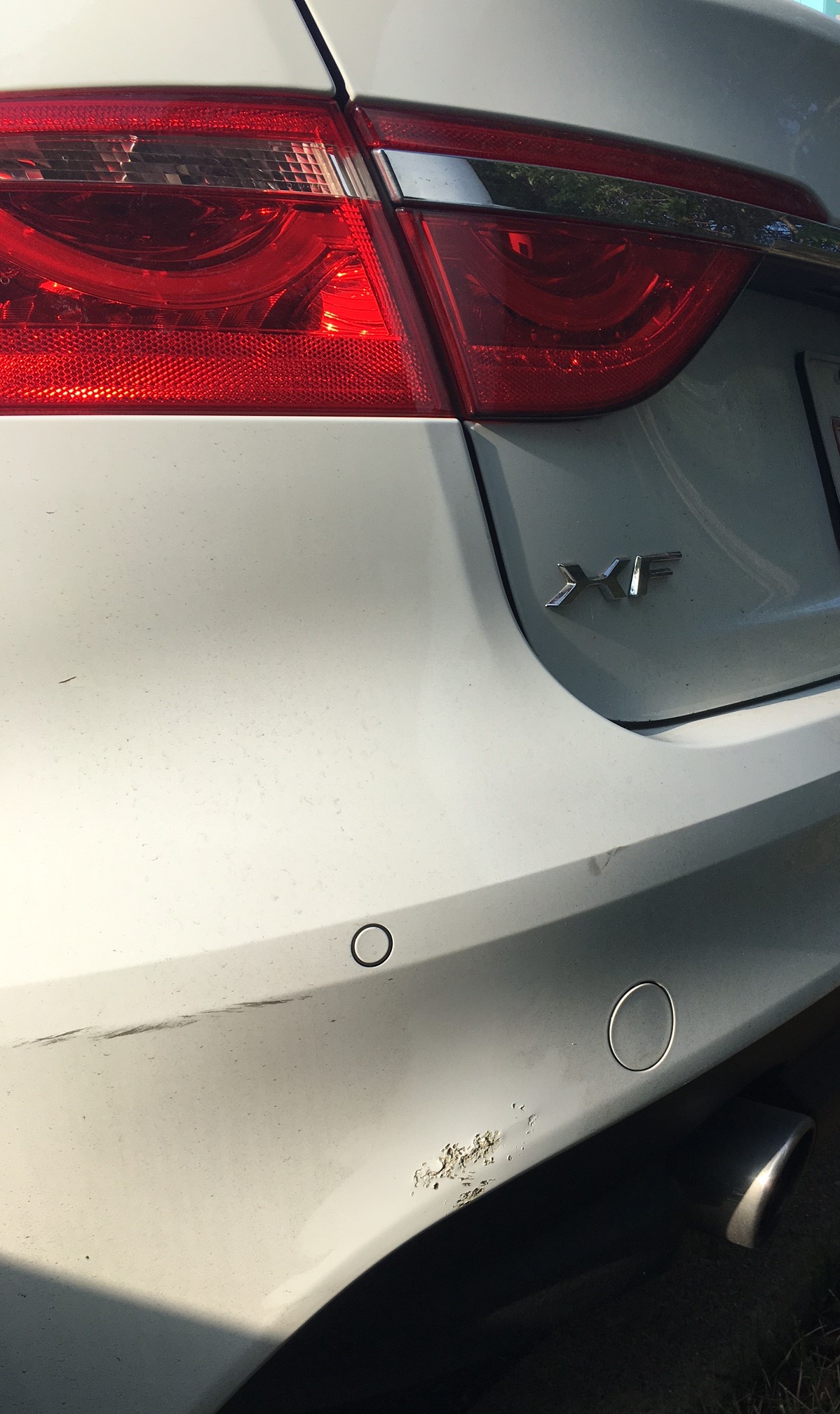

Question Rear Bump Scratch Fix
Hi,
Accidentally backup and hit my car on a lamp post.
My heart is broken than the car.
Any ideas to fix this?

For the light marks near the sensor, get a DA polisher from Harbor Freight https://www.harborfreight.com/6-in-5...her-69924.html and some polishing compound http://www.cleanyourcar.co.uk/images...teCompound.jpg
and polish it out.
For the deeper mark near the exhaust tip, you might have to gently sand it down and use some matching color spray paint to give it a light touch up. Once the paint is dry you can put some clear over it and use the DA polisher to blend it all in.

^^^^ what he said ^^^ but that's too small an area and on a body crease so by hand would be better.

I wonder if the touch up paint from Jaguar might be enough although if you are spraying it then I don't know about that.
