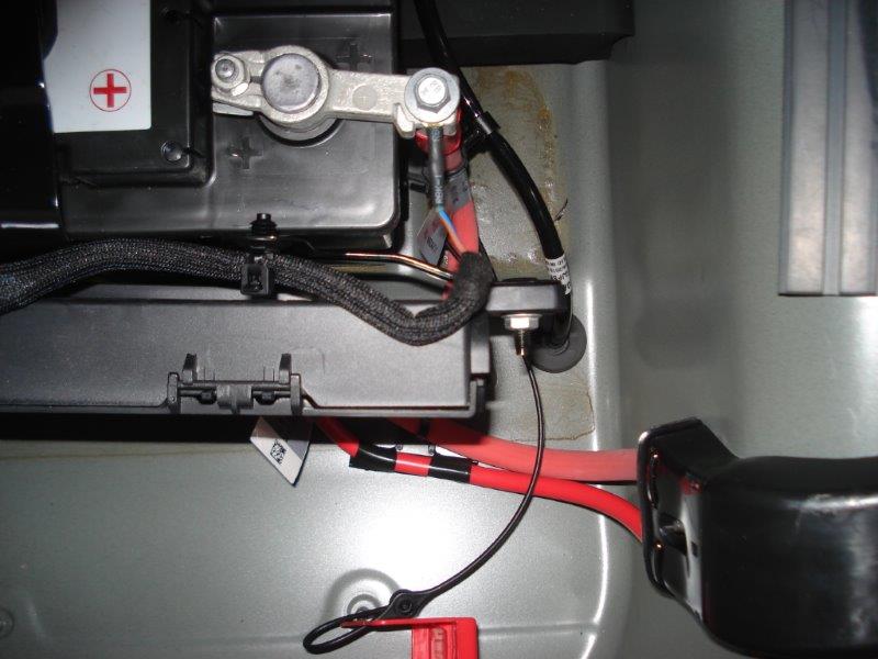

Is the wire you are referring to the wire under the bolt to the right of the battery post? It's an orange and blue wire with black heat shrink covering the connector lead. If that's it I bet it had nothing to do with a battery tender but more likely done on purpose for another reason. Didn't I read in another post where they upgraded your software? If that's the wire one should be careful removing it as it connects the +12 Volts to the entire system. If that's the one I will run a jump lead to the other end of the huge red cable the bolt is holding to the post clamp and the post clamp after waiting 15 minutes from when the trunk was opened to ensure the system has stabilized to holding voltage (after any electricity is used....like opening the door or even touching the door handle).

Your battery terminal looks different than mine. Mine has TWO posts on the battery terminals and the wire is small gauge, I would guess about 18-20 or so. Yours appears to have only the one wire so I have no idea how yours is set up.
Strangely enough I also did not have the red tag on the plastic tie before and now I do. The wire that is now connected to the battery lug was loose on that screw below that has nothing on it. I am relatively sure the dealer showroom tech MAY have disconnected that wire to avoid stop-start as in the showroom every time someone sat in the car and turned the ignition on it had the potential to start.
The one in your pics is the one to disconnect. Simply disconnect it (Use a socket wrench and be careful not to move the main battery post) and simply tuck it away. No more start-stop! Note that the main battery lead is below, so the small wire does nothing but engage or disengage the start-stop. Mine has been off again for awhile and nothing changed. Software updates still intact. Merry Christmas!
