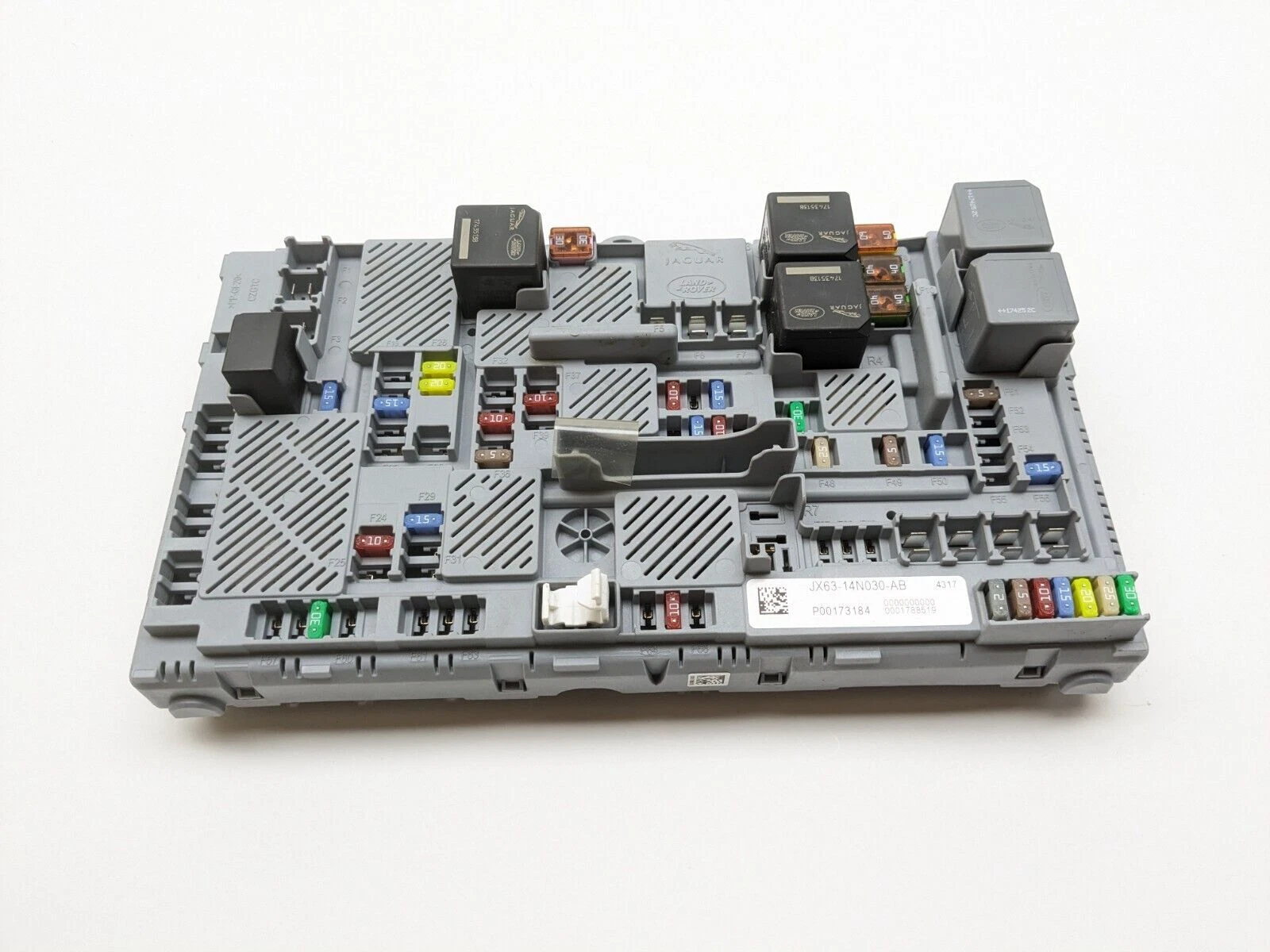

Afraid not, it says rear right in that article. Britcar shows the part looking like this: https://britcar.com/product.php/2754...e_2018_onwards
But I don't actually think this part is present in the 2018 XF Sportbrake as other sites show it looking like this:
https://parts.harperjaguar.com/oem-p...bC12Ni1nYXM%3D
Which appears to resemble this and goes by part number JX63-14N030-AB:
https://i.ebayimg.com/images/g/dF4AA...9/s-l1600.webp
Which I can actually find on the vehicle but I don't know if this is the QCCM?
What's strange is the part number C2D23644 seems to have two different images associated with it as I've linked above.
Any techies able to clarify?

Had to call a dealer. They confirmed that the QCCM is the large fusebox in the boot on the right-hand-side on a Sportbrake P/N T2H34607 / JX63-14N030-AB
Relevant diagnostics - B1412-96
