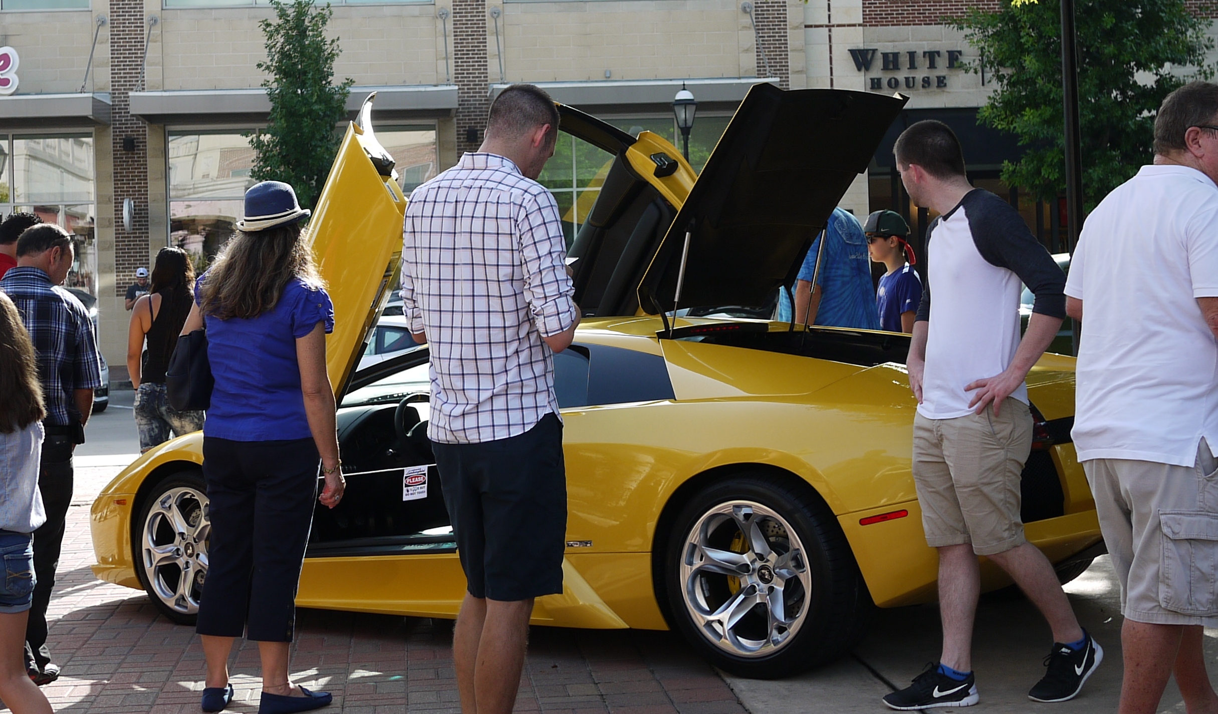

You mean in the Murcielago? That's not until Coffee & Cars tomorrow.

That's a cute Fiero you got there.

LOL Hotrody! If you think that's a Fiero, that explains why you would think those XK wheels look good on your XF!
You should roll the dice again.
