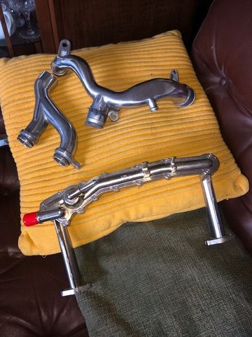

Once found replace with the most up to date part revision, or in Alloy. As D. Black states
e.g.
Top: the front Alloy pipes, which requires the Supercharger removing to replace the lower pipe. Bottom: The rear heater manifold in Alloy.

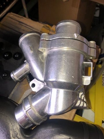

Alloy Thermostat Housing. The plastic one is OK too. But the seal is questionable!
There are more bits to replace. But do not want to depress you too much.

The top two options failed on mine in under 36K!
Happy hunting.
When replacing the plastic water outlet with the aluminium version, it's best to use the OEM o-rings instead of the ones supplied with the new parts.
Also, check the heater pipe that goes between the cylinder heads as some of the aluminium versions appear to have restricted passageways.
