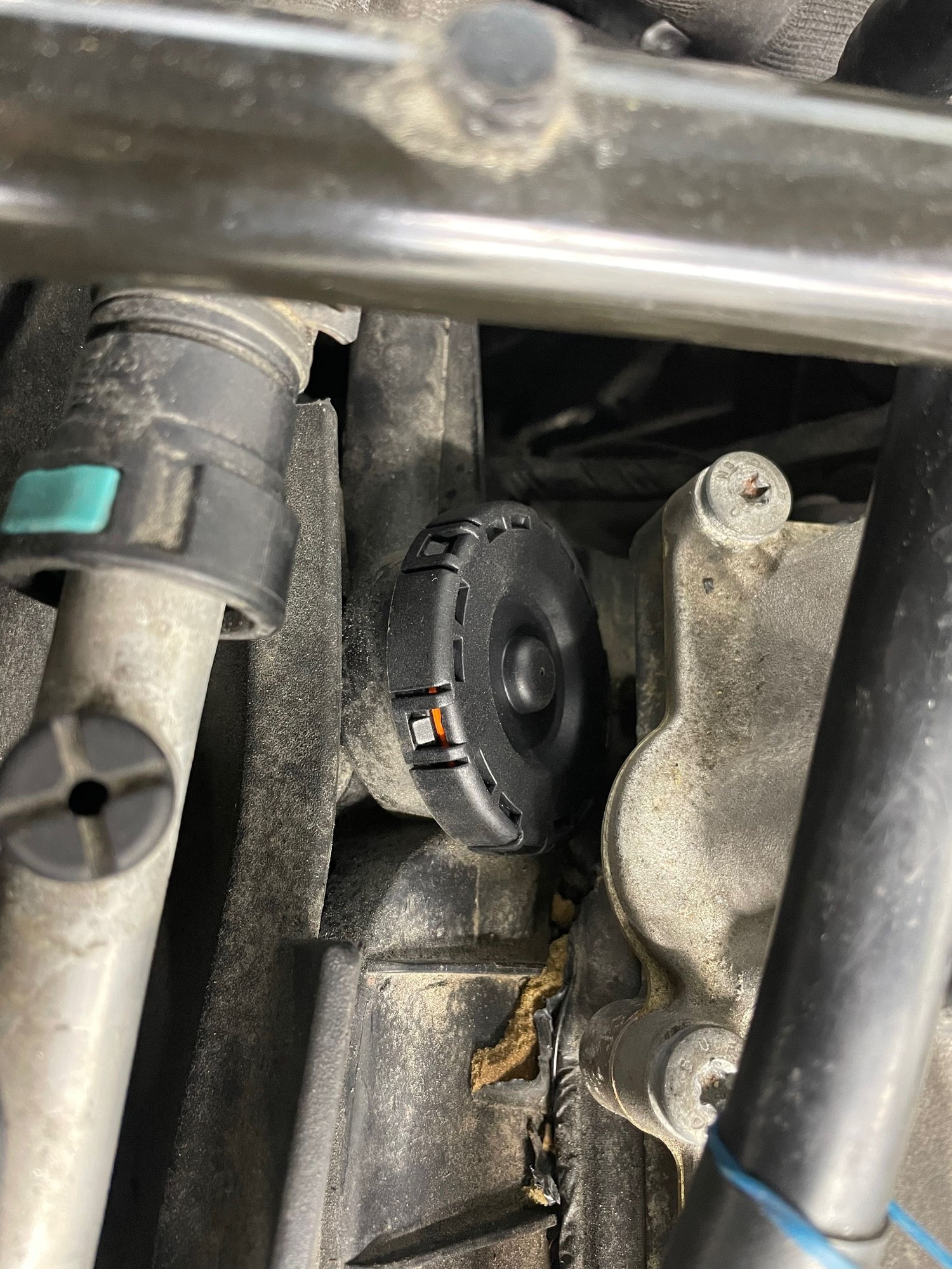

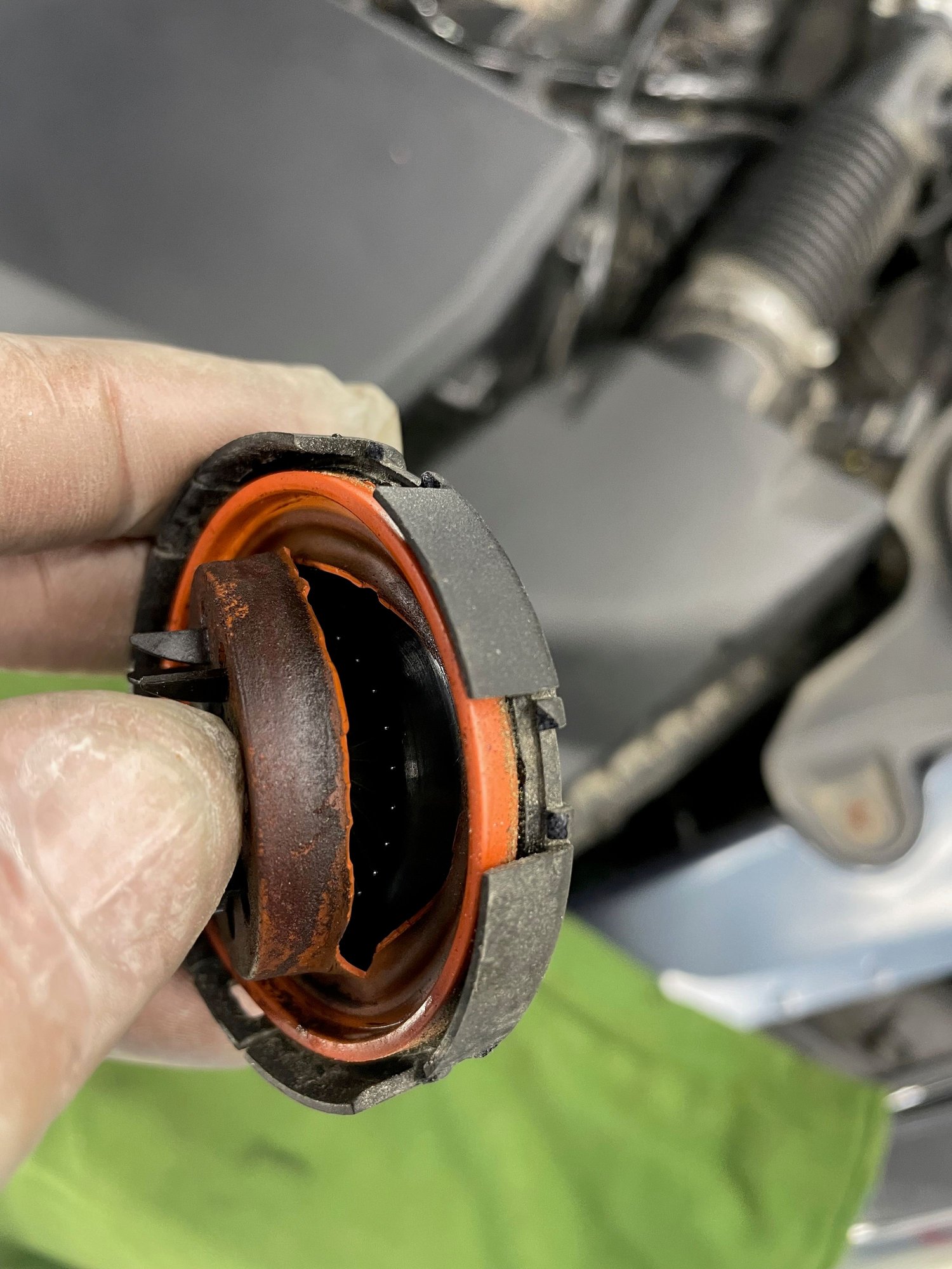

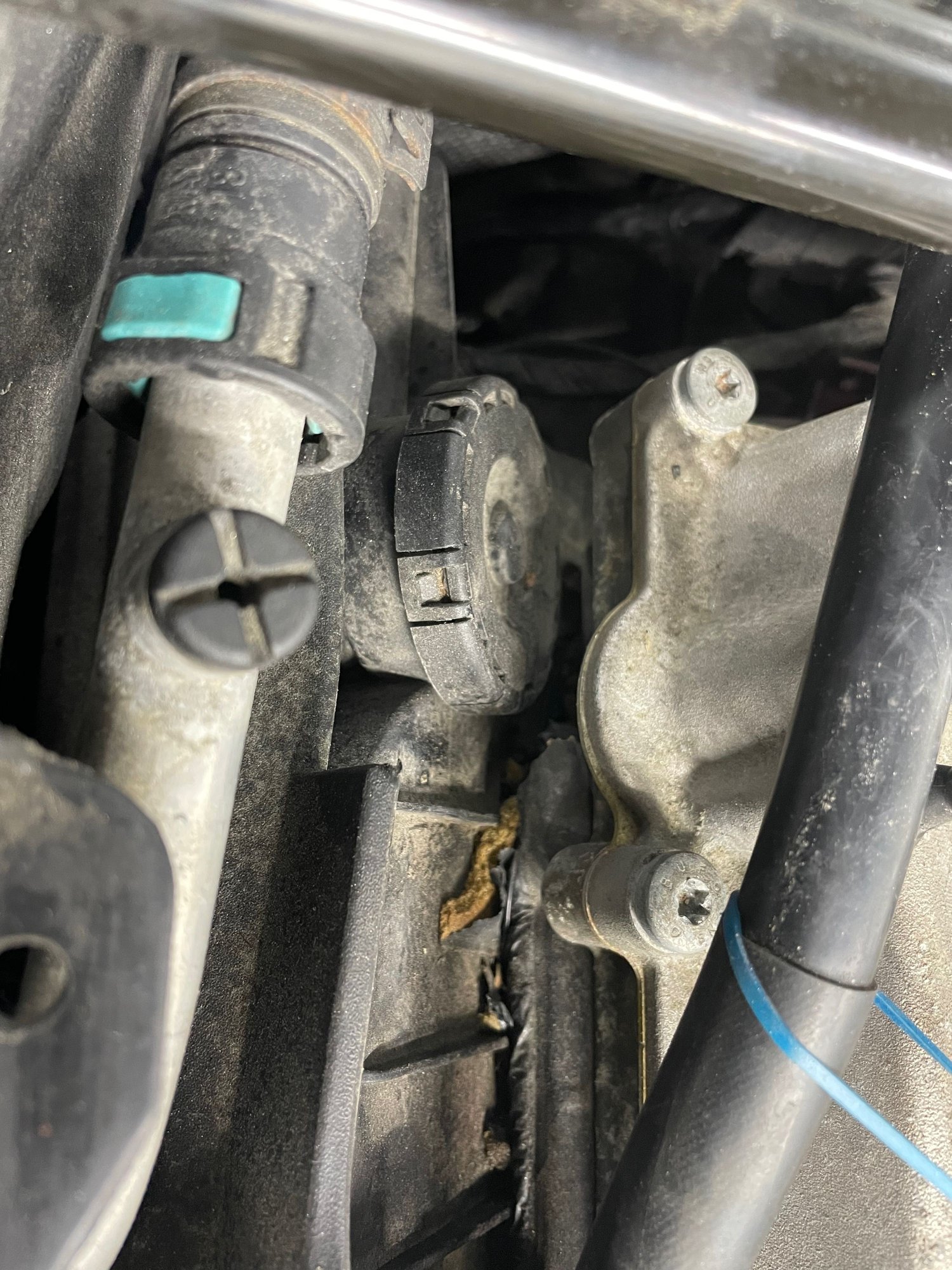

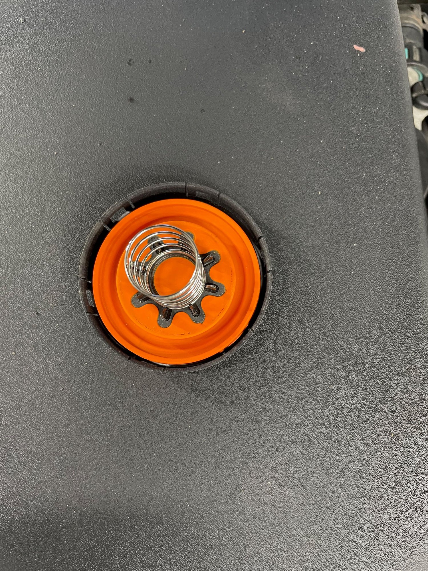

I have been chasing codes P2187 & P2189 for awhile. Today I replaced the PCV cap, spring and membrane
Old PCV with hoses and covers removed
Tear is clear
Complete part set: cap, membrane & spring
New PCV installed and running fine.
The codes have not returned with both long term banks reporting near 0% now. Problem resolved. Here are some photos showing the process. Once the hoses and related covers are removed it is a simple process.
