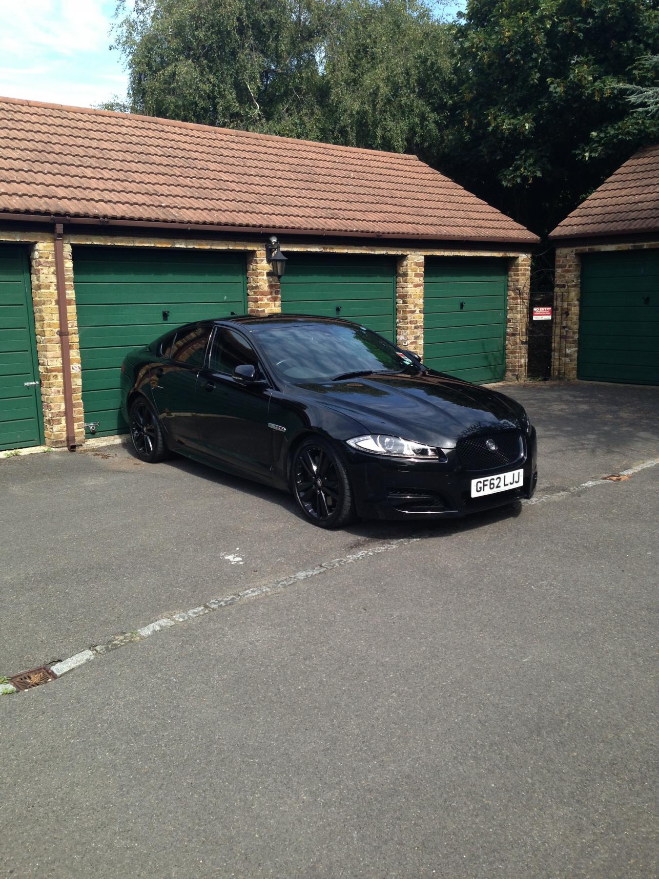

Now, this time I have managed to get some pictures uploaded. I introduce Brutus, Jagurus Naughtius Maximus!!

Nice car but I was hoping to see the wheel damage?

jag say the slight parking scuff (my bad...) is clear evidence of a significant impact that caused the damage to the inner rim.
They are all bent like this. I suspect a problem with the wheels, as I'm a careful driver, and I normally have my child in the car with me. I know for a fact that I have not hit anything except for one pot hole, at low speed, and I just don't see how that could have damaged all 4 wheels.
Anyway, it's been resolved now, not to my complete satisfaction, but it's a compromise.
