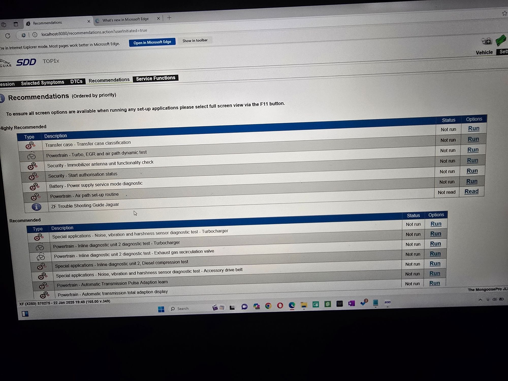

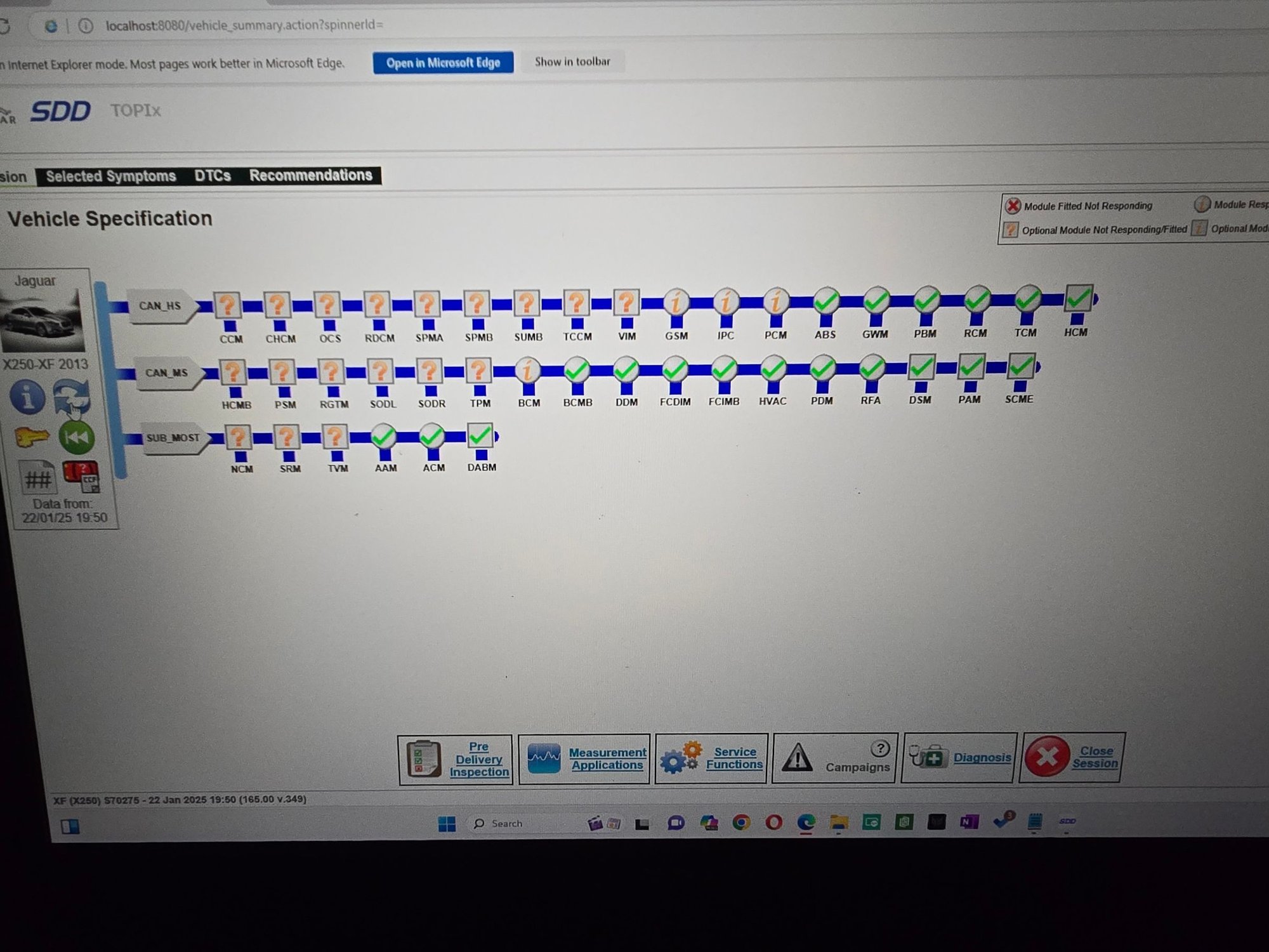

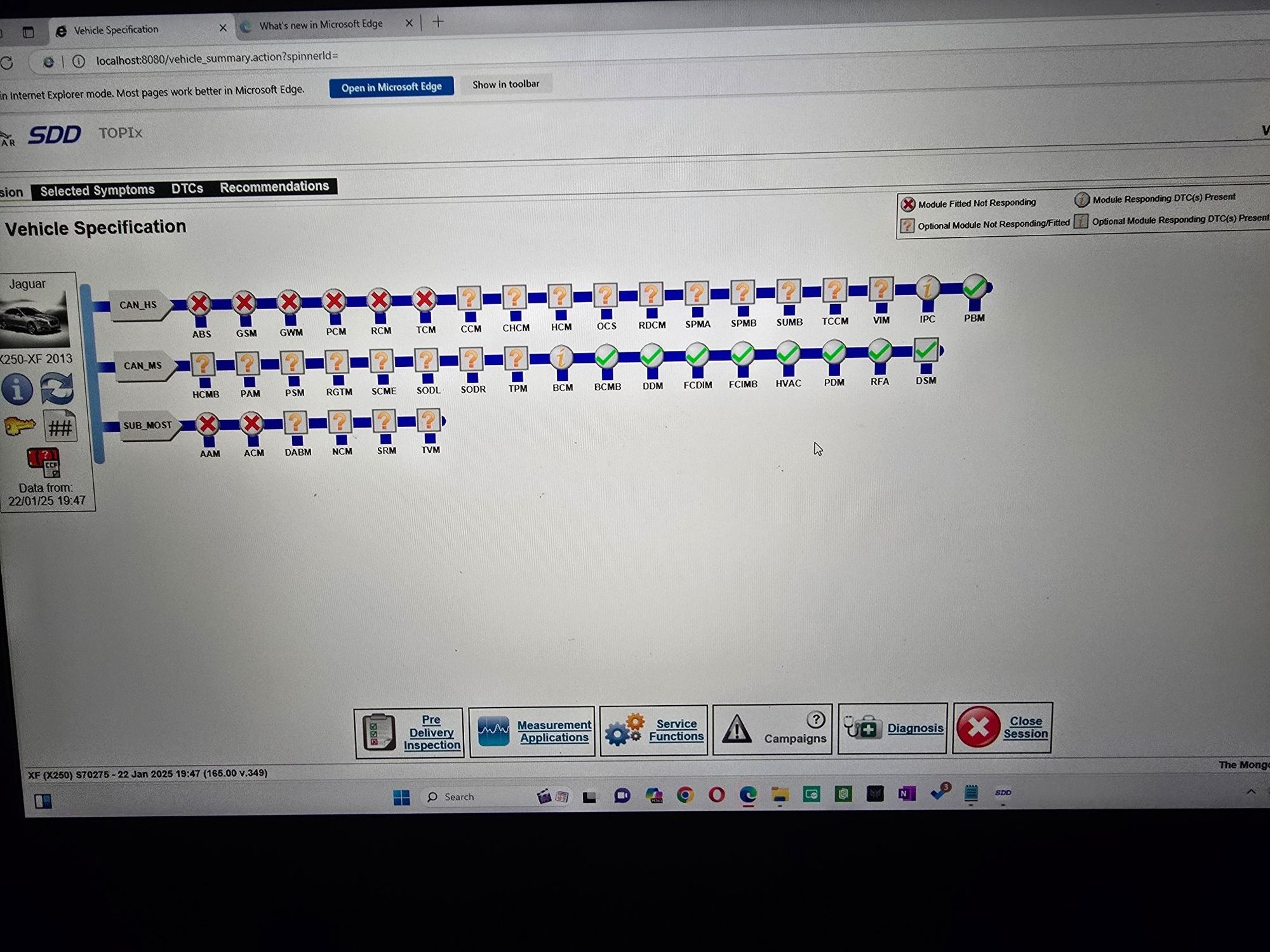

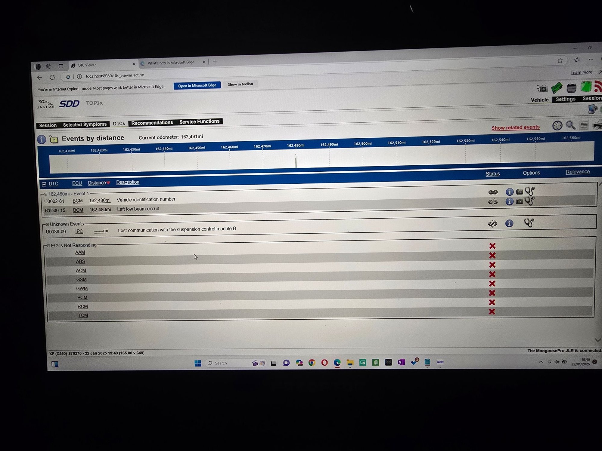

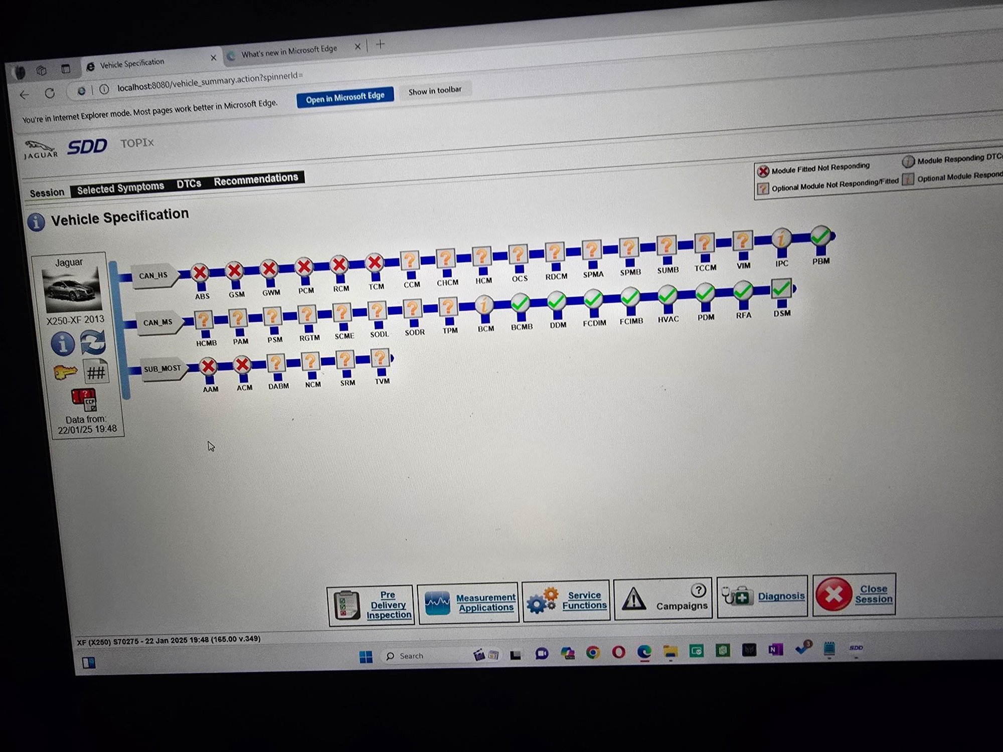

Ok pictures of issues: The car drives like a dream, fast good on MPG, until this happens and must say Michelin Pilot Sport 4 are shocking in the wet/cold/icey weather, my other Jaguar XFS has Pace Alvanti and they are face supiorior grip wise/wheel spin on pull off.
So these are what the DTC's are showing and other screens - As stated I'm a novice at SSD so any advise and help muchly appreciated, managed to reconfigure the BCM and reprogram both keys which I was happy about, but not sure if I've missed some steps causing the Adaptive Dynamic yellow error message. Also now doesnt let me use snow or dynamic.
First lot with small amount of DTC's is engine off, second lot engine running.
Thoughts and advise all welcome so please help if you know. I'm very hands on and like to try and sort things myself al beit without access to a lift. :P Only purchased the car as my 2012 started going into restricted performance. I'd already taken apart the entire intake for leaks etc, took it to a indy who said the second turbo was going and DPF full (Despite no DPF warnings) so inc MOT cost me £700 and they told me to sell it asap. I'm going to load the error codes on for that on another thread as it's very different issue and earlier car. I want to try and keep it and fix as much as possible as the resell value might as well keep her as a project.

Oh the BCM has lost it's VIN, it'll be corruption of the emulated eeprom in it's SoC see https://www.jaginfo.org/posts/2948062/ for how to fix that otherwise you'll be back to smart key not found no matter how carefully you wait for the modules to shutdown before disconnecting the battery. ( You may find you windscreen washers have stopped working - if so it'll be the cause of that )
As the module for you active damping is powered from the BCM, it's seems likely that once the above corruption is fixed it'll power up.
