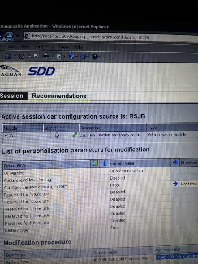

Yes it is possible, getting into engineering mode is the hard part. Look around for Current Car Configuration routine in available functions, if you are actually in edit mode it should like like the screenshot without anything grayed out.
Not mine, borrowed from here.

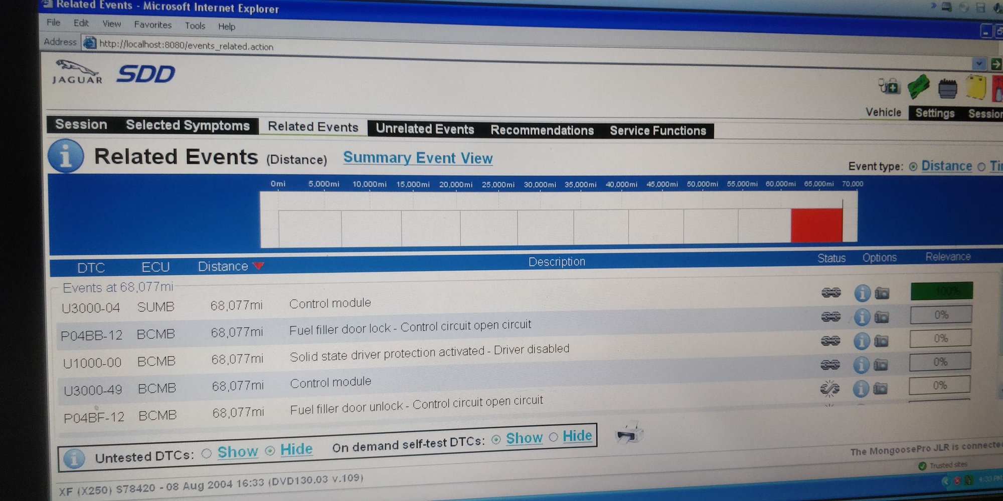

Please find attached a screen grab of my last session with DTC and recommended candidates.
Is the current vehicle car configuration modification in the recommendations where it can be done.
If so how difficult is it once the program is run
Thanks in advance
Diesel

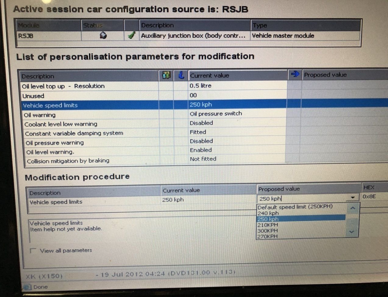

You are on the right track. Once in Current Configuration Management with Engineering mode active, highlight the feature to be disabled, then choose from the drop-down box in the lower section to change it to 'Not installed' or Not Fitted etc
Valid concerns about interconnected systems being possibly affected. Theoretically once marked as the car not having the feature, it stops checking those modules and their connectivity status. However some are in a network type that need signal continuity so if the affected module is busted to the point of blocking that path, a fiber loop would be needed to bypass it so the neighboring modules don't throw panic lights.
As a reference point, from functional dynamic suspension on my car to start with(no lights or codes), after disabling it in CCF I am able to disconnect the shock connectors and have no dash lights about this useless system. Yes it defaults to the rock hard ride as expected so I leave the plugs in, but no lights either connected or disconnected. I left the module alone for now since they purposely bury it under the seat, so it can drown in a sudden downpour or because their crappy sunroof drains getting blocked. I will get it out when I get around to looping out bluetooth and everything else I disabled the same way.
I dug these up from the session after the change, I don't remember which did the trick but later I did the other one as a way to kill it with fire and have no suspension related lights ever coming on.
