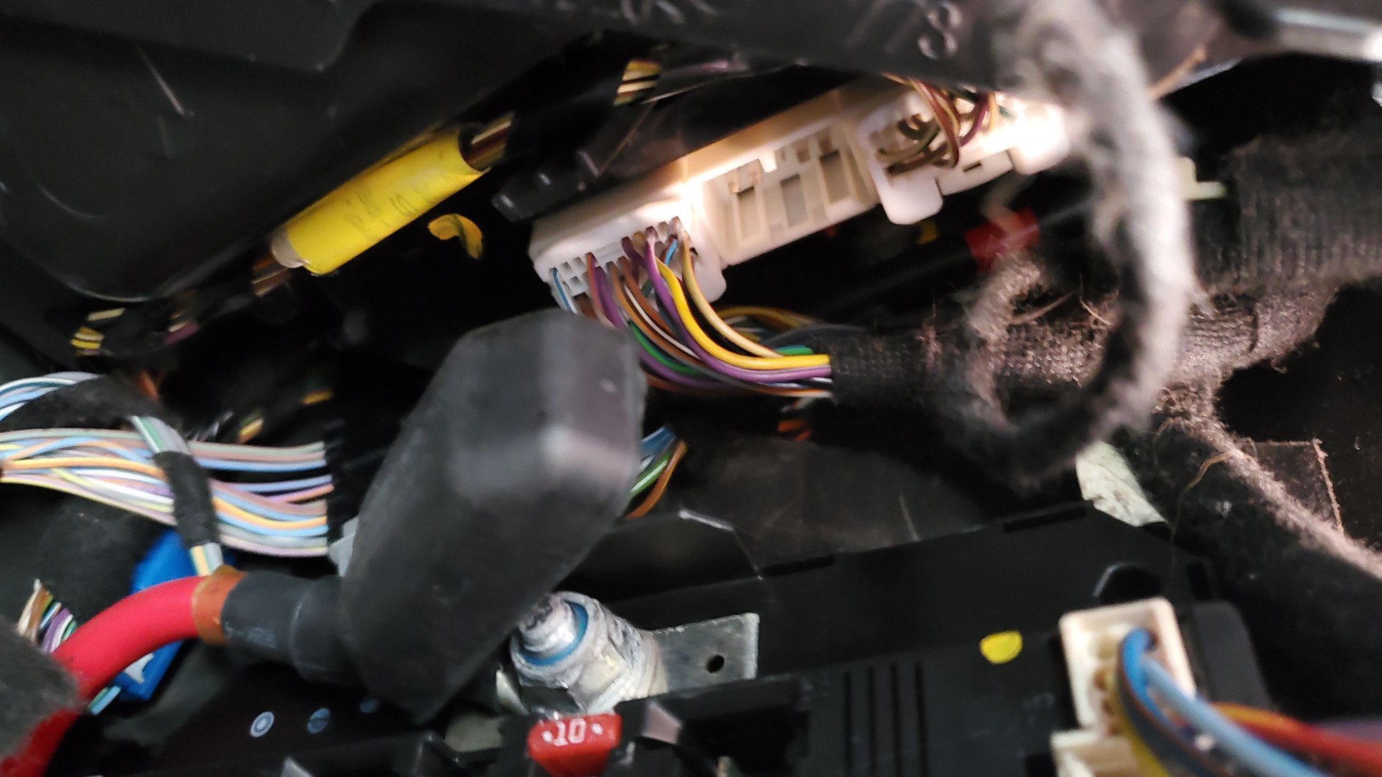

Is there supposed to be a connection here? On a 2009 XF Supercharged. this is above the CJB. New to me car and I dont know where to look in the manual for this. Thank you.

Do you have a problem?
These are massively complicated cars with dozens of variations depending on country, drive train and owner options. So no way to tell unless your missing a feature in your car.

Spent the weekend going through and fixing things that the seller said he fixed (go figure), he sent it to his "mechanic" after I test drove it and pointed out the things that didnt work and it came back with more problems. There were a bunch of codes that came up after I had an independent inspection done on it. Its not giving me any warning right now, but now the parking aid does not work. I have the backup cameras, but no sensors and I know they worked before he "fixed" it up. I replaced the battery, spark plugs, snuffed out some wiring issue (fuse kept blowing and it was a short in the wire for the vanity mirror) seat fore/aft was not working, fixed that easy enough by holding the control longer than 2 seconds. The rear sunblind is also still not working, I can hear the motor click when control is pushed but no action. Seems driveable for now, but the bushings are all worn, there are a few small oil leaks on the block, and the pinion seal needs replaced as it is also leaking a bit.

Well keep up the good work as you have a number of problems but your working thru them.
With all these problems do you have a good scanner? Even if no dash lights there are a lot of codes to help fix things. Be sure and erase them everytime you scan the car. Don't want to be chasing "historic" codes from the past.
If you can post the code numbers that will allow others to give you help solving these problems.
Your car has the 4.2L V-8 SC right?
