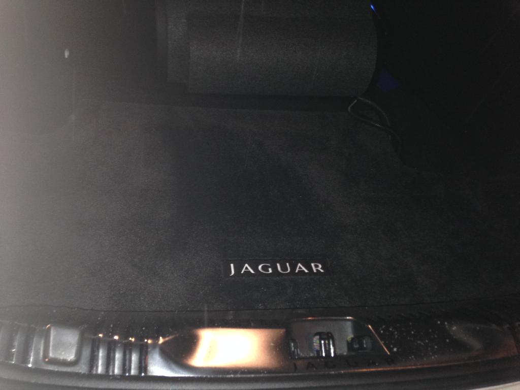

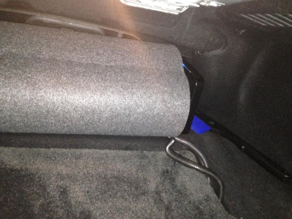

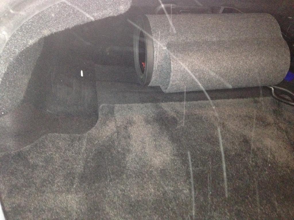

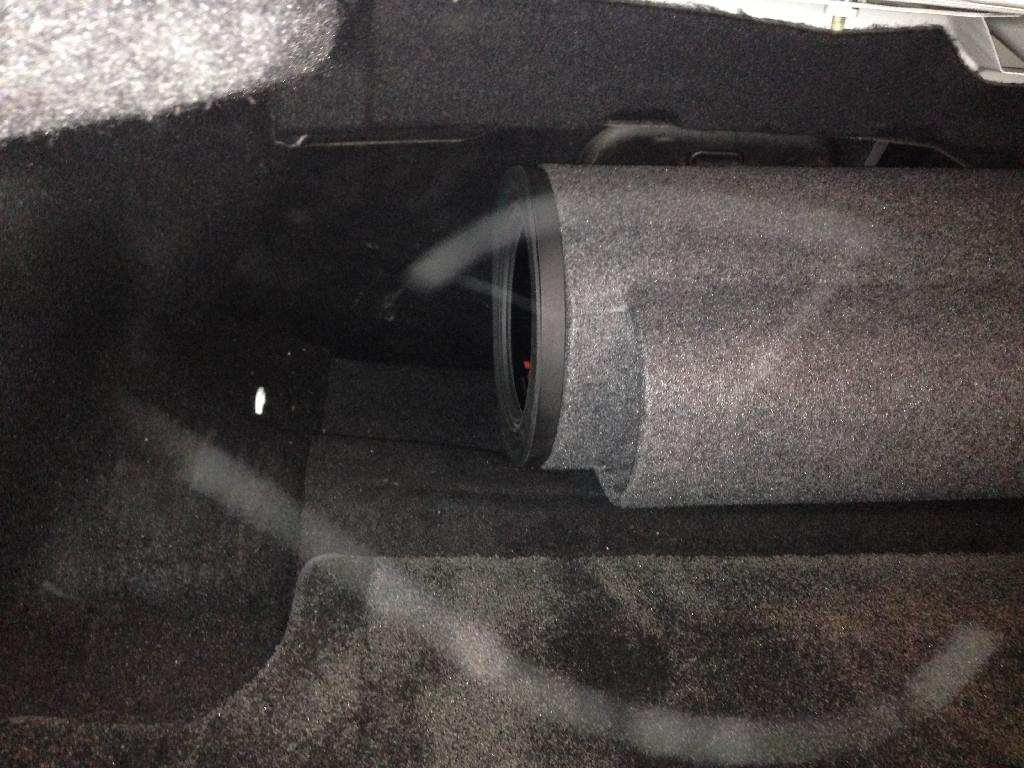

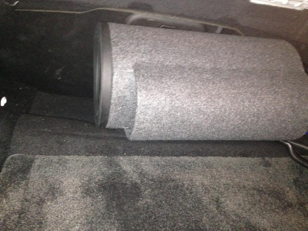

In my 2012 XFR I have the B&W sound system with the 8" sub, but it wasn't sufficient, so like many I went for an aftermarket solution, and I used this to tap into the factory sub wiring:
Pac-Audio.com Product Details | iPod Integration for your car and More by Pac-Audio - Connecting you to the future
Converts the high speaker signal to RCA outputs, plus provides remote trigger all in one... and the sound is awesome...
Although I had other car audio equipment, I went for this amp:
Alpine Electronics of America, Inc.
small footprint and huge output
And to go along with it I went with this sub:
I installed all the components myself, and it was by far the easiest install I have done, as their is no routing wiring from the head unit, or under the hood (battery)... Everything is right their in the trunk... I installed the sub in a standard sealed box, that you would pickup at any car audio store, and it did the job initially but being a sealed box, it didn't quite give me the sound I wanted, and it was already taking up a lot of room in my trunk, and I figured if I was going to give up valuable real estate in my trunk it might as well be worthwhile, so I built a custom box that took up the entire width of the trunk and barely protruded past the hump (brace) in the trunk... This sounded awesome but after 6 months I couldn't live with not having a trunk...
So I went another route, I remember when I was young, I had used a Bass Tube, and it did great in the hatch back that I had at the time, and took up very little room. I wanted to make use of the sub and amp and simply find an enclosure that mimicked how efficient the bass tube setup was, but provided better sound...
After some searching... I found:
NEW Nippon TUB10 10" CAR Audio 5 8" Ported Vent Subwoofer SUB Tube BOX Enclosure | eBay
I do not have any pics of the install, but I can snap a shot of my trunk to show how much space this is occupying... and the best part is I can still access my spare, and if for any reason I need it out of the car I can have it out in a matter of 30 seconds... the two (2) RCAs are pulled and there is a quick disconnect for the power (+, -, and remote)...
I will update with pics later today...
