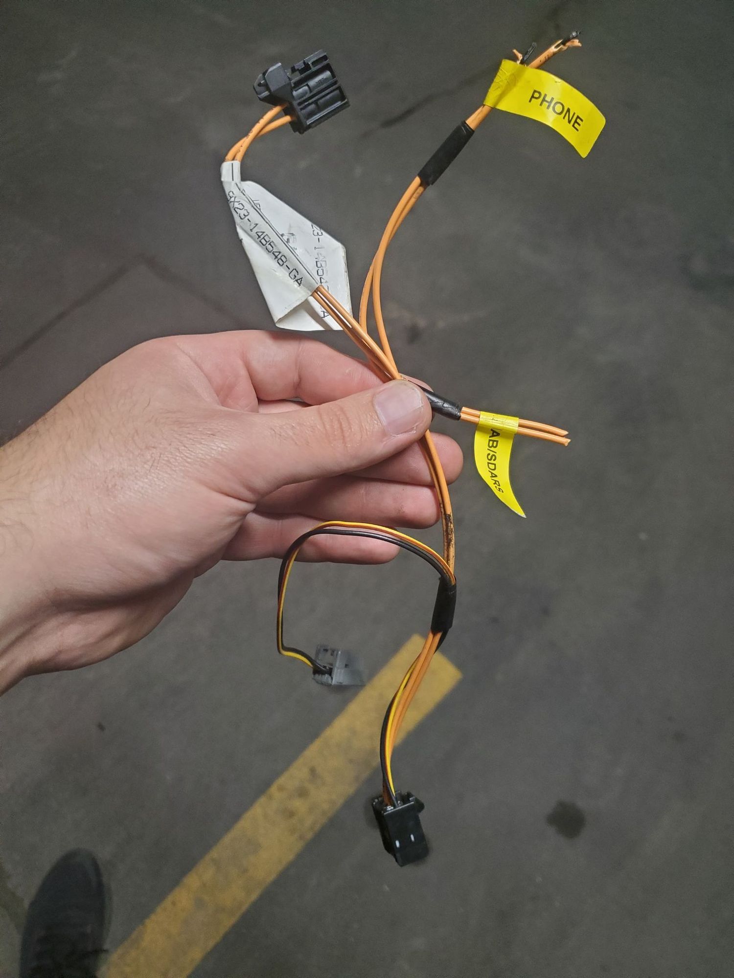

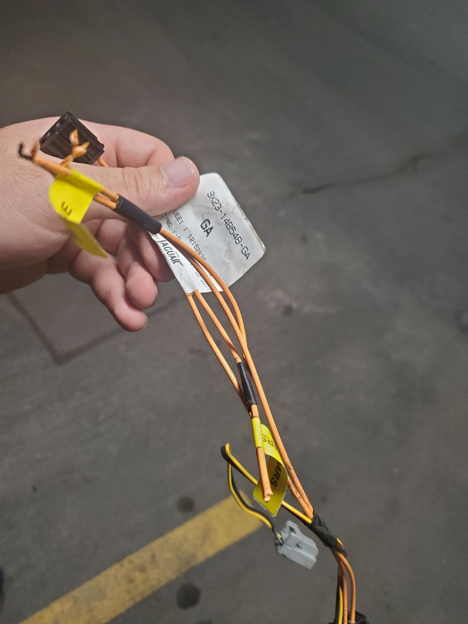

Hi,
The car i got was written off. They decided to cut the harness to give proof for electronic issues.
This is the part number:
9X2314B548GA
Any idea where i can get it from? Everywhere I look its OUT OF STOCK. Also i live in Canada.

I read the item on ebay, however it says for XK, XJ, and so on. This is for newer model jaguars and color is completely different
Are you sure these connectors will be compatible with the module inputs?
