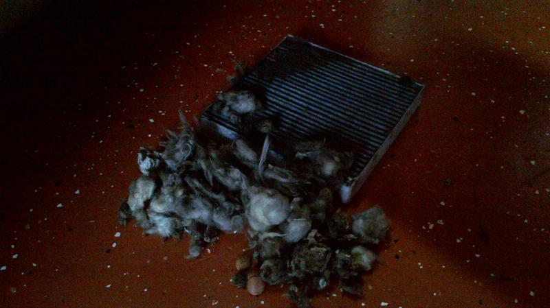

Received my replacement cabin air filter today so went under the dash and pulled the old one out......Holy Crap! Something was living in there at some point! As you know I recently purchased the car from a Jaguar dealership after meeting the original car guy owner. This is a good example of do it yourself to be sure.
I am wondering how something would get in there. Anyone know where the air intake is?

What is that stuff? Is it feathers?

Mouse nest? Intake is usually at the base of the windshield where air pressure is higher. I'd be checking for a chewed hole somewhere under the hood as it is hard to see how a mouse would get in though the normal air intake point.

It is a critter nest. Mice tunneled into the under car insulation on mine to create their nest.
Looks like insulation to me. I pushed a moist towel up in there to clean everything out before putting in the new filter.
There was a bit of dog food and a nut shell in there so I'm thinking a squirrel?? I have checked under the hood, under the car and cannot find any thing out of the ordinary as far as a chewed hole goes. There is the spot where the jack goes under the front passenger door that has an opening up into the body.
What bothers me even more is that this was missed in the used car inspection at the Jaguar dealership, doesn't seem like they do anything to the cars, bring em in and sell for the most possible profit forget about making sure its a good car. I shouldn't be surprised, the same place tried to sell me the G37s that had been all smashed up and put back together.

Originally Posted by CP1
How about some pics on replacing the filter.
Sorry didn't take pics of actually replacing the filter but it is simple. Their is a fiber cover under the glovebox area held in by 3 clips, squeeze the clip together with a plier and pull it down and out, once all 3 clips are out the cover drops down and slides completely out (the clips stay in the slots on the cover). The filter cover has 2 clips on each side you squeeze inward and the cover with the filter slides down and out, it is located toward the outer side of the wheel well, you can't miss it. Make sure you have a flashlight, the footwell light just blinds you.
