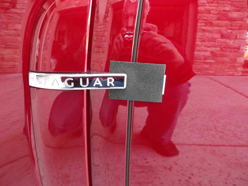

Pic 1: I used some non-skid tape I had to put under the original chrome Jaguar emblem attached to the original claret colored side vent.

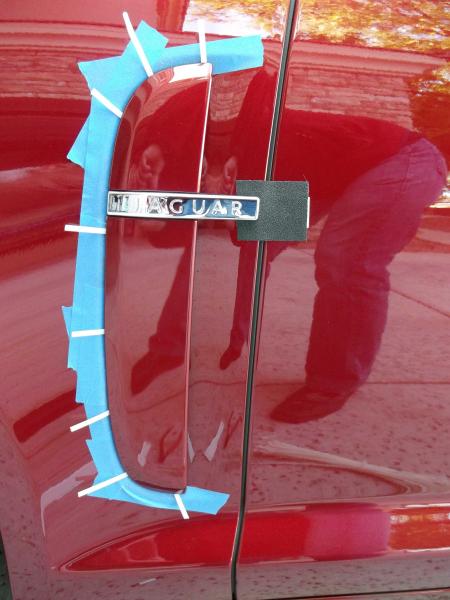

Pic 2: I put masking tape between the existing side vent and the fender. I used a hard plastic putty knife to help make a gap to insert the tape into.
Pic 3: Once I had the tape in place I inserted pieces of zip tie between the side vent and the fender to put pressure on the fasteners holding the side vent to the fender and to make a gap where I could insert two hard plastic putty knives. The pressure caused the fasteners popped free in the rear of the vent and literally break in the front of the vent (see pic 7). I continued around the vent until all of the plastic fasteners had broken free.

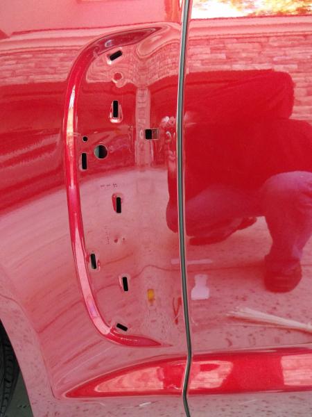

Pic 4: The fender free of the side vent shows where the slots are located. This might help show you where to pry if you are considering doing this yourself.
Pic 5: Tape removed and cleaned in prep for installation of new, chrome in my case, side vents.
