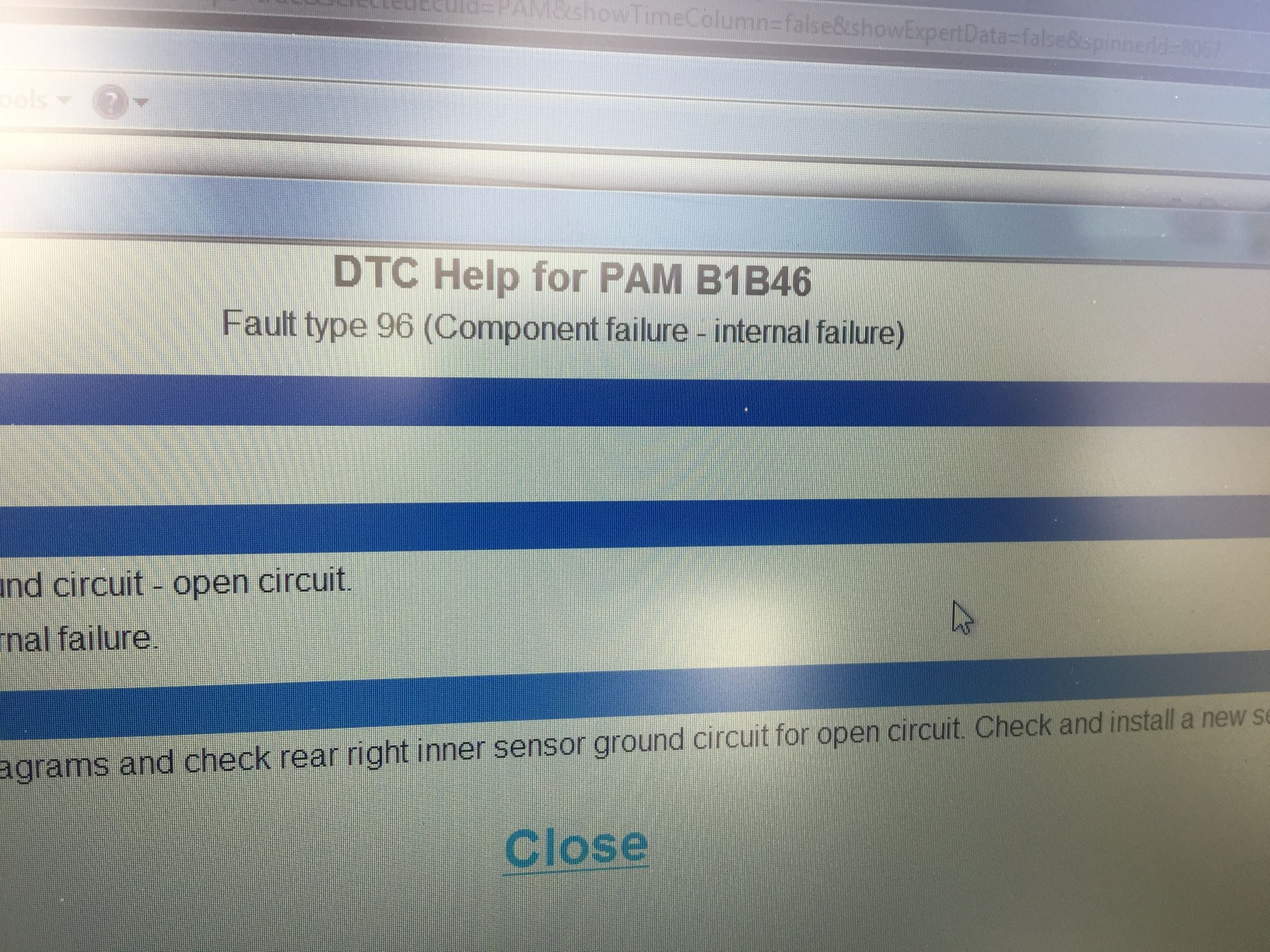

Hi All
I have a 2012 XF Portifolio with parking aid and rear view camera and when the car is placed in reverse, I get a message saying the system has a fault.
I have plugged the JLR SDD and read the following fault:
B1B46-96 Rear Right Inner Sensor , as per the picture attached.
I guess I have a faulty sensor. So couple questions pls...

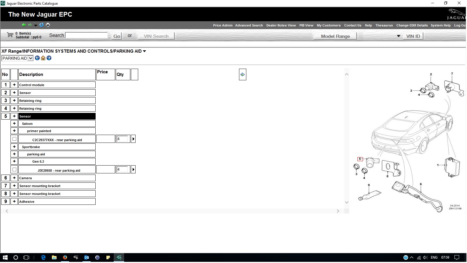

Old Oct 30, 2017 | 03:04 AM
Likes: 17,009
Welcome to the forum Lucio,
Here's the relevant section from JEPC:
