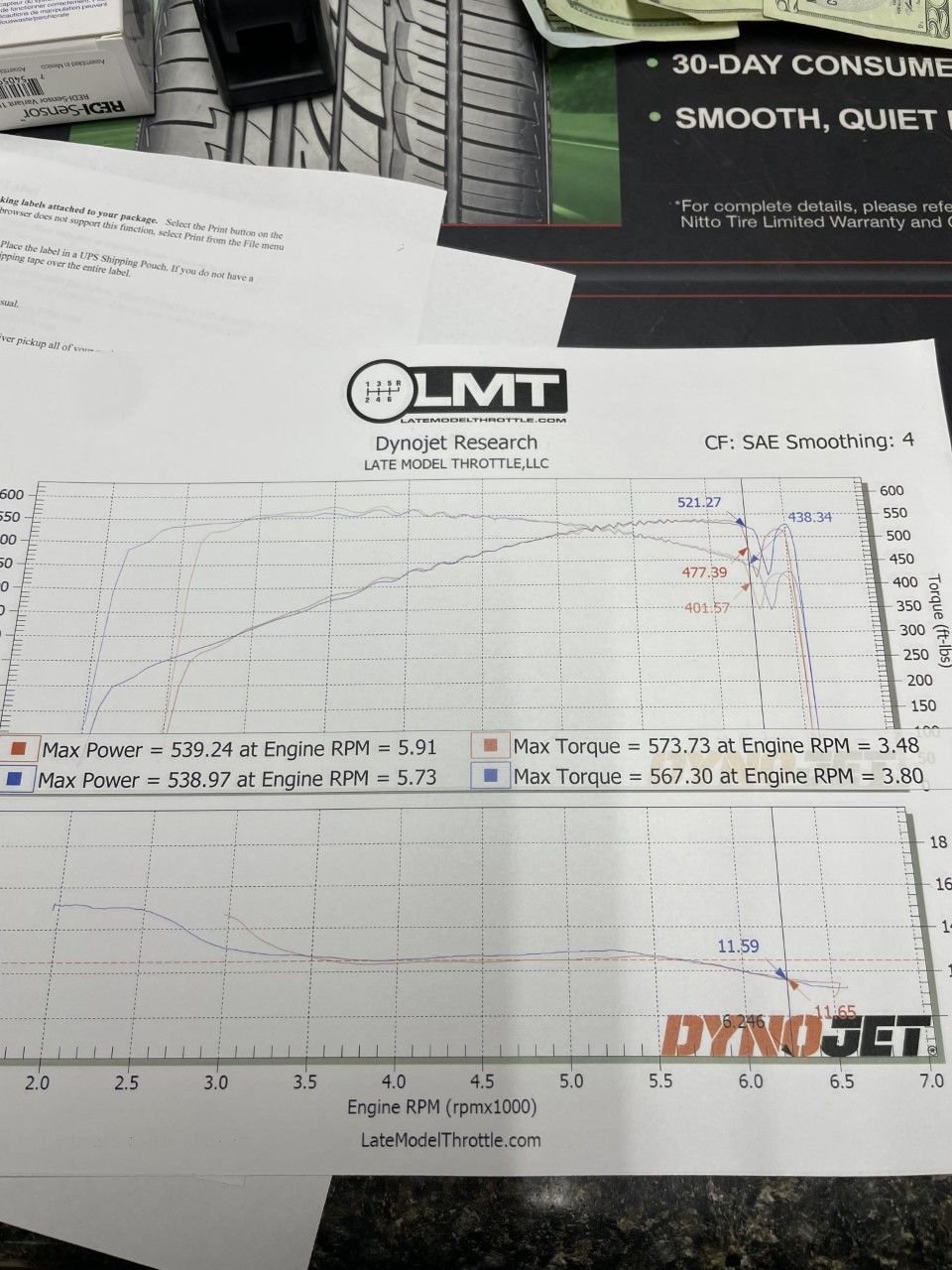

hi all, first thanks to OZ for all the predyno info. This am I took my 2010 xfr that has a eurotoys, lower/upper pulley and tune. center section removed with x pipe and mina axle back. I can tell you all looking at input from so many on this site had me scared to go to the dyno as many say the mods i have aren't worth much. Well I took it to latemodelthottle in Waukesha Wisconsin and Jeff put me on his dyno jet dyno. HP 539.24 at 5900 and 573.71 at 3500. This was after a hour drive and 20 minute cool down as I didn't have an appointment. We shut it down talked for about 15 minutes and ran it again 538.97 and 567.30. I will put the dynoi sheet up when I have a few minutes to figure out how to do it.
I have to say the dyno supported my seat of the pants feel and was happy as I could be. Look forward to the next rounds of mods right now I have 25K in the car including purchase.
lmk what you think
so what I learned today these cars can be beasts with very little modifications ones that don't cost alot, if about 120 rwhp isn't worth $2500ish I don't know what to tell ya

That looks really Good! Not much power loss at all between runs.

Yep, great results!
Nice AFRs as well, as expected started to drop (get richer) after around 5,300 rpm but not too much.
