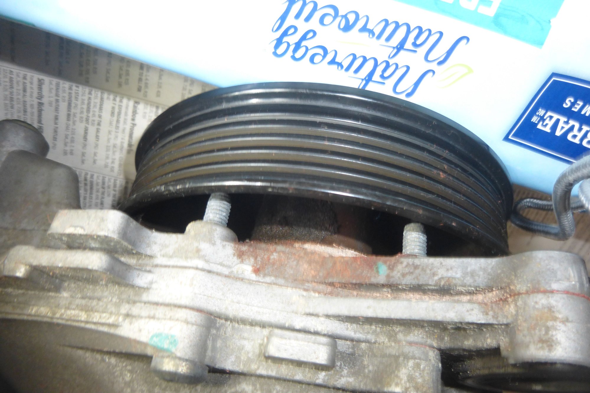

I was checking over my 2012 XF NA Portfolio in preparation for our trip to Canmore, Alberta next week. I decided to check the idler pulleys on the accessory drive belt. All looked well until i checked the water pump pulley which had play on it but no obvious leak---I have not added coolant for the past 3 years. Car has 56k kms or 35k miles on the clock. I replaced the pump today and found evidence of very minor leakage at the shaft drain and play in all directions on the shaft. I have to fill with new coolant and pressure test tomorrow.

Sounds like you prevented a major problem.
Can I ask you for a pic of the evidence you found in the shaft drain? That is typical in other applications and I'd like to compare.

I have attached the best picture I could take. You can see two things---a patch of wet coolant that drained out after removal and an area of dried up coolant and dirt which accumulated over the years. the drain hole is almost obscured with dried dirt and coolant.

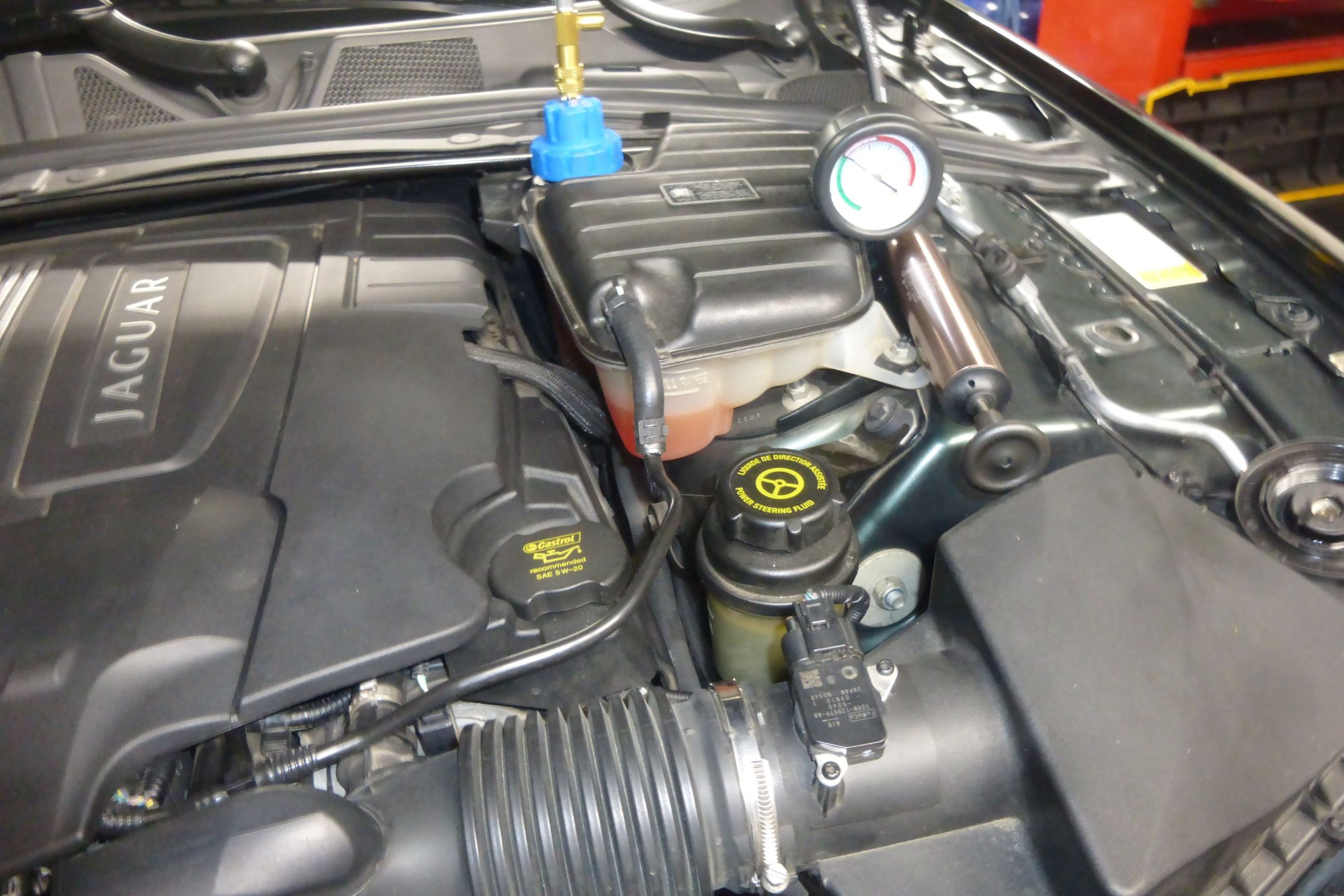

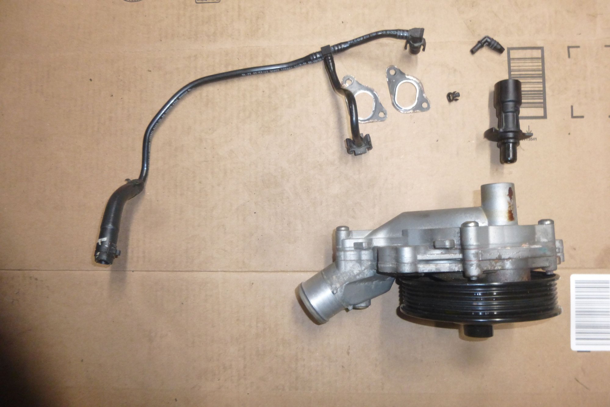

Finished this replacement today. The first pic shows the parts I replaced---water pump( by GMB), water pipe to engine oil cooler ( used an aluminum one with Jaguar seals) and water pipe from water pump to header tank. I had to replace the plastic connector on the water pump with a brass fitting but I retained the original factory routing because I did not have the new design water pipe. The second pic shows a second pressure test on the cooling system---per the recommendations at 15psi.
Note factory gaskets installed without sealant and the flanges were clean except for minor bits of paint from gaskets which were easily removed. a small piece of the plastic elbow was left in the brass fitting on wp outlet.
Leaving for Calgary next Thursday so hopefully all will be well. I have new plastic front cross pipe, thermostat and rear heater pipe but I may wait until I get aluminum ones ---a winter project.
replaced Bits plastic elbow failed
NO LEAKS
