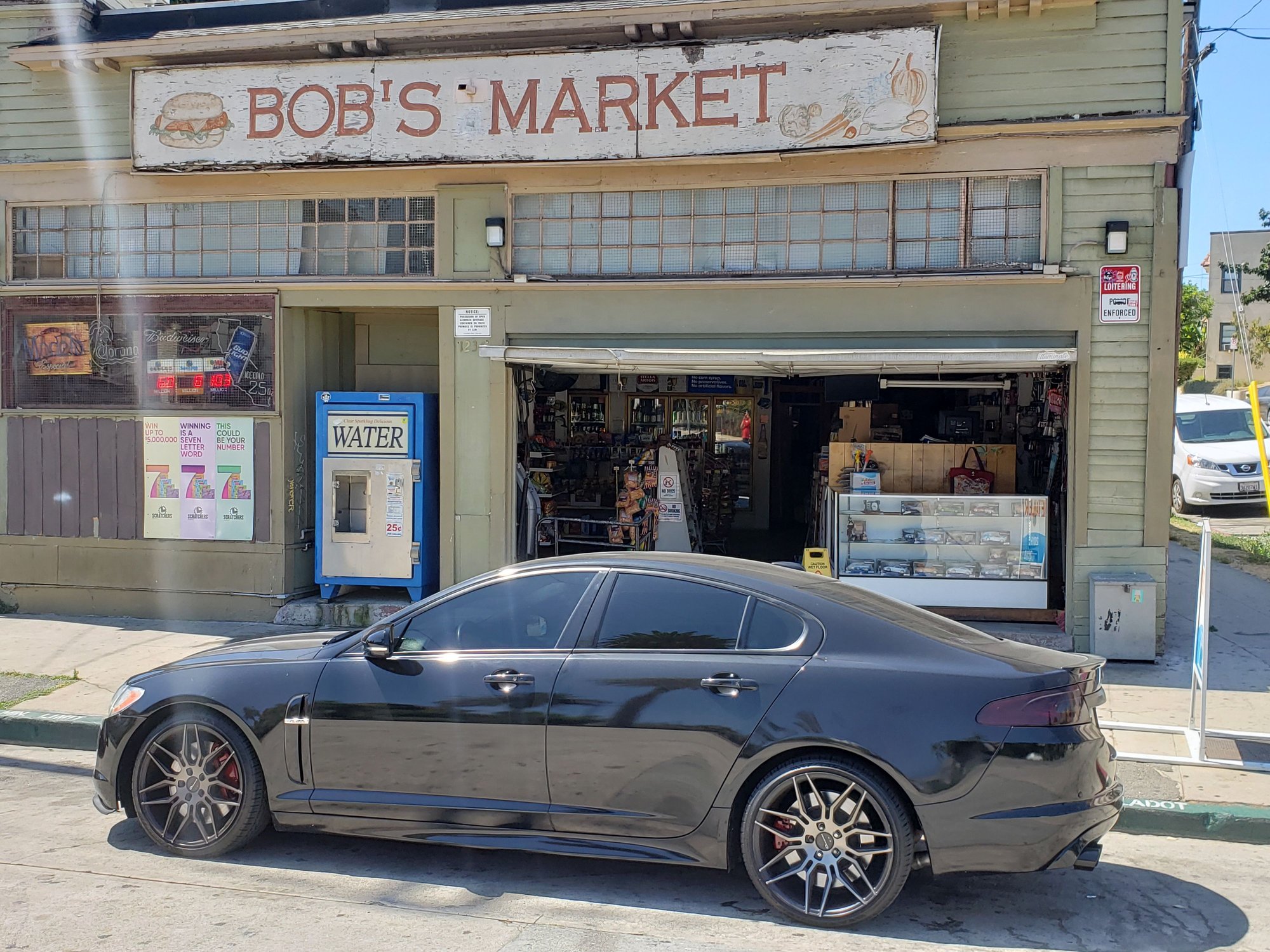

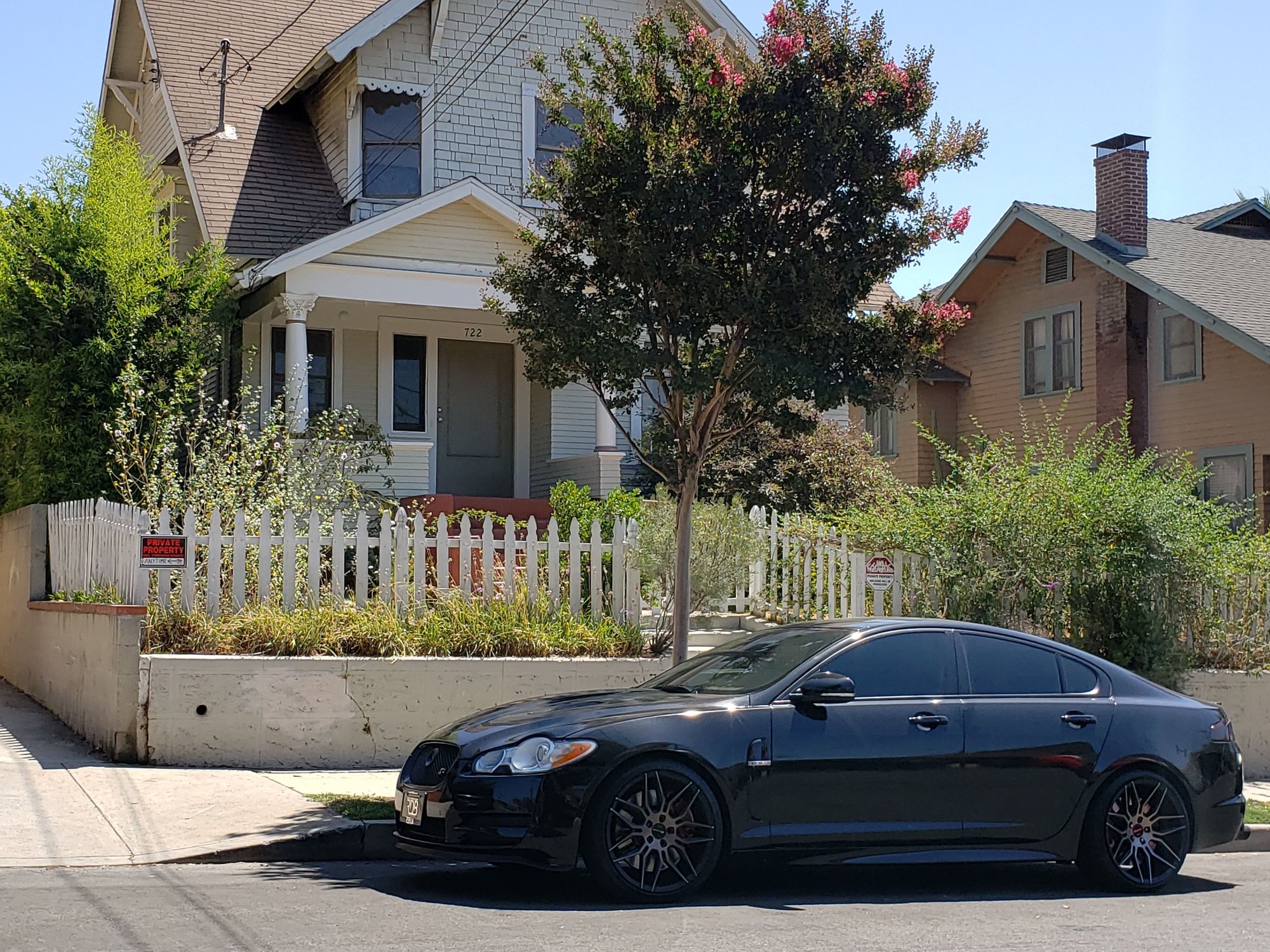

Hey everyone I'm new to this and wanted feedback from other jaguar enthusiasts on what I want to do next to my 2010 Jaguar XFR . My car currently has upgrades such as: Mina Gallery exhaust, Mina Gallery Pulley, Mina Gallery Intake and K&N filters. This car needs a tune but here in Los Angeles is hard trying to find a shop who performs tunes. What I really want to do is take my Jaguar to another level that no one has seen before . I want to make my Car 1000 horsepower but not sure if I'm going to need to swap motors or anything I can do to get those numbers with what I have already

Nice rims.

That is one beautiful car. Love the wheels. As the others have said, the car isn't designed to handle 1000hp. Be happy with what you have. Remember, "YOU PLAY...YOU PAY".

That's one nice car there (even without 1000hp)
