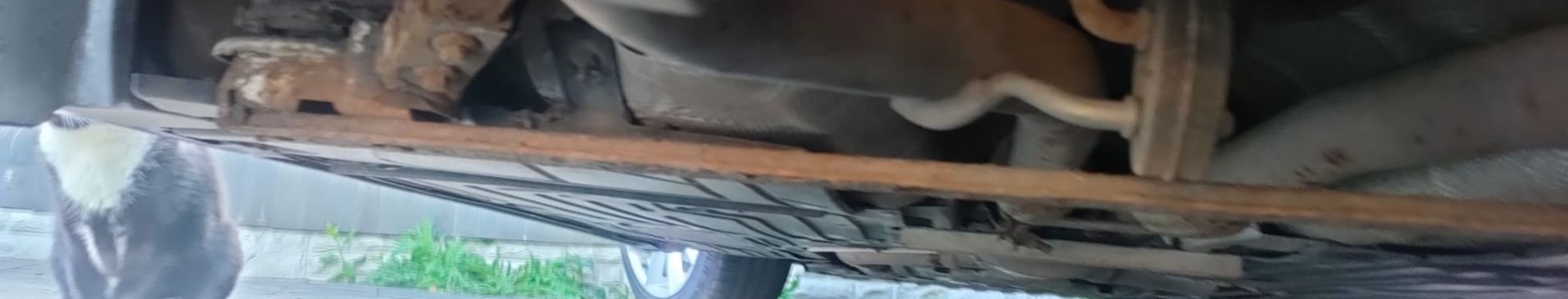

Picked up our 2013 Sportbrake 3.0 last week and need a bit of help with 2 things if anyone can assist.
1. There are 3 bars attached to the subframe, and they look v. rusty at the brackets (see pics). Thinking we probably need to replace but have no idea what they are called, please can someone point us in the right direction?

The part number of the beam is C2D10278 not sure if sportsbrake is different??
This is worth a read (page 61).....https://www.jaginfo.org/threads/2011...110520/page-61
