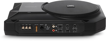

I want to connect a little subwoofer ( 20cm ) with amplifier included
I can't connect it in the middle

So how can I connect it to the radio ?
