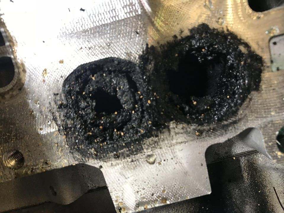

· Check intake manifold for carbon buildup (Direct Injected Engine)
Carbon Fouling
Carbon Fouling

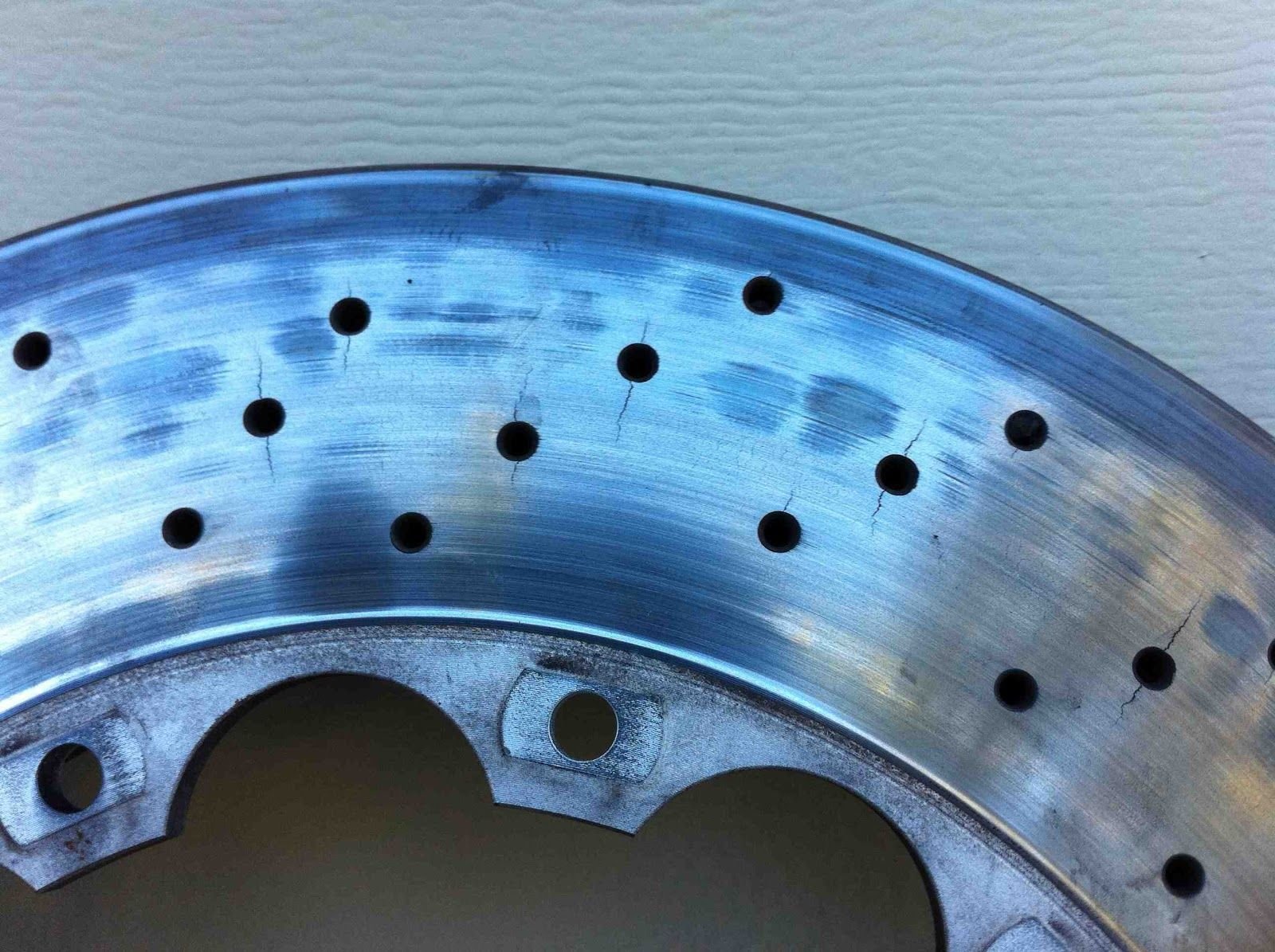

Would not recommend any cross drilled rotors either. Solid or slotted only. Our cars are way too heavy to use Drilled; will crack every time, all the time, its just a matter of time; don’t burn your money on these. Don’t even think of going on a track with drilled. I smell burning money already! If you are looking at a set of rotors not listed here make sure they are G3500 grade high carbon and have the large vanes for air to cool them solid or slotted.

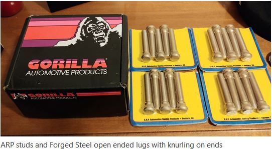

Stock OEM threads and lugs are good but ARP Studs and forged steel knurled lugs are what is strongest. Don’t use tuner aluminum nuts. You don’t want your wheels coming off. Once you have this locked down pick a Flow Forged wheel or Forged wheel. The reason is the stock Jaguar Nevis Wheels are very fragile and will crack and split with the shallowest of potholes. I cracked one of my wheels and split the tire on a 1” deep pothole. It could have been the Continental tire, because I have never had this issue with any other brand of tire before or after Continental. I went through three sets of these tires before I vowed never to buy them again. If you track your car, get a mono-block forged wheel. That is the strongest wheel made. A 2-piece is heavier but you can replace just the lip or just the center if it gets damaged.

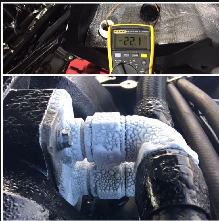

Lets start with the intake air coming into the grille. Intake air temp (IAT’s) in my car have heat soaked to over 200F degrees in the pits. That is insane. Ideal would be ambient temperature. The air filter inlets are going over the radiator. That heat is baking that air as it enters the filters. Then it goes through the intake that is directly over the radiator fan. Then it goes into the supercharger where the gear heat, compression and engine heat are transferred into the air. Then the heated air goes through the intercooler to then get the engine coolant run through it to make sure its super hot and then goes into the engine. So lets engineer this in reverse.
Lets move the intake from over the radiator to in the hood or side fender away from all the heat. We can use a inexpensive naca duct to do this. Then after the MAF we can insulate a dual walled intake pipe with aspen aerogel to keep that cool air cool. Now comes the tricky part. We need insulating spacers, to lift the S/C off the engine keeping that heat out of the metal. Then ceramic coat and epoxy aerogel to the bottom of the supercharger. Adding aerogel to the engine block below as well under the oil cooler. Now we can add a https://www.facebook.com/stiegemeierporting/videos/stiegemeiers-venom-cooler/552424358567832/ to cool the bearings. Now the engine heat is divorced from the supercharger. Then, we divorce the engine heated coolant from the intercooler, with a https://fiinterchillers.com/product/baffled-interchiller-tank/, and put insulation https://fiinterchillers.com/product/foam-insulation-sheet/ and https://www.ebay.com/itm/286050454488?_skw=line+insulation+ac&itmmeta=01JFCY30PFNXQJE9FTDPPQNT7T&hash=item4299ef8bd8:g:52AAAOSwI0xm3MNf&itmprp=enc%3AAQAJAAAA0HoV3kP08IDx%2BKZ9MfhVJKm5ntHhjcOsOu1MjbTfRWTN0%2F1PhoMiqqIBXflKiKdlLC3HB%2FB8UJfKXbPLFt1QVMReA5JD8BXjFvGA9d0daGmNzCcQ1ubgbA3NNw%2FYs8mDmNy4RdUta37MFu9pwPWSP0eT4AcPJ5zanuOgpbVp4RrJOLgDKVk2t9No2P8VEvxobcwWYm%2Be2p3SIOZmegkKDgPQwZJfooRtIx26VHjh0eygaDXRFUtwdywqX7Jg3a68HC7ldpXvVh12Y98zh8e8upU%3D%7Ctkp%3ABk9SR7yLjJ77ZA.
Then add an interchiller to the intercooler to cool the coolant below ambient. Now the engine coolant is divorced and the intercooler coolant is chilled. From here we can add water injection with a snow performance water injection system. This will dump heat loads on straights so the rest of the coolant system is not overwhelmed and can maintain below ambient IAT’s. At this point the heat soak is fixed and now we work on actually cooling the engine itself.

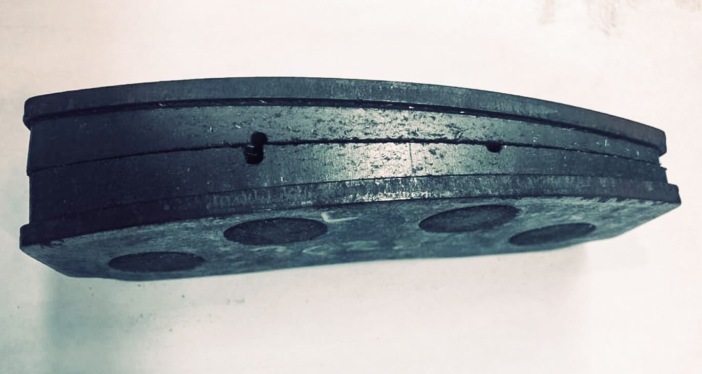

Now the IAT, Engine and fluids can stay cool, we can move to the brakes. The best brake systems period are made by AP racing and Performance Friction. $$$$$ I am working on getting a 6 pot track setup for the XF from Paragon and it looks like there is a 8 pot solution in PB Brakes already. They look to be pretty good (much better than factory SPB) and hardy, and they are plug and play. There are brands I would not recommend like CIEKA, Stoptech, Brembo, unless you do absolutely no HPDE track driving whatsoever and need a pretty brake behind your wheels. The way you can tell which is good, is if you can change the pads from the top without taking off the caliper, has steel or Titanium pistons, and the most important part- high temp seals. Most BBK’s like the Brembo have rubber seals with aluminum pistons and subpar metallurgy in the rotors that wears out on you like one ply toilet paper. That’s like putting lipstick on a worm and calling it a supermodel. It won’t work period. Aluminum pistons will transfer that heat so easily into the fluid and the rubber seal melts as low as 250F degrees, not much above ambient. Brakes can get over that temp just driving in the mountains. I have seen so many Brembo calipers even bend from the heat of track driving. You’ll know yours are bending when your brake pads look like this->
Tapered Pad Wear
Tapered Pad Wear
You will know you have Brembo rotors when new after one session on track for 20 min they look like this->
Brembo rotor 1 session
And your Brembo Calipers look like this->

Side note: if you ever get a bill for more than $8,000 on your XF for engine work, check this out. AJ133 5.0L S/C Engine $7K back up and running. IF that is too much there is This Kit if you have someone else to do it. Either way you need a different opinion and shop IMO. See if there is a Eurocharged shop nearby to get the work done. Dropping in a new engine might be cheaper than fixing your old one. The new ones have the problems fixed already.

-Divorce the engine coolant with the supercharger heat exchanger and run a separate insulated tank with this add Piedburg pump.
-Add a interchiller to the intercooler and insulate the lines and possibly ceramic coat the intercooler housing with bigger intercooler radiator.
-Add a Stagemeyer Venom Cooler to the S/C.
-Run a Prius electric compressor on the system for the interchiller to have its own compressor.
-Have a dual walled insulated
