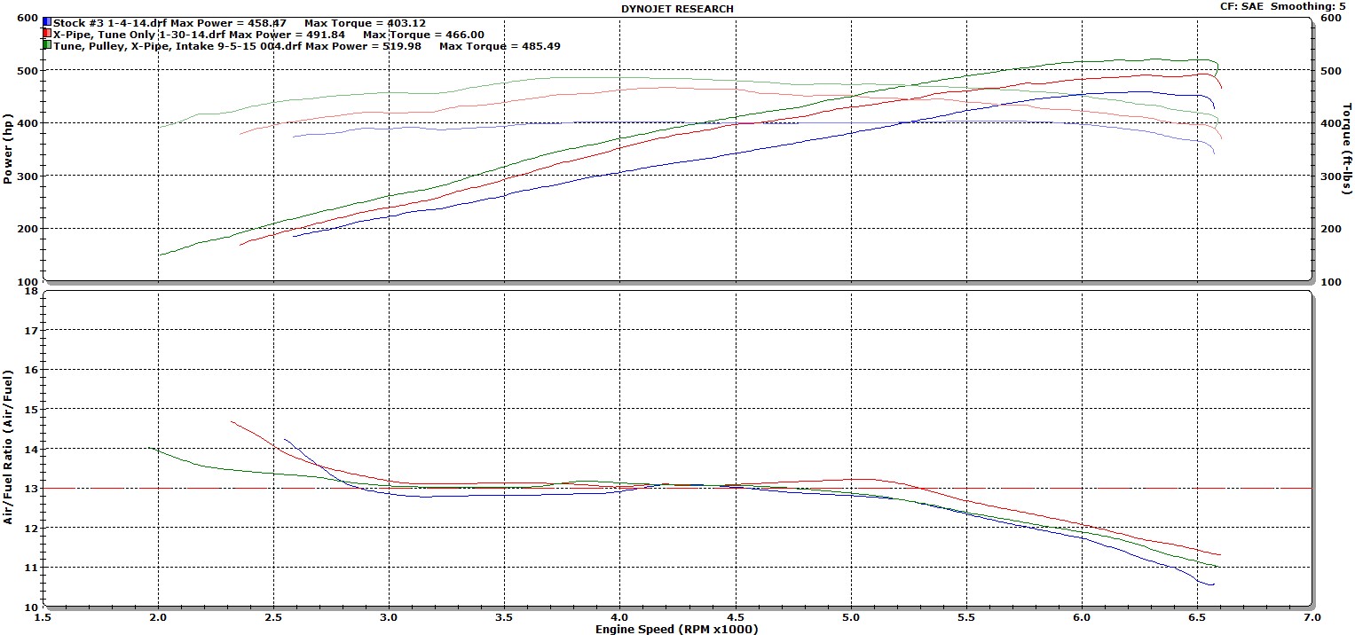

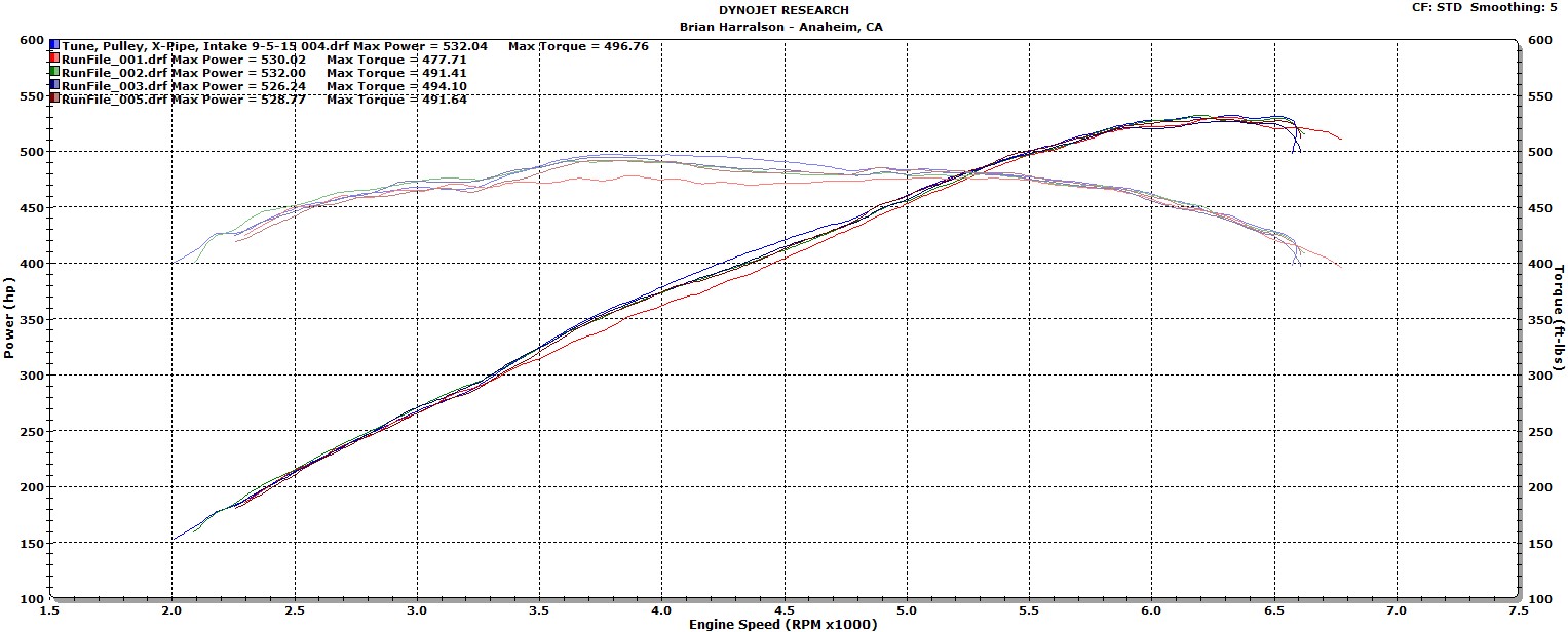

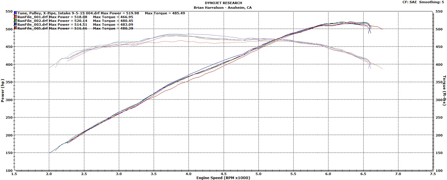

Ok. I guess I was mistaken when I published my dyno numbers from Saturday. That's what I get for putting something out half baked. I received the WinPEP files today and when I went to put it all together, I realized the 532/496 run was on STD correction and not SAE. After changing it to SAE, it was 520/485. It's still a bit better than expected but not "WTF is going on here" either. Still extremely happy with the result. I initially wanted to get back to the stock bhp ratings of 510/460 at the wheel. Done and done. And it's been very drama free except for the supercharger coolant pump issue, which has nothing to do with the mods.
I've attached the stock run, the run with tune and x-pipe only (with an asterisk) and the tune, pulley, x-pipe and intake run as well as the chart with AFR below. I give the tune and x-pipe run an asterisk because I don't know if the supercharger coolant pump was functioning correctly at that time or not. I believe so based on AFR, but it's interesting for comparison either way. What I find interesting is that nowhere in either the hp or torque curves do any of the runs come anywhere close to one another. Just more power with each level with no penalty. I haven't taken any time looking at the power listings, but I'm curious what the biggest increases are at each level.
I also attached a chart of all 5 runs for both SAE and STD correction. The consistency is why I've decided I don't need water/meth injection. In fact, the 4th run was the best so no heat issues to speak of. Never would have expected that.
Let me know if you have any questions.
Attached Thumbnails Jailbreak Tune, Pulley, Muffler Valve Delete & X-Pipe-stock-vs.-tune-pulley-x-pipe-intake-afr-9-5-15.jpg   Jailbreak Tune, Pulley, Muffler Valve Delete & X-Pipe-stock-vs.-tune-pulley-x-pipe-intake-9-5-15.jpg   Jailbreak Tune, Pulley, Muffler Valve Delete & X-Pipe-all-5-runs-9-5-15-sae-correction.jpg   Jailbreak Tune, Pulley, Muffler Valve Delete & X-Pipe-all-5-runs-9-5-15-std-correction.jpg

Great set of charts, and I'd die for those AFRs at the moment!
Fingers crossed I'll have something like them come this Tuesday.

Thank you! I make them myself. If anyone wants to see anything else, just let me know. Pretty easy to do. What I can't figure out is people that have dynos and can't produce a decent dyno chart. I learned how to make basic charts with WinPEP in about 30 min. and in an hour figured out everything I could do with the software.
I hope you get your situation figured out soon.
