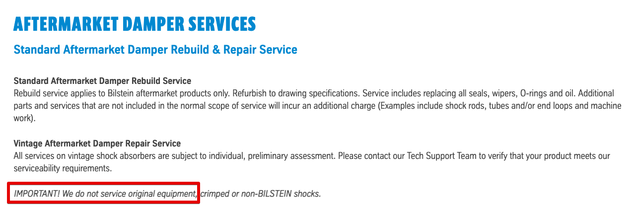

One point I'm confused about though - CATS vs Damptronic. Are they the same thing? I'm looking for shocks that I can use with the existing factory wiring/connectors etc, but nobody seems to include pictures of the top of the strut so you can verify.
Intrigued by the idea of sending the shocks back to Bilstein - do they also offer this as just a general reconditioning rather than tuning?
EDIT: Booooooo

Bilstien have a lifetime warranty on their shocks. You can get them refurbished back to new too. If you scroll down their motorsports division does the re-valving after you talk to them and fill out a form and tell them what you did for spring rate. It would help to have 4 wheel scale numbers on each corner, these guys are the best in the business at setting up suspension. They can and will re-valve/re-condition a non-adjustable bilstien shock; its the first option under motorsports. Just tell them there is nothing else out there. I bought some aftermarket shocks for a Supra and they re-valved them. They were a TRD HD shock you can get from the dealer. Optional factory shock.
I want to get all new bushings so I can go ahead and re-valve these B4's and put the XFRS sway bar on. I think it will be a revelation in difference. With a proper LSD that I just bought for it it should be legit track ready with some NT01 R comps. Then onto race brakes from AP Racing. 5000R. If only I was made of money like all these kids on the internet....
