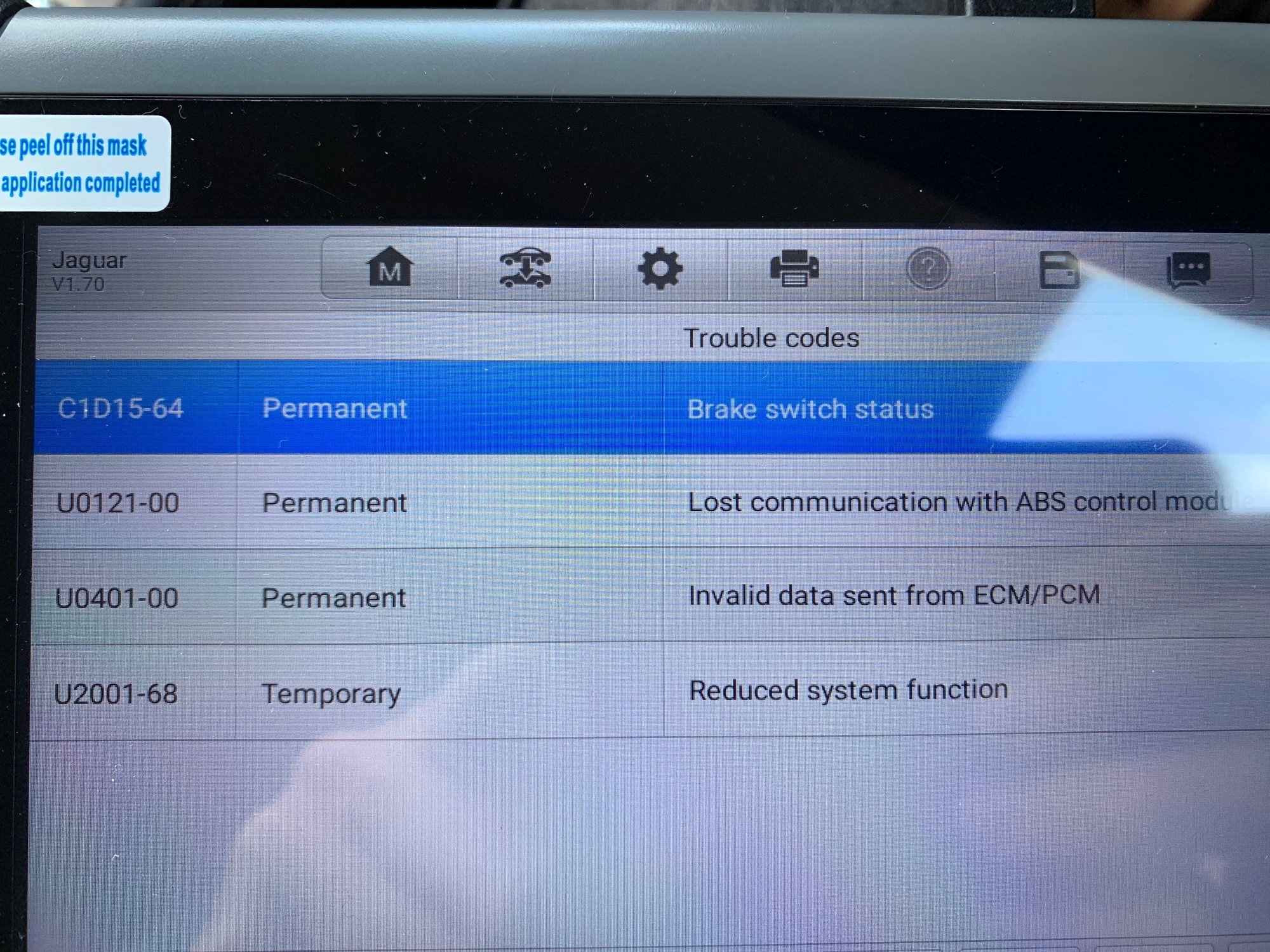

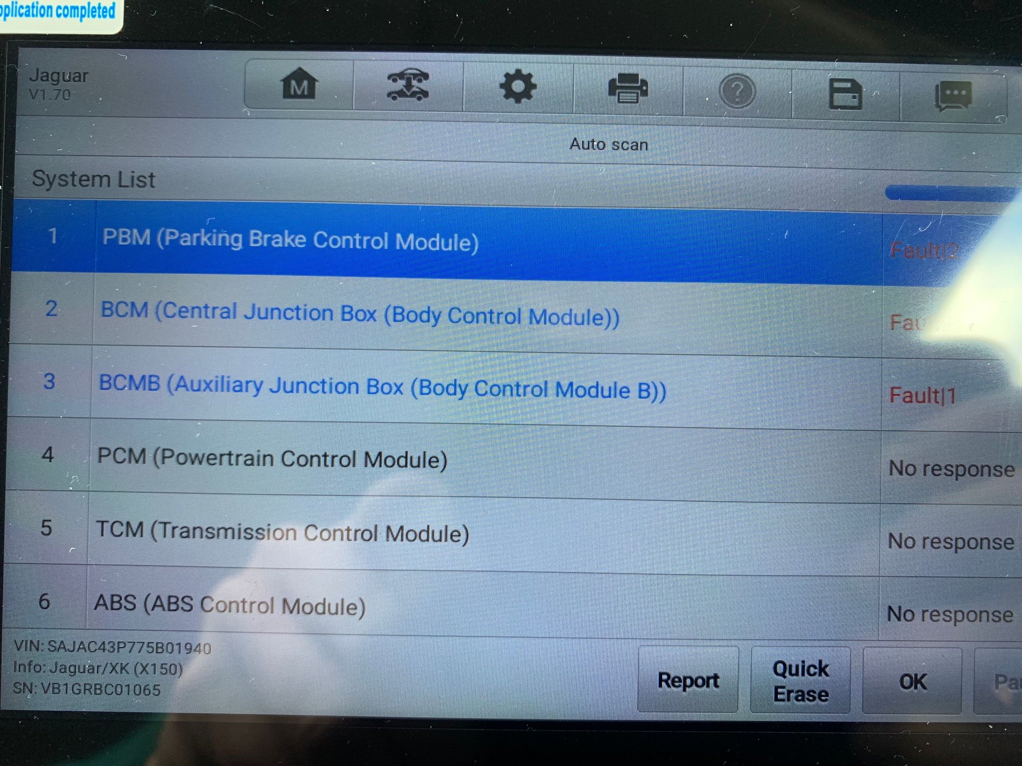

on Friday my car failed to start it just bleeps saying and flashes brakes
on the diagnose i get "communications failure Parking BRake Control Module
I just fitted a spare PB Module and it made no difference -
12.4V on my battery - using a new Yuhasa 019 and a 6 month old Durecell 019
Any ideas that work will get beer tokens!

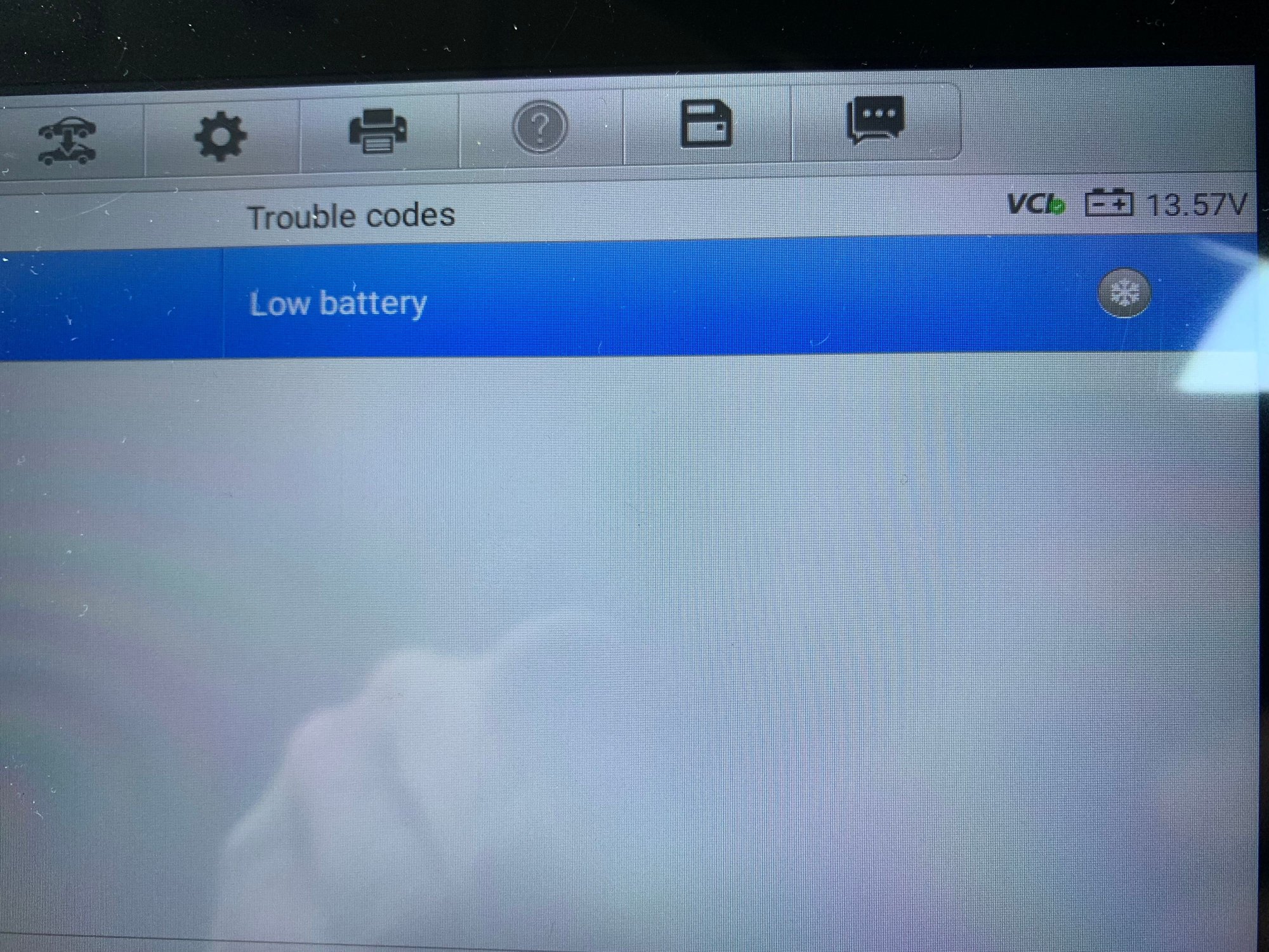

I agree I have no idea so I just jumped it from my other jag and tested it on 13.5Volts
