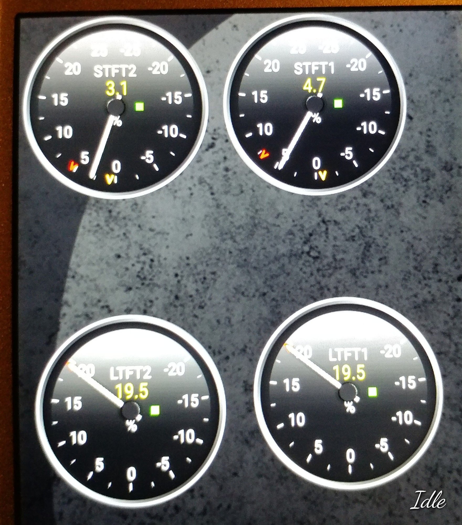

2009 Jaguar XF supercharged V8. 100k miles.
Scanned a P0171 and P0174 code on two different trips. the engine is running lean, so i did some research to see how to go about fixing the problem.
It says monitoring the LT/ST fuel trims is a quick and highly effective way of doing it.
I have the torque hp pro apt for this. These are the readings after I did a check engine light reset and completed a 15 mile run.
8 miles of highway going 70 mph and the rest stop and go. Here, the pic shows the car at idle afterwards.

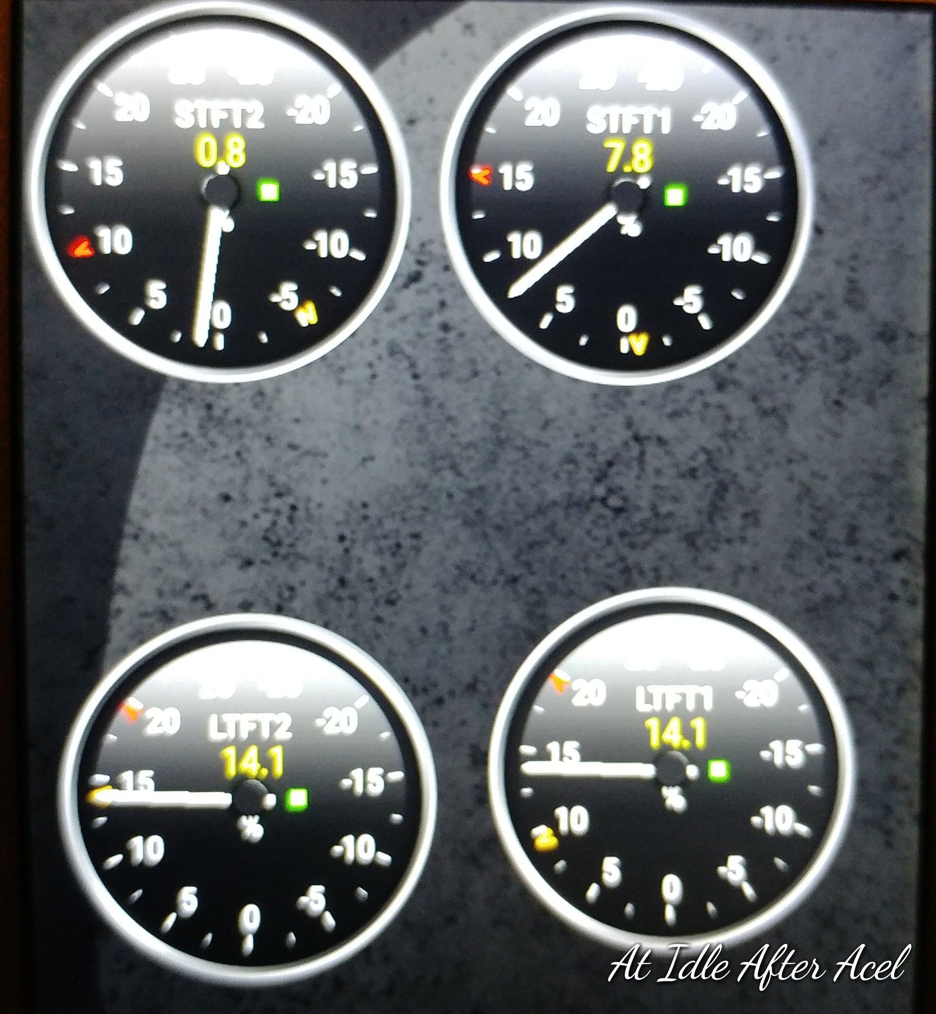

Here is the car at 2500 rpms, sitting still.

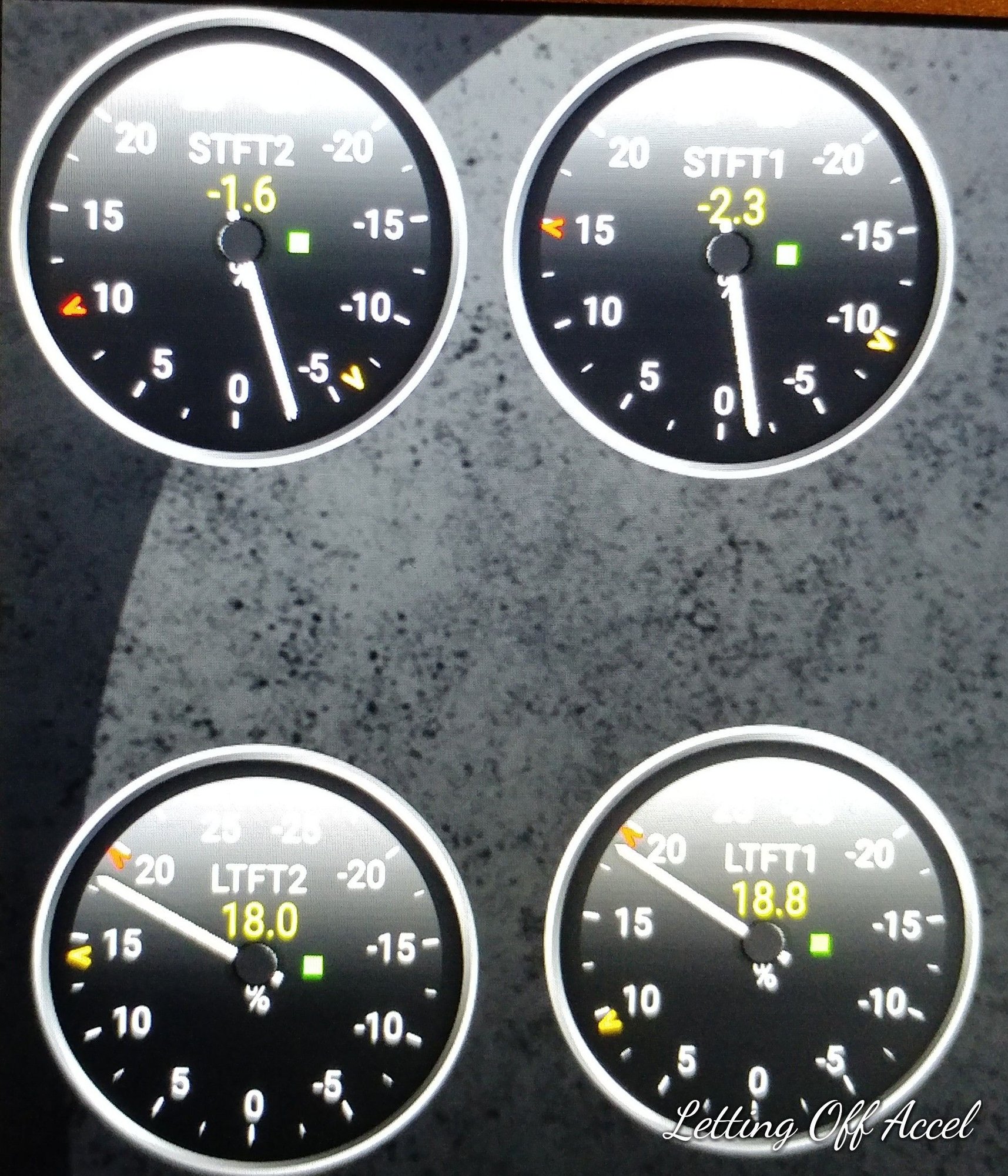

As soon as i release the gas pedal.

I would start checking for vacuum leaks...maybe EGR. Given the miles and age of your car, it could be possible that some of the rubber hoses have deteriorated to a degree they leak.

I think that you have some sort of an intake leak somewhere that is causing this situation.
