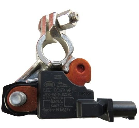

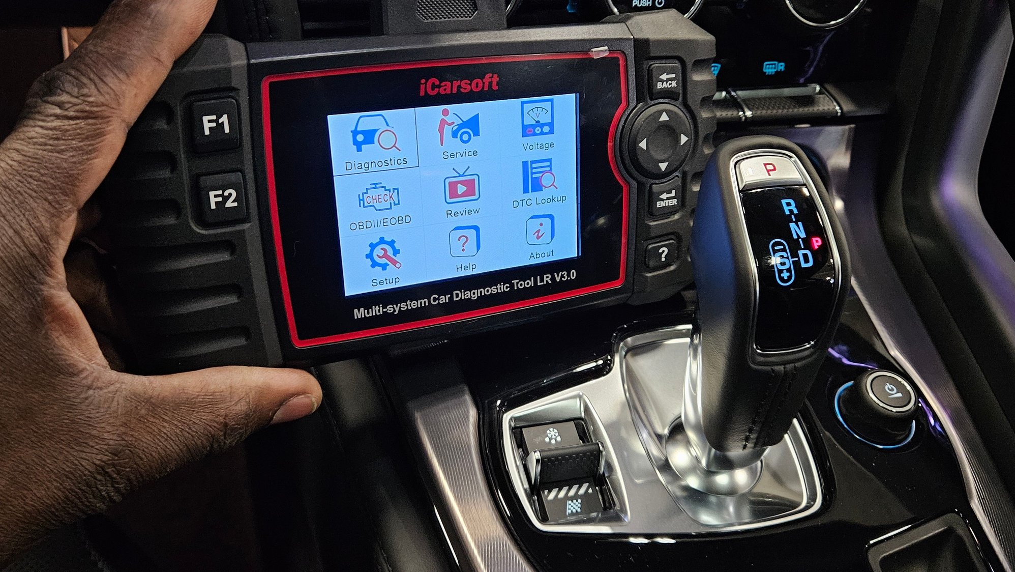

when purchasing a alternator of eBay always purchase a used oem one, don't get me wrong you can find a good new one but its very slim, so either purchase a new one from JLR ,or a used one from eBay , when it comes to accessory belts its best to get the JLR oem for correct fit, battery has to be reset with a good tool like SDD, Autel etc. ,now your BMS ALSO COULD BE BAD ,
