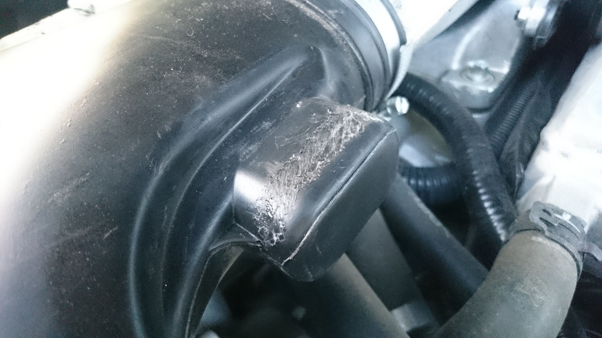

A free DIY to get more sound out of your intake is the resonator delete. Yours may not have a supercharger, but you'll still get some of the rumble from doing it. I can't seem to find the original post about it, but I'll attach some pics.
Basically, if you look at your intake tubes you'll see some of them that don't attach to anything. They're just empty chambers. If you cut them off, you can cut the very ends of them off as well and then use a soldering iron to "plastic weld" them back together. I got a lot more of the engine sound I wanted once I did that.
I actually cut them down even further than this later. I just don't have a pic.
You can see the other places I cut here - 4 in all.

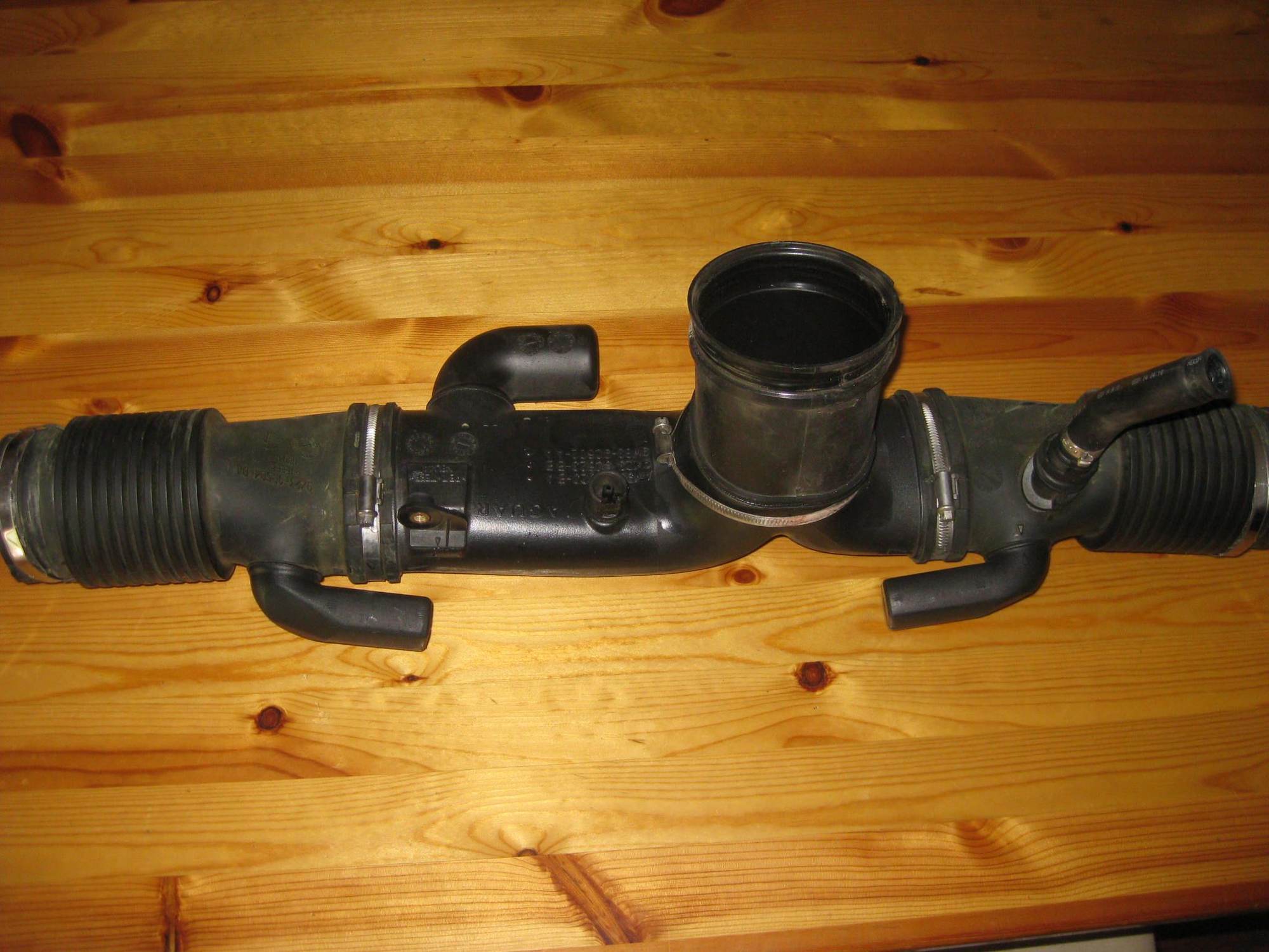

Anyway, FWIW, here's a pic of my stock XFR (5.0 SC) intake, showing the three resonators which can be "cut & shut":

Those look like you can take the resonators out entirely. If they're threaded, maybe you would be able to just buy a standard cap of some sort?
Old Jan 7, 2016 | 10:04 PM
OzXFR's Avatar
Posts: 9,030
Likes: 3,664
I don't think they are threaded, I tried twisting one and it didn't budge. I stopped short of giving it the full beans for fear of snapping it. I suspect they are glued in. It shouldn't be hard to cut them off with a hacksaw then seal up the holes.

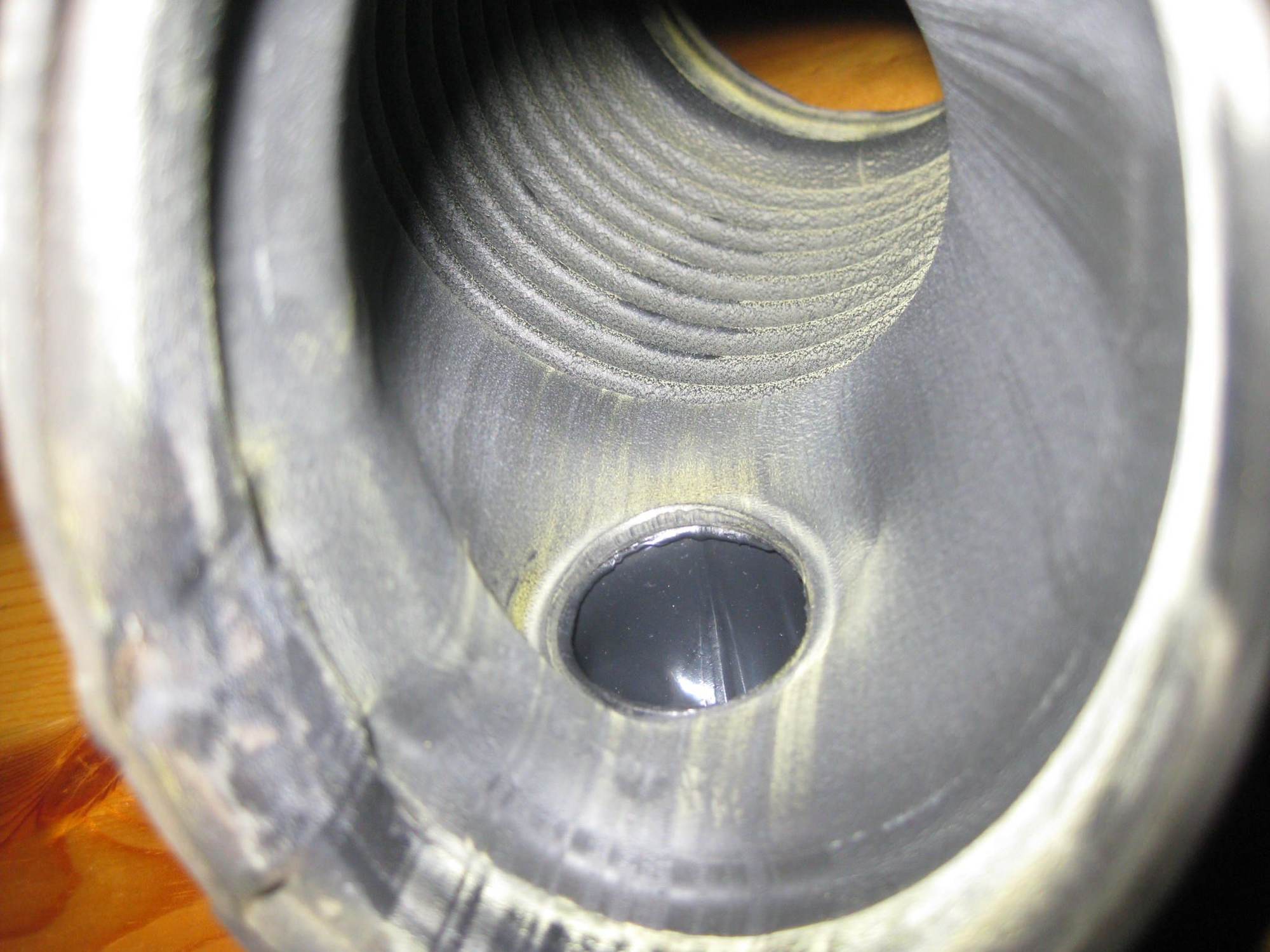

OK, I took the shorter end piece off the stock intake, and looking inside it's obvious that the resonators are glued in and not screwed in, here's a pic:
I checked the other two by shining a torch in and they look the same.
So I suppose it is possible to plug them from the inside, once you take the end pieces off to get better access. You'd just have to get or make the exact right size plugs and some way of gluing them in.
Also, you would need a roughly 1" hose clamp to re-attach the tube on the RHS (see the tube sticking up on the RHS of the earlier pic), as the stock clamp is press fitted and the only way to remove it is to cut it off thereby destroying it.
