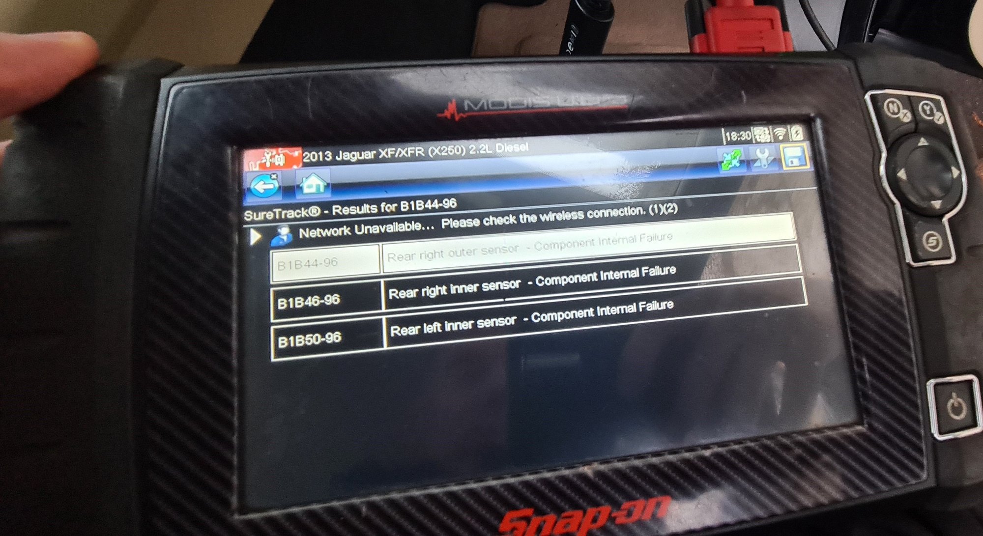

Hi all recently bought a 2012 2.2d 190hp Azurite blue with cream leather XF absolutley love the car to pieces, but when in reverse I get a loud beep and "Camera not available contact dealer" so I used my neighours OBD tool and it give me 3 codes for sensors, I thought it was odd that 3 would go all at once. so did some digging and the common failure cheapest option (60 quid) is the trunk/boot cable which I did today and no joy sadly. (spare cable available now)
What I think has happened and please correct me if I'm wrong, but I had a dead number plate bulb and when trying to replace it, I noticed the lens covers were glued/sealed in.
Once I got them open (I never re-sealed them) the camera seemed to only work when dry weather.
When wet it seemed to show that error on the screen intermittently but now it's not been working for the last couple of months at all, it flicks on with the parking sensors for a couple of seconds on cold start-up and you can see the camera working fine then back to that error again.
Any help at all would be much appreciated guys,I want to remove the camera and try this

Parking sensor codes.

Hi Smally, did you have 3 sensor codes too? I'm thinking that's too much of a coincidence tbh, maybe one sensor, possibly 2, but 3 within such a short time. That's why I'm thinking it's something else. Thanks anyway.
