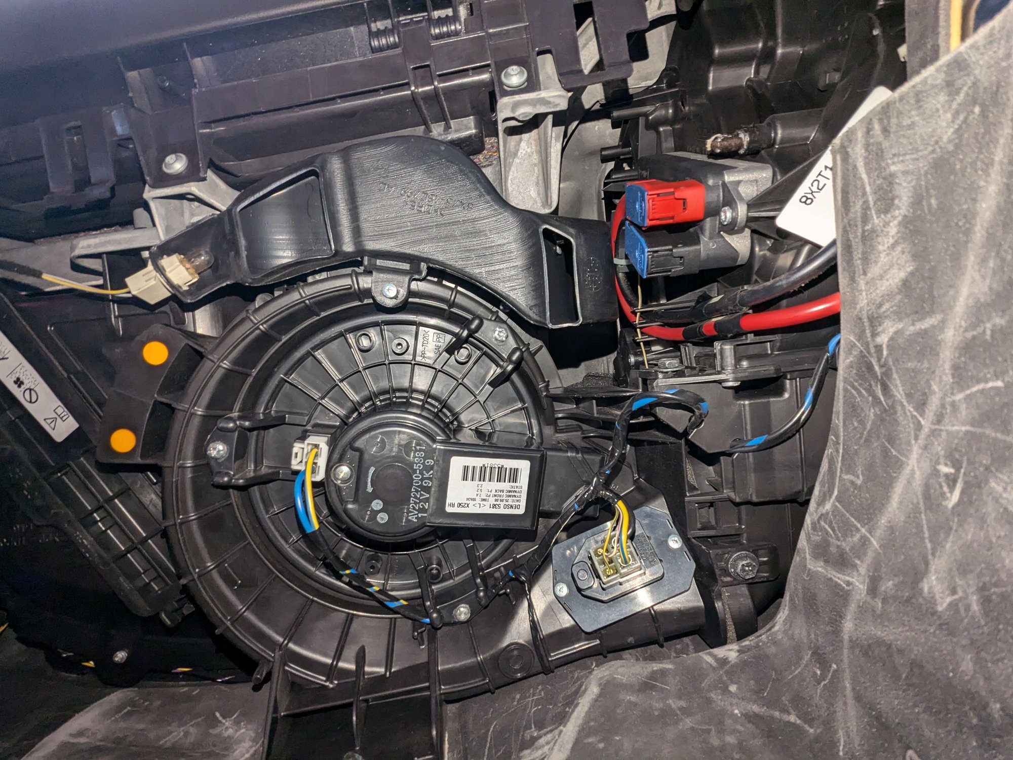

Hi John, is this the fan you're referring to, underneath the glovebox area? (with the white label marked 'Denso'). If so, what's the easiest way to see if it's working? By removing it and leaving it plugged in as the engine is running?

Turn it on and unplug it, then if it's not check voltage on the plug, but you said the air was blowing
Could you be more specific? Turn on the car, remove the blower fan to see if it's working? It has air coming out of the two vents, albeit warm when it should be cold.
