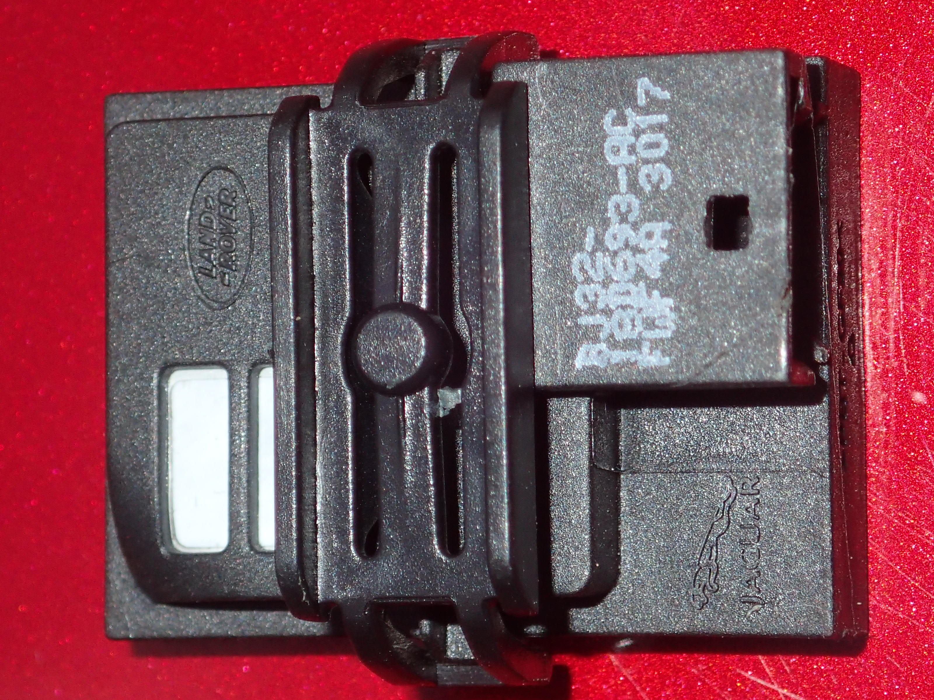

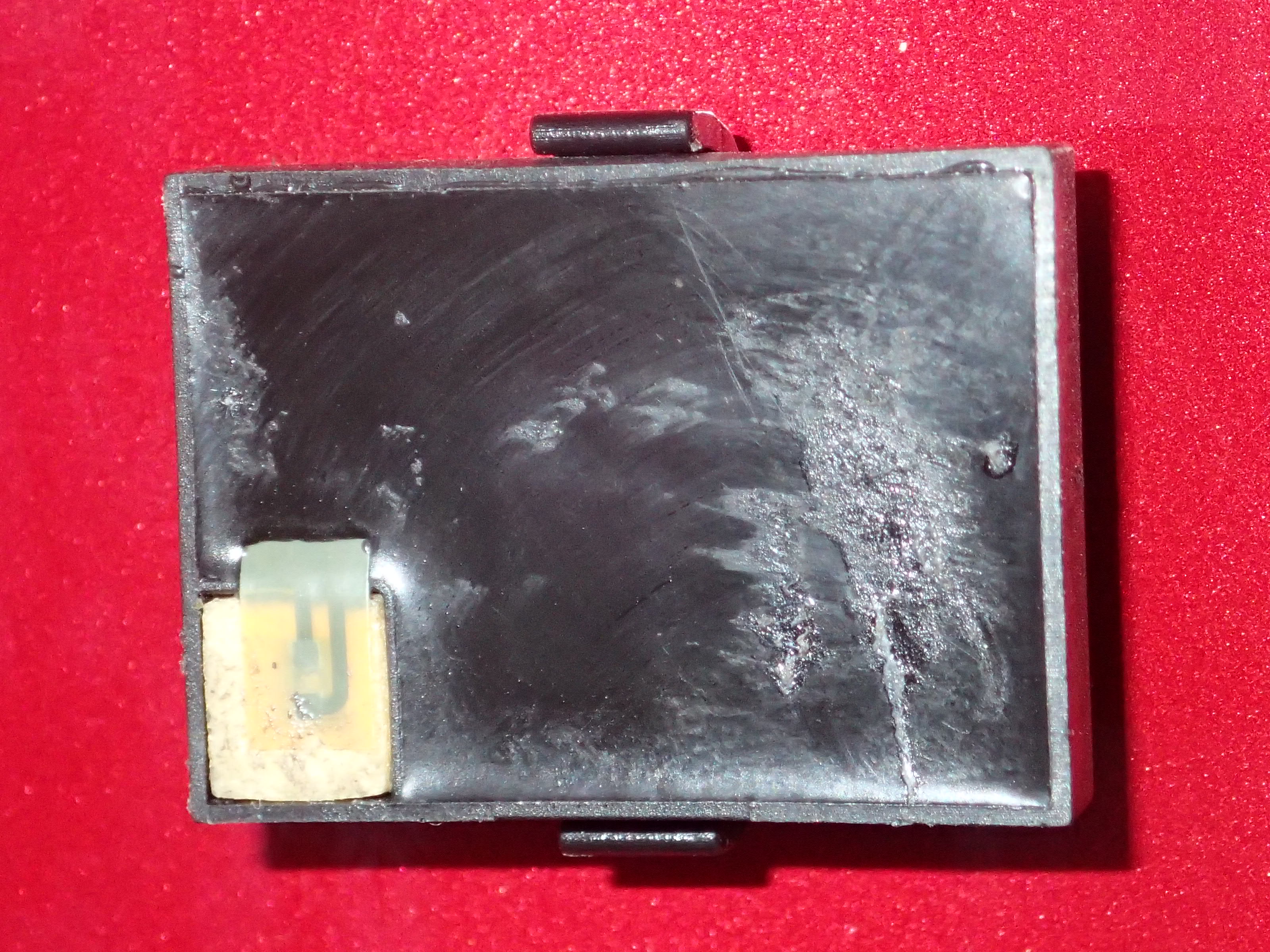

This is off of a 2013 XF Sport with high beam sensors. Can anyone confirm that this is the rain sensor unit? It appears that it should be mounted to the right hand side of the main unit. I have already purchased the small vented cover for it but cannot mount it. Evidently the windshield was replaced without having a mounting attachment for it so if anyone knows where it might be possible to buy one of these mounts I would be greatly appreciative.

The rain sensor is centered and located under the plastic housing. It is the sensor to the left of the white E-ZPass transponder in the picture below. It's an optical sensor and looks very different than the sensor you show. The sensor in your picture looks like it is the one that should go up by the headliner. In my picture it has a black plastic case over it, to the right of the mirror mount. I don't know for sure what it is... maybe humidity sensor for the climate control?

Thanks for the help Black Cat! I agree with you as it appears to be listed as a humidity sensor in most of the vague parts diagrams that I can find. It is mounted in the same location as yours is. I was confused since it only seems to appear on Portfolio or high end units. I did manage to source a bracket mount for it and am in the process of gluing it on today. Hopefully it will be fine with the unit simply being compressed against the glass with the mechanical bracket and will not require a fresh silicone seal like the rain sensor. The sensor appears to have some sort of light sensor in it as well.
