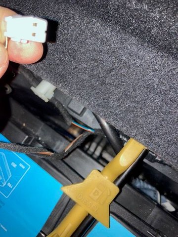

Question
I changed my battery for a agm 95 ah and every thing went well
I only discovered hidden behind de right side af the accu a black wire with a white socket hanging there and coming from de thick kabel
A brown /white and black kabel leading to the female socket
What is its use?
Old Dec 23, 2020 | 11:05 AM
BritCars's Avatar
Joined: May 2012
Posts: 2,558
Likes: 503
From: Boston, MA USA
I believe that's used by the dealer when the car is new and not used after that. So you can just ignore it!
