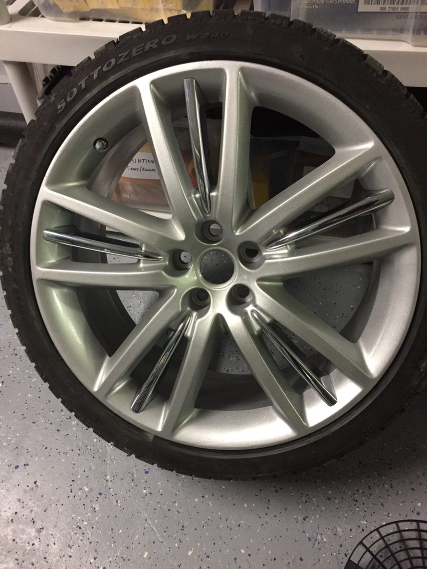

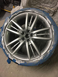

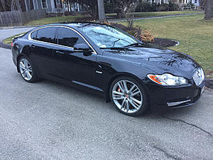

It seems as far as I could find that there is no color name so you can't buy an off the shelf paint. Two options - either get them color matched at an auto spray paint shop - but hard to get the finish to match as well as the color. Or respray them a color of your choice.
I used the dupli color EHWP10107 Silver High Performance Wheel Paint. And the matching clear coat wheel paint
Sanded and resprayed all four and v pleased with the results. Wasn't too hard
Been 3 winters now and they have held up well
Note the chrome plastic bits in each spoke come off and a bit of silver polish cleans them up really well. Buy spare spring clips to hold them on (2 per spoke) as they bend when you remove them
Old Apr 20, 2019 | 07:35 PM
BritCars's Avatar
Joined: May 2012
Posts: 2,558
Likes: 503
From: Boston, MA USA
Photos during and after
Attached Thumbnails Respraying my Selena rims-photo640.jpg   Respraying my Selena rims-photo360.jpg   Respraying my Selena rims-photo175.jpg   Respraying my Selena rims-photo866.jpg   Respraying my Selena rims-photo394.jpg
