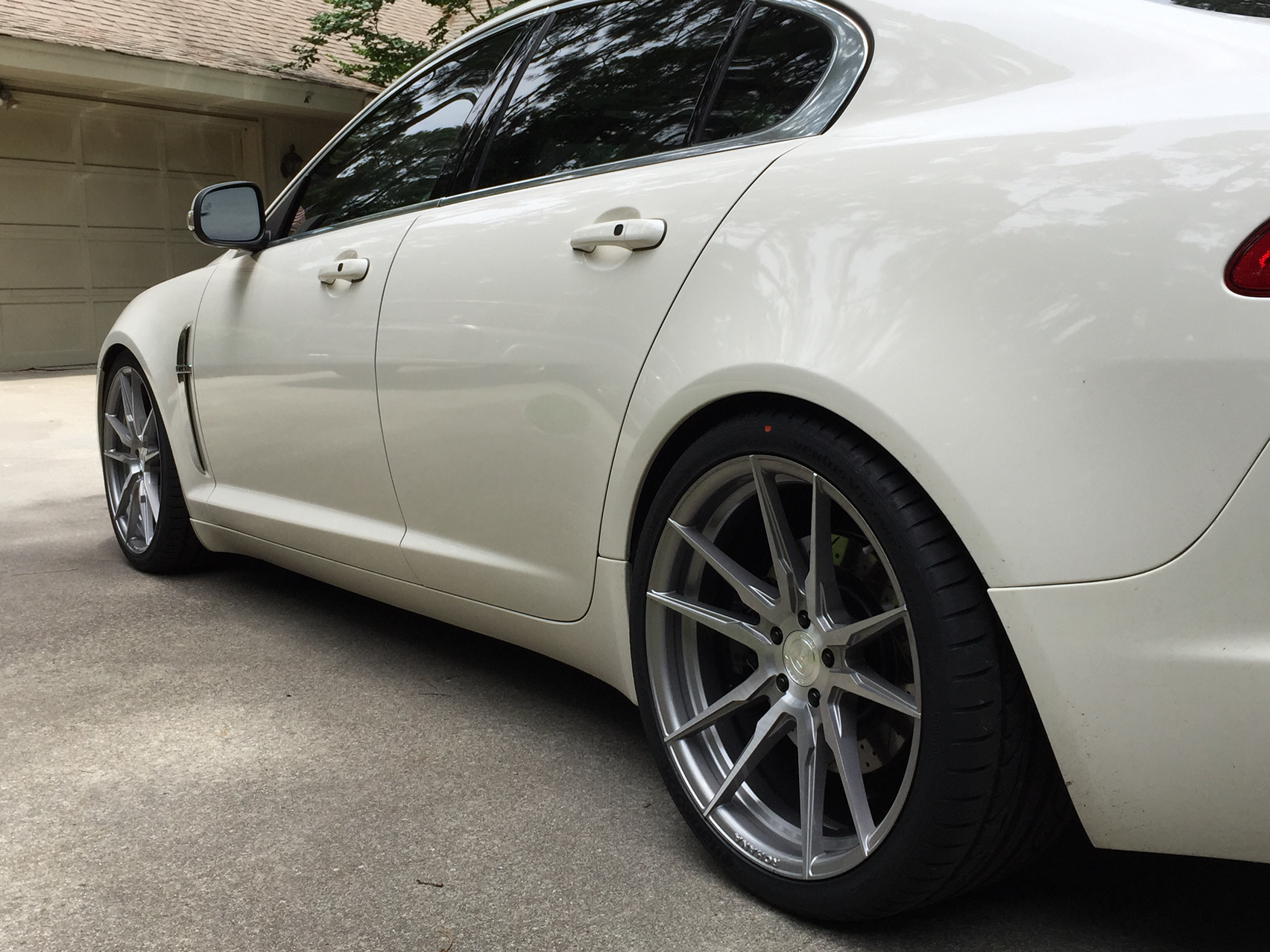

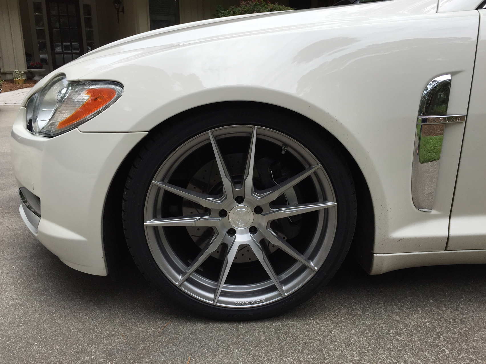

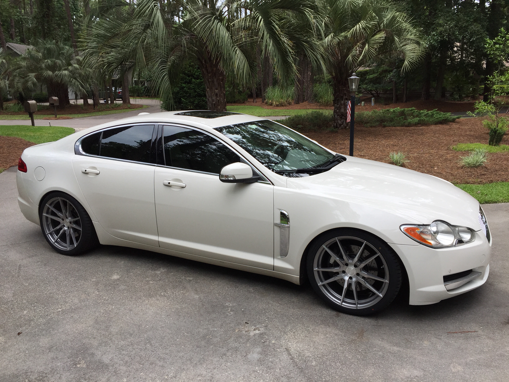

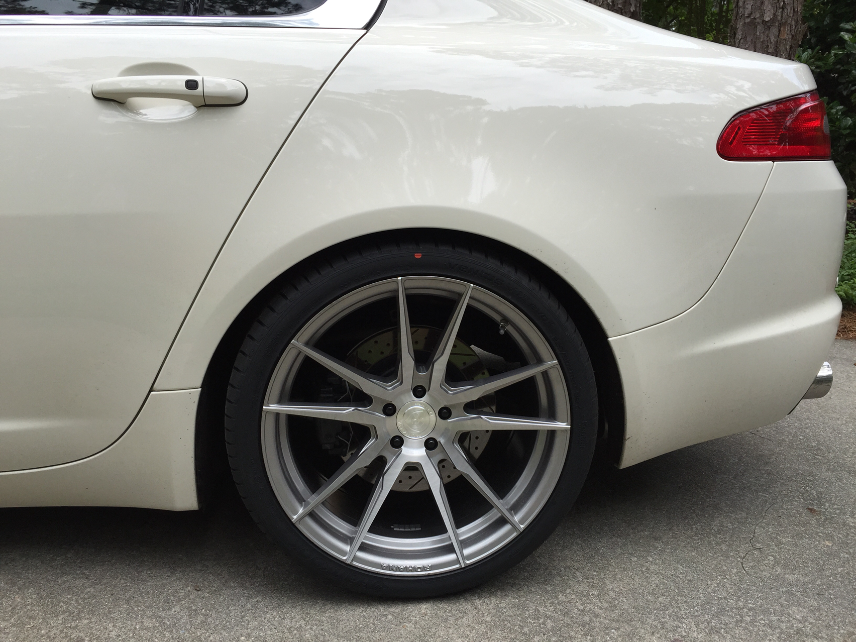

They don't make a super flush offset. I have Rohanna's which are the closest I have seen so far. 20x9 40F and 20x10 42R. Im gonna be adding spacers to the front and rear. To drop the offset to 32F and 38R. Here is pics of my car without the added spacers.

That looks really good. Same color as mine
