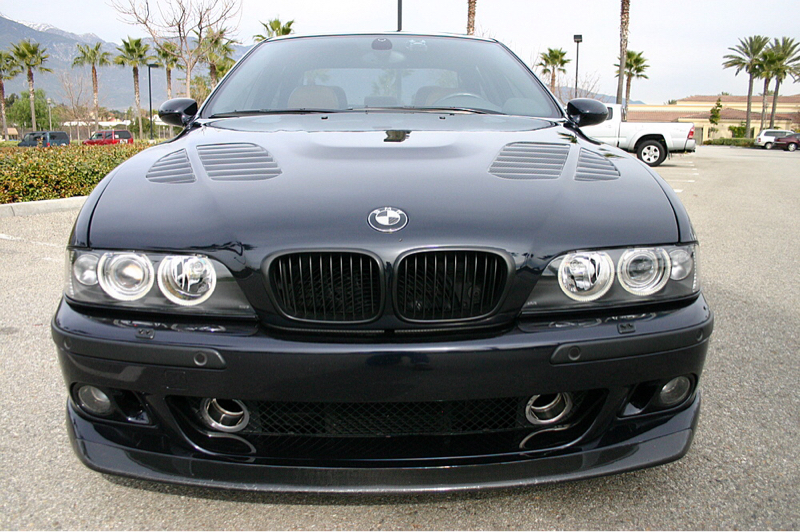

The BMW guys are using sink drains or light fixtures in there lower grill. Then routing a hose to the air box. That way the have stock and additional air being forced. I have looked at doing this and writing a thread. But you have to cut a 3inch hole under the airbox. I'm very tempted.
