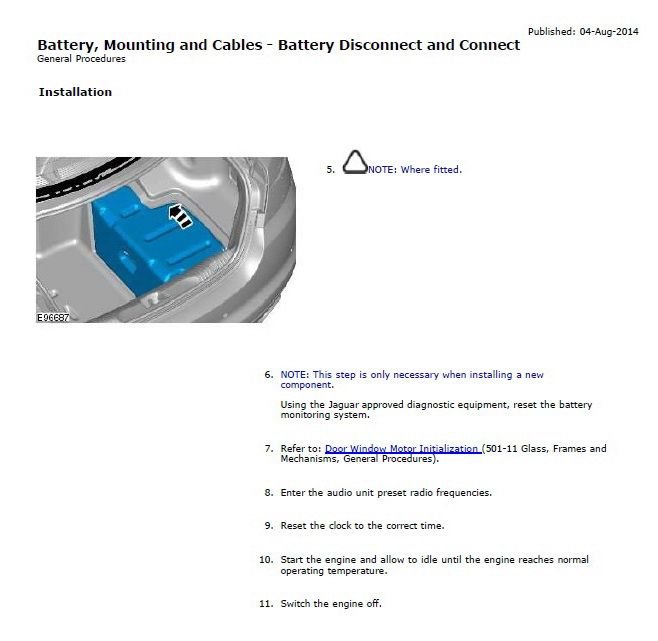

Old May 18, 2022 | 07:50 AM
Chris,
There's no consistency in the Jaguar battery disconnect/reconnect procedures. Accelerator pedal position had to be re-learned on XK8/XKR but not on the later XK/XKR. Fuel trims re-learn just through normal driving on most models but are reset by letting the engine idle for a specified period on my XK. The X250 procedure suggests it's similar.
I've checked the Workshop Manual for the 2010 X250 to see what applies to your vehicle. Here's the relevant extract:
Yours is around the time BMS was introduced so may or may not have this fitted. Most of us don't worry about re-calibrating BMS with SDD as it does it by itself over a short period of time.
