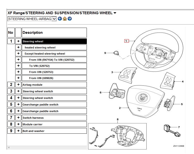

The Parts Catalogue lists four Steering Wheel changes with VIN for the XF range. Below this are heated/non heated options and all the different trim colours.
The XK range has a similarly lengthy list of Steering Wheels.
That being said, they will most likely all physically fit any vehicle in the two model ranges.
I've measured the rim on my XK8 to give you an idea of whether XK is any thicker than XF. The rim itself is shaped like a letter O with dimensions 30mm x 35mm.
If this is thicker than the XF and you decide to go ahead with one of the examples you have found, great care must be taken when removing and refitting the Airbag to avoid accidental deployment.
