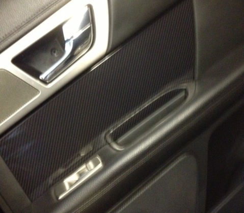

I've been trying t find a realistic vinyl wrap to give my interior an updated look.
I've tried the textured black that see to be the only option but it just looks too plastic. I want that deep gloss factory look
Finally I found a new wrap, VVIVID gloss carbon vinyl wrap. Sounded good so I ordered it.
To begin with, it came in damaged, the box had been bent. But it looked promising. So I cut a piece and wrapped my door trim. (I have ordered new black door panels so I tried the removed wood veneer from one of those.) it looked terrible and wouldn't really curve and wrap around back. So I sent the seller a message with my disappointment.
He responded that he would take care of the damage. And then gave me a little helpful hint. "Did you remove the clear plastic film from the vinyl?" What?!?! Nothing mentioned about this film anywhere!! So I tried again, left the film on while I covered the flat face, then pulled it up around the edges, leaving on the face to protect until finished, then heated and pulled the vinyl around to the back. Trimmed the excess, leaving a 1/4" to secure, pulled off remaining film and WOW!! This looks sooo real!!
Now, it's a bit dark but is the closest thing to the factory carbon I've ever seen. The pattern is metallic under the gloss so it even shifts a bit like real carbon.
S I'll be doing the rest of the interior after I find my last door panel, the drivers side.

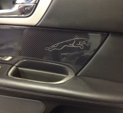

Oh, I also had a leaper I was going to use on headrest but they wouldn't stick so I used the last one on the carbon. It's cut from the same brushed black titanium I used on the center console lids and radio surround. It looks amazing. And very subtle. Only shows at the right angle. So I'll be getting enough for the other doors.

Great job! How did you place the outline of the leaper over the CF wrap?
My trim/sign shop guy made them for me from my brushed black steel wrap, for my headrests but I decided not to use them there. Sticker perfectly and reminds me of the older jaguars with inlaid leapers and such. I think I may sell them for him. He made some very small gold ones for my XJ8 a few years ago. I have some titanium that matches the interior in the XF and it would be great on the wood.
