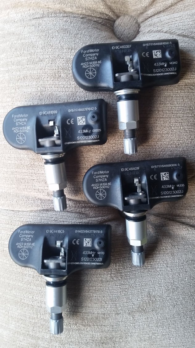

Just read through this thread. Here's my four-penny-worth:
From what I've read, almost certainly one or more of the TPMS valves need replacing.
Make sure you purchase the correct valves for your MY car. (One of the numerous numbers on the valve will have "AE" as a suffix for your car. See photo.)
ALL Jaguar TPMS systems self-learn and will pick up a new valve (if it's the correct one). Don't let a tyre fitter try and tell you that they need to a) activate the valve, or b) program it to the car. Neither is needed!
