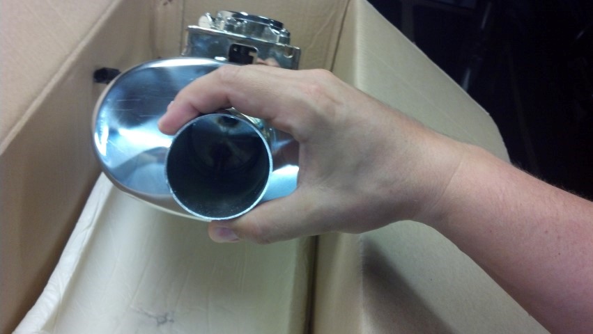

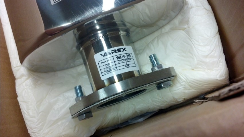

Here are a few photos of the exhaust parts and the final install. I'll try to get some good video up tomorrow of the sound inside and outside the car.
Attached Thumbnails Varex active exhaust install-img_20130611_053705_523.jpg   Varex active exhaust install-img_20130611_053717_782.jpg   Varex active exhaust install-img_20130611_053730_143.jpg   Varex active exhaust install-img_20130611_053813_367.jpg   Varex active exhaust install-img_20130620_080941_136.jpg
Varex active exhaust install-img_20130620_080953_708.jpg   Varex active exhaust install-img_20130620_081010_000.jpg
