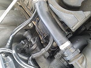

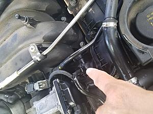

Default overflow flow hose
My car was leaking coolant...I noticed it dripping from the overflow hose (see pic 1) where I point to the connection but miss the big crack that caused me to pull over finally. I replaced the hose but it is still slowly leaking from the hook up spot(pic 2). Do I need to use a new O ring? any kind of sealant? can this be coming out due to too much pressure caused by my water pump not working correct/leaking?
2012 XF 5.0 portfolio
Thanks in advance

I would just replace that hard plastic line. It's prone to breaking anyway, and should be replaced with all the other plastic in the cooling system pipes. You will have many more leaks coming if you just replace one piece at a time, but some people like to do it the hard way.
QUOTE=coispup;1915645]My car was leaking coolant...I noticed it dripping from the overflow hose (see pic 1) where I point to the connection but miss the big crack that caused me to pull over finally. I replaced the hose but it is still slowly leaking from the hook up spot(pic 2). Do I need to use a new O ring? any kind of sealant? can this be coming out due to too much pressure caused by my water pump not working correct/leaking?
Thanks in advance[/QUOTE]

Default Thanks
Thanks for the reply lotus. Sorry for another question but you are obv the guru here. What hard plastic are you referring to? I swapped out the whole 3 way overflow hose which is hard plastic but do you mean the piece that the overflow hose snaps into? Is the female part worn and mishaped now perhaps letting coolant leak out? It just doesn't snap in clean.
I am talking about the think hard plastic pipes that come from the coolant header tank. That plastic becomes brittle with the heat in the engine bay and can very easily crack, especially when you are working on the car and moving those pieces.
