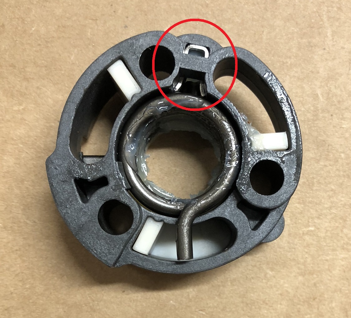

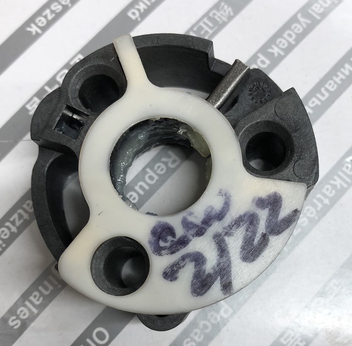

I got to see the new snout over the weekend when I dropped the smaller pulley off so that it can be swapped over before I take the car in. As suspected it came with the older style coupler although I see that the design has been improved because the end of the spring now sits in a small metal enclosure so shouldn't wear the same as the original ones did.

this is the eaton part no#
917-022
