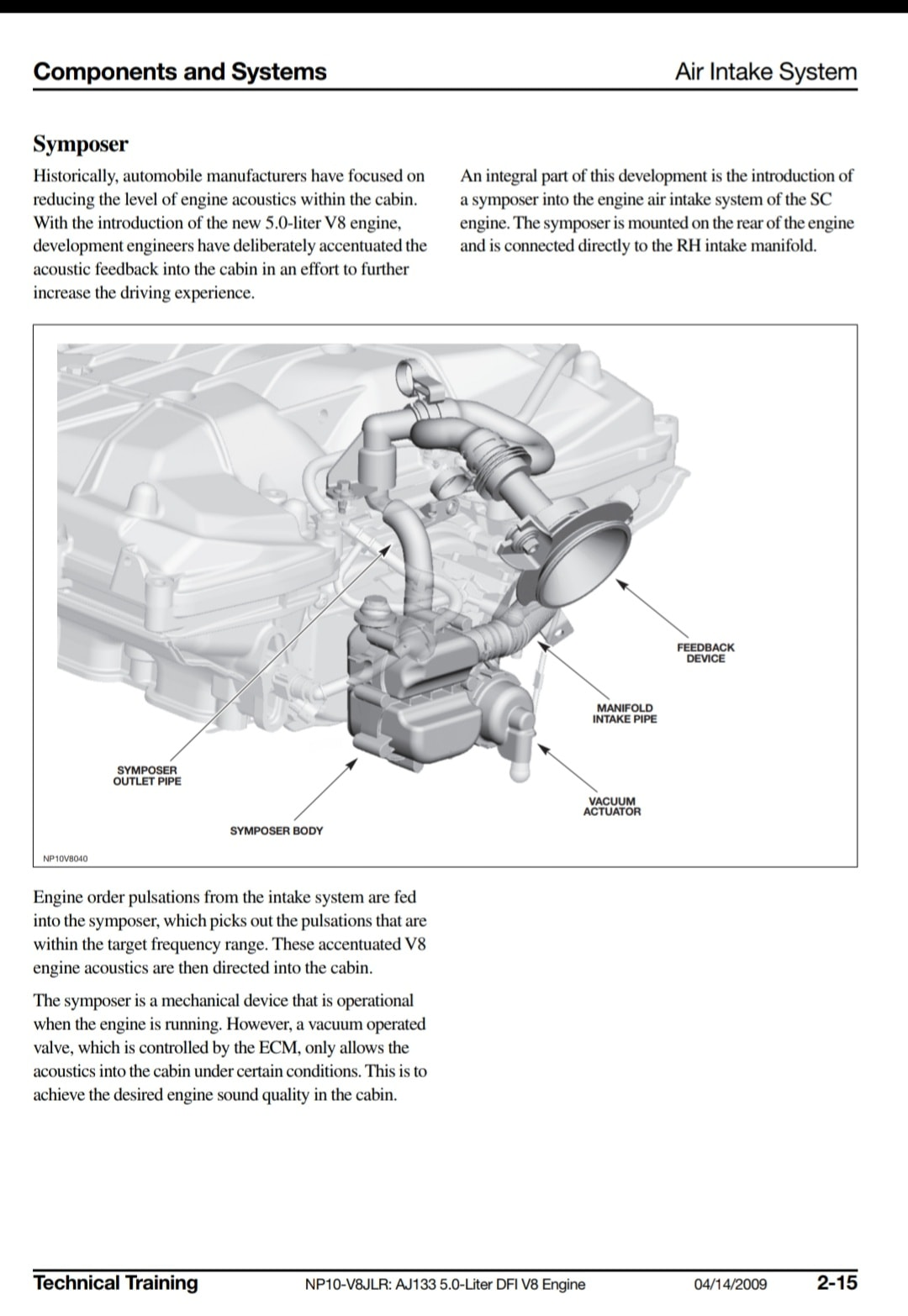

Maybe the symposer had become disconnected before and they reconnected it during the work. That part only exists to pass supercharger whine to the cabin.
